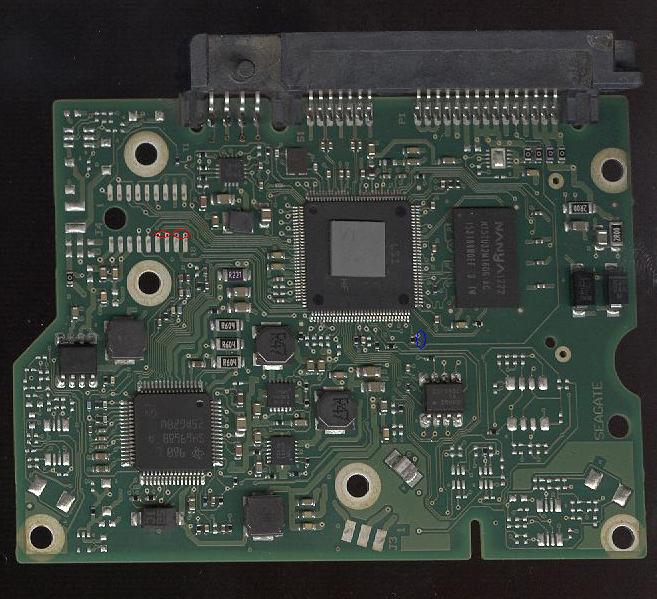

 Post subject: Segate BARRACUDA ST1000DM003 MCMT error
PostPosted: May 26th, 2014, 11:28
Joined: April 5th, 2013, 9:01
Posts: 20
Location: World
The disk is dosent reconize by the machine at all
Model:
BARRACUDA
MODEL: ST1000DM003 1Tb
PN: 9YN162-500
FW: CC48
SN: SD1D4L0NK
The terminal interface show this:
Boot 0x40M
Spin Up
TCC-0021[0x000065B4][0x00006A20][0x00006E8C]
Trans.
Rst 0x40M
MC Internal LPC Process
Spin Up
TCC-0021
(P) SATA Reset
MCMTFileHandler: EXCEPTION: Failed MCMT read request
MCMainPOR: Start:
Check MCMT Version: Current
MCMainPOR: Non-Init Case
MCMainPOR: EXCEPTION: MCMT PRI copy corrupt
MCMainPOR: EXCEPTION: MCMT SEC copy corrupt
MCMainPOR: MCTStateFlags 0000002E  MCStateFlags 000000C1
MCMainPOR: EXCEPTION: POR Failed General
MCMainPOR: Feature Disabled...
PowerState = IDLE1
APM disabled by SPort
Help please.

In this post with a similar problem the solution was shorting the read chanel
viewtopic.php?f=1&t=27513&p=197760#p197760
I not shure what to short

here is one picture of the pbc that I google it
where are the test points?

PostPosted: May 26th, 2014, 17:24
Posts: 17332
Tip: How to identify the Read Channel test points:
http://malthus.zapto.org/viewtopic.php?f=24&t=123&p=149

Yes I read but im not shure if i find the rigth tespoints .
when i short apears servo errors and the disk not spining

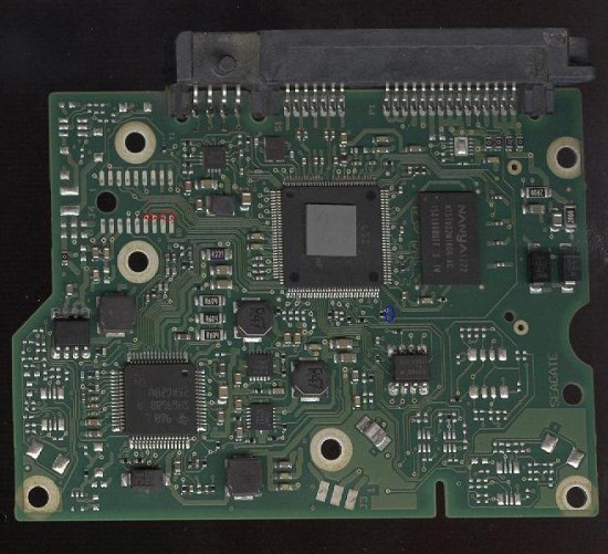

Here a pictures of the pbc with a better resolution I mark in red where I think are the test points
Are they correct??

Posts: 17332
You need to measure the voltages at each if those 4 pins with the board off the drive. That will distinguish the read and write pairs.

The disk without short have terminal access to all comands
but the ATA interface not reconize at all
Then I can't aply the seagate firmware patch
Via terminal there a way to patch firmware?
