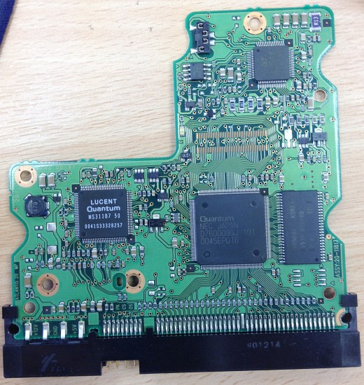

I have an old HDD as above which has died. No smoke or fireworks, it just stopped responding completely. The PCB shows no signs of damage but I found a donor drive and swapped the board over. The old drive now spins up with no nasty noises but is not recognised. I'm not sure if there's a ROM chip on this model or not.

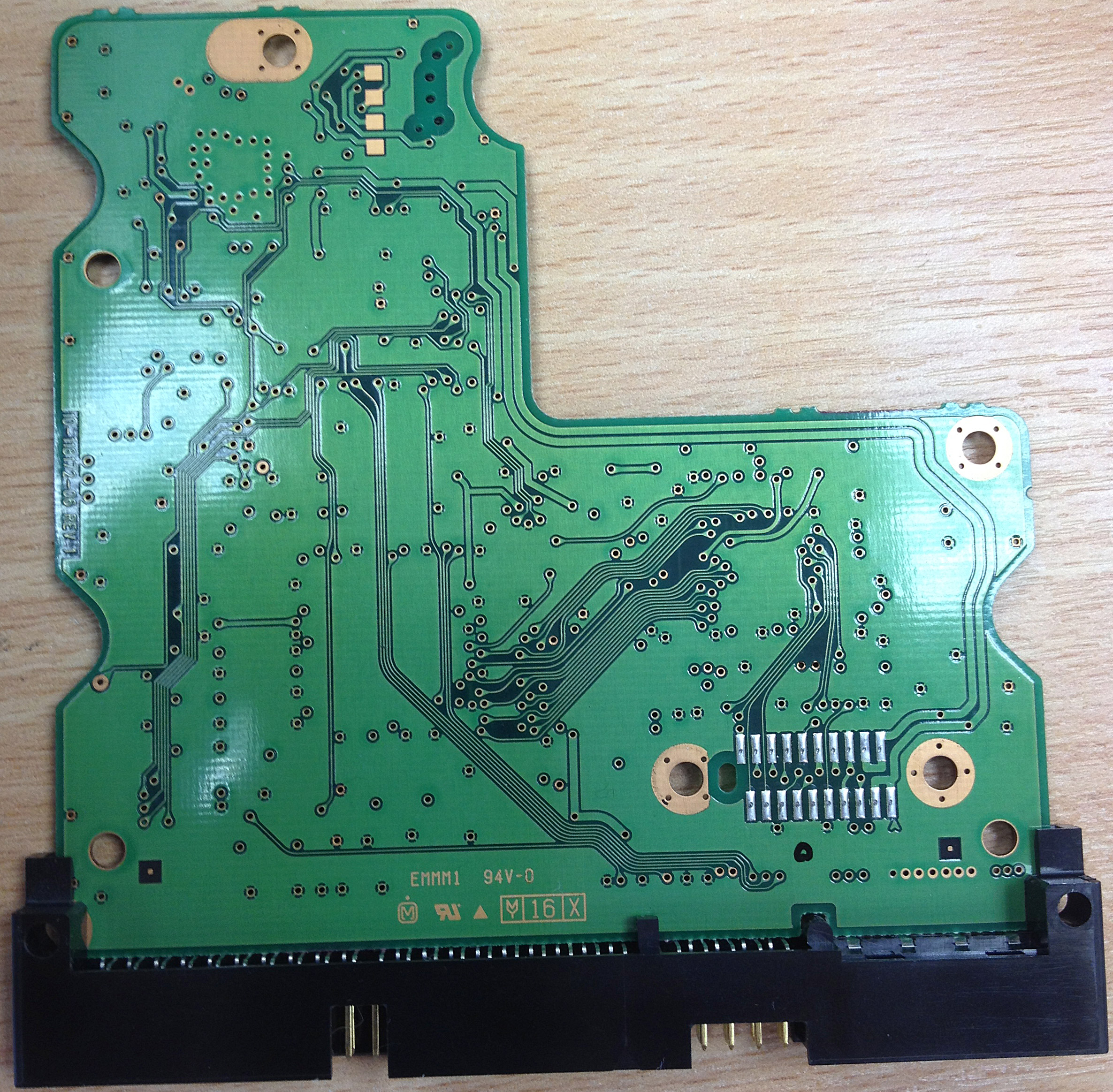

maybe post some pics of both boards. also there might be a simple fix to the dead one. Some troubleshooting could be done if you post a picture of the dead one, though of course this is no garauntee.

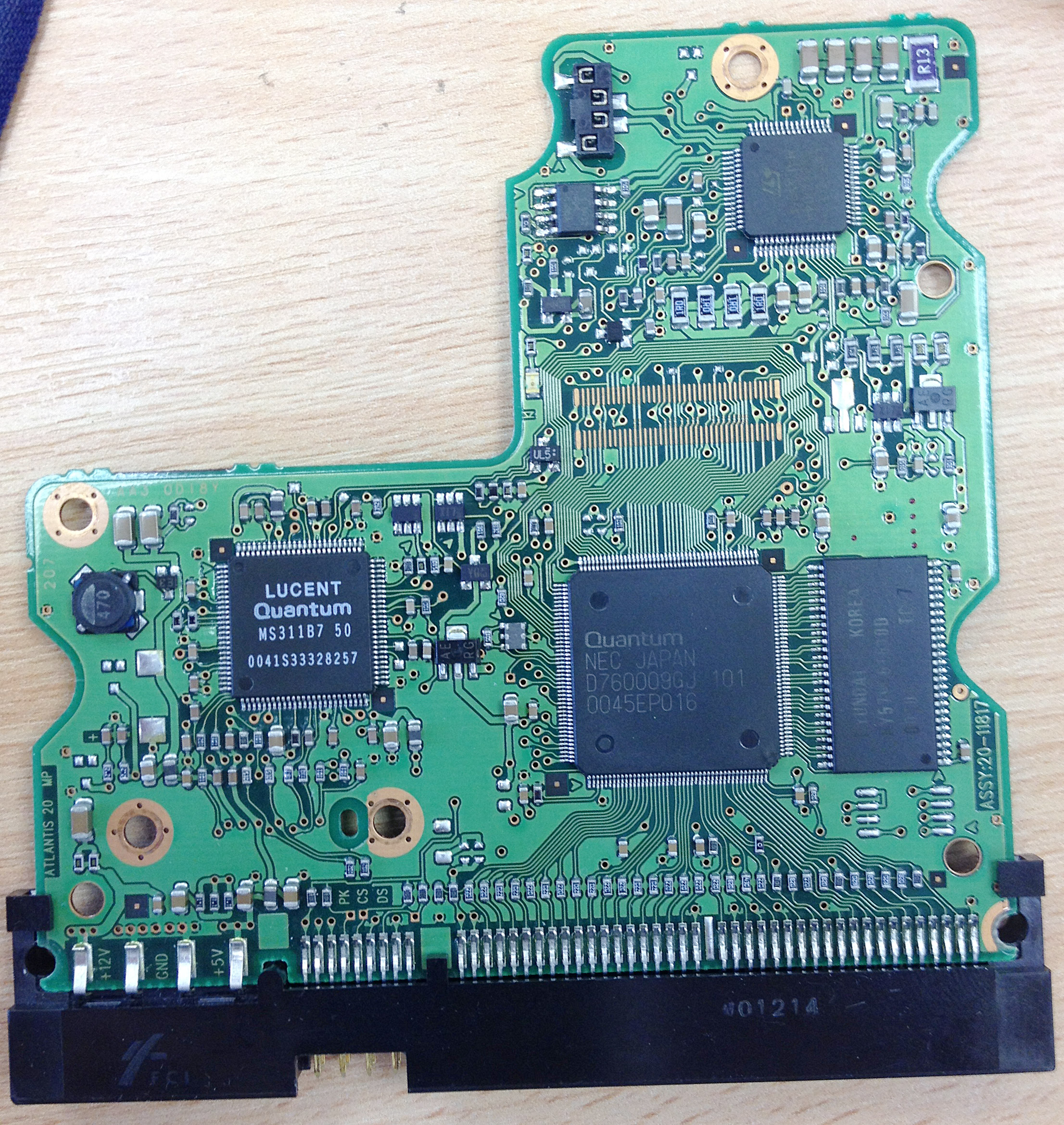

Thanks very much for the replies.
The FW code is the same on both drives (AASY 1310).

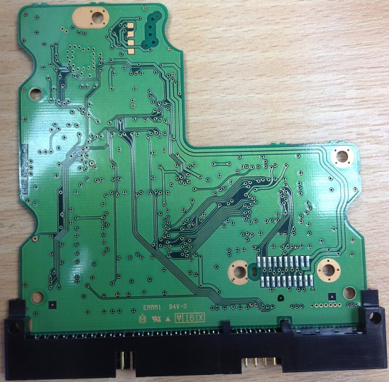

I would lean towards fixing the dead PCB too but cannot see any burning so don't know where to start. Pictures of the bad board attached.
Any input much appreciated.

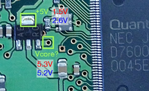

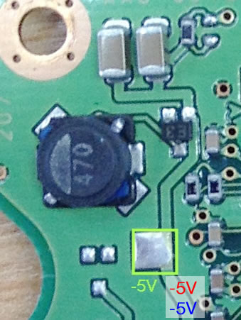

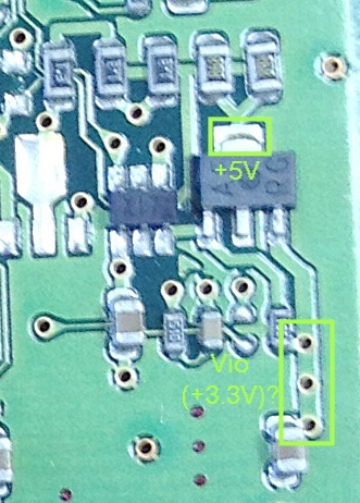

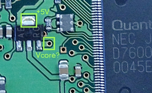

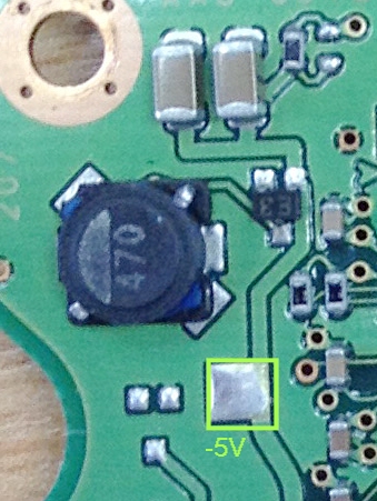

Can you measure the following voltages?

Spildit wrote:
Check the markings/letters on that cute 8 leg chip to confirm if it's a soic 8 flash spi rom.
It's a dual MOSFET.
FDS6961A, Fairchild, Dual N-Channel Logic Level PowerTrench MOSFET, 3.5A, 30V, Rdson = 0.090 ohm:
http://www.fairchildsemi.com/ds/FD/FDS6961A.pdf
RDS035L03, dual N-channel MOSFET, 30V, 3.5A, Rohm:
http://www.khwy.net/images/product/jing ... 035l03.pdf
http://www.ec66.com/market/sheet/RDS035L03.pdf

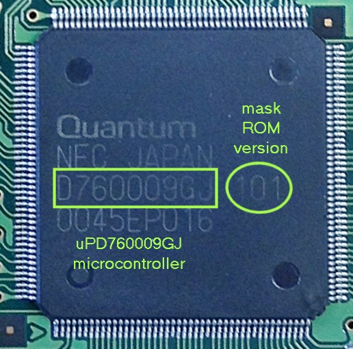

The mask ROM version of the Quantum/NEC uPD760009GJ microcontroller appears to be "101". I don't know how important it is, but does it match the version on the replacement PCB?

fzabcar - The mask ROM version on the microcontroller is 101 on both PCBs.

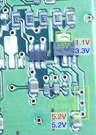

Voltages are marked in red for dead PCB and blue for the donor.
 Post subject: Re: Quantum Fireball Plus AS 60GB
PostPosted: April 28th, 2014, 15:05
Joined: May 5th, 2004, 20:06
Posts: 2782
Why not have some more fun and check out the UART
PostPosted: April 28th, 2014, 15:49
Posts: 17328
The Vcore supply is down from 2.6V to 1.5V and the Vio is down from 3.3V to 1.1V.
(I incorrectly assumed that the transistors were NPN rather than PNP, so I got the order of the inputs and outputs wrong, but the numbers are OK.)
The preamp supply (-5V) is OK.
I'll have to find my own PCB and make further measurements of my own.
I'm not sure about the ROM code. Other Quantum/NEC micros (eg uPD787012JG) have 3 ROM code digits in the same place, but I can't find a datasheet for the uPD760009GJ.
There is an error LED on the PCB, but I'm assuming yours don't flash, otherwise we would have heard from you.

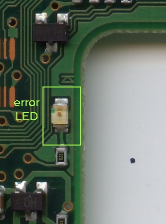

What kind of errors would signal the LED?
My firmware database:
PostPosted: April 28th, 2014, 17:16
Posts: 17328
FWIW, here are 3 threads where end users talk about these LEDs in relation to various problems with various Quantum models:
http://webcache.googleusercontent.com/s ... 40765.html
http://webcache.googleusercontent.com/s ... p?t=313886
http://webcache.googleusercontent.com/s ... om/?p=4208

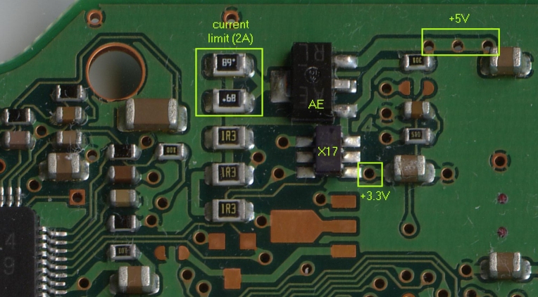

PostPosted: April 28th, 2014, 18:17
Posts: 17328

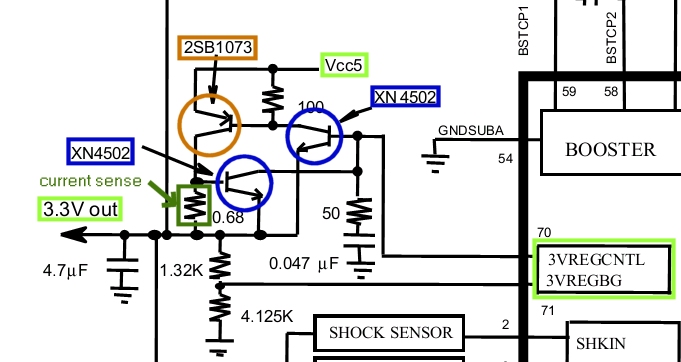

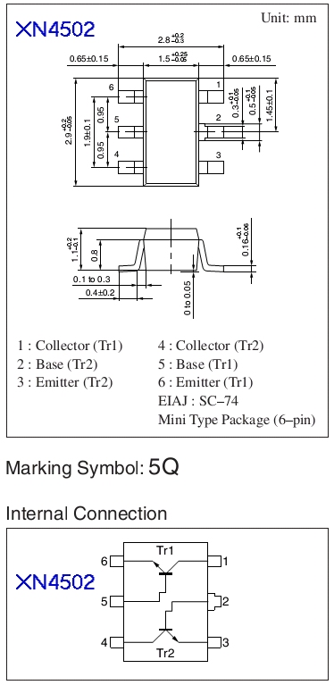

ISTM that the MCU may be faulty. It is the only IC that uses both the Vcore and Vio supplies (apart from the motor controller which controls them).
The Vio circuit looks very similar to the application circuit in the datasheet for Panasonic's AN8428GAK motor controller combo IC which was used in other Quantum models.
The AE part is similar to the 2SB1073 PNP transistor in the application circuit, while the X17 part appears to be similar in function and pinout to the XN4502 dual NPN transistor.
My next step would be to measure the voltage across the pair of 0.68 ohm current limit resistors. It might be easier to measure the voltage between the tab of AE and the 3.3V test point. If this voltage is around 0.7V, then this would imply that the Vio supply is being overloaded by something on the Vio rail.
2SB1424, Rohm, marking AE, PNP transistor, -20V, -3A, low VCE(sat):
http://www1.futureelectronics.com/doc/R ... 4T100R.pdf
XN4502, Panasonic, dual NPN transistor, 50V, 500mA:
http://datasheet.eeworld.com.cn/pdf/PAN ... XN4502.pdf
