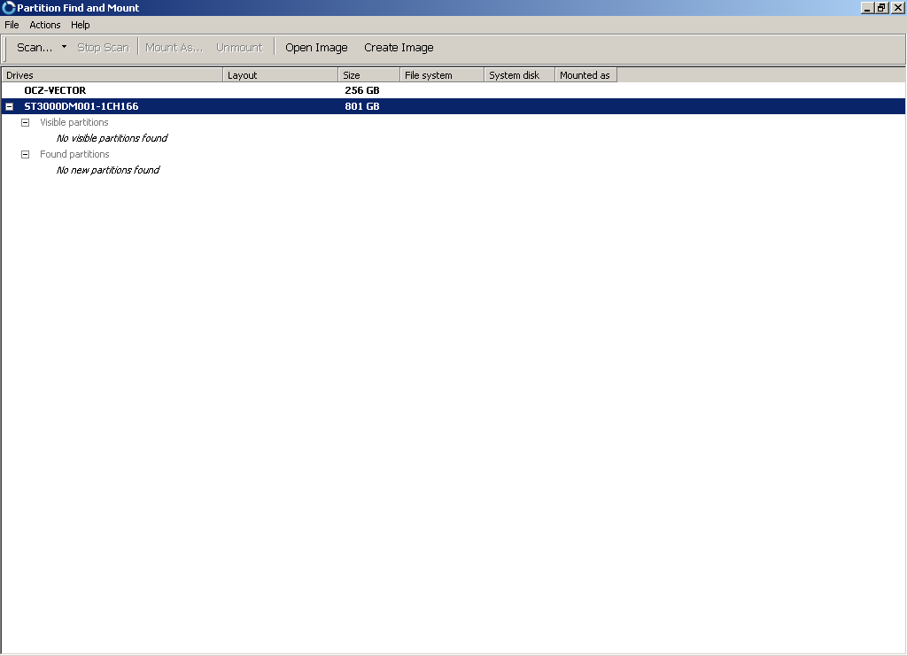

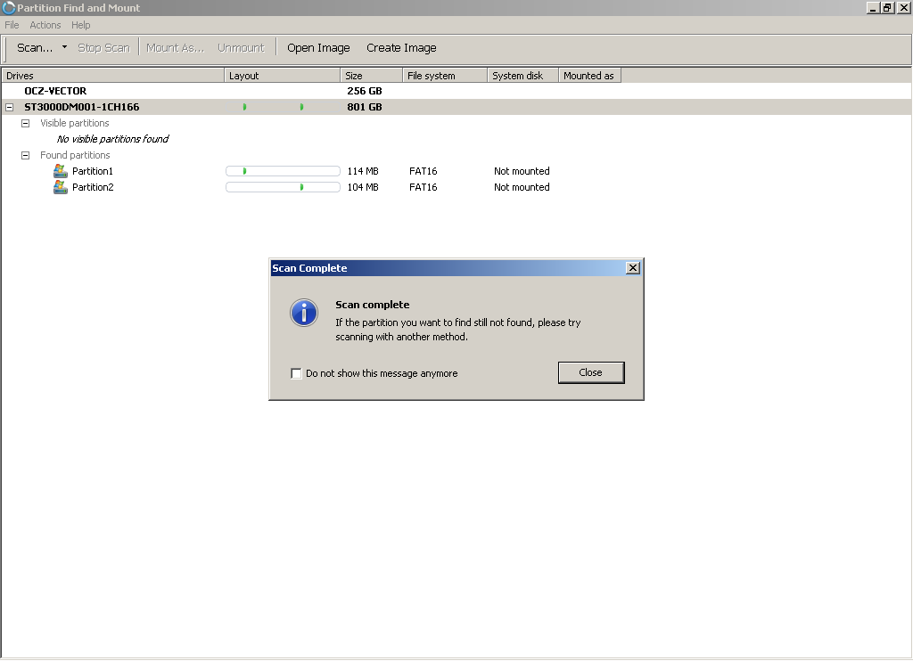

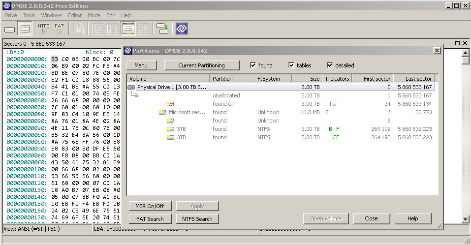

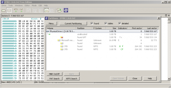

OK, so I downloaded and installed both DMDE and File & Mount. With DMDE it detected a 3TB unallocated (and a few other things that I don't understand) it also saved a text file, which is also attached.

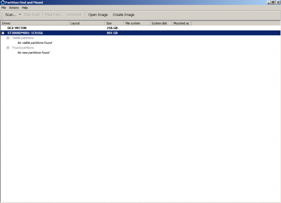

The odd thing about File & Mount is it detects the 3TB drive as a 800GB drive (and if I remembered correctly that is actually the remaining 'free' space...) but strangely enough it detected no partitions. So I am going to run a full scan and see what happens.
Any tips / suggestions in the mean time? Do you guys need to see screenshots of other things to get a clearly image?

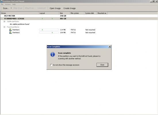

I just ran a full scan using Find & Mount which took a whopping 7 hours to complete, and this is the result:

All your data appear to be intact.
Sectors 264192 - 5860532223 appear to constitute your data partition.
The Microsoft reserved partition appears to have been trashed, but that's not important.

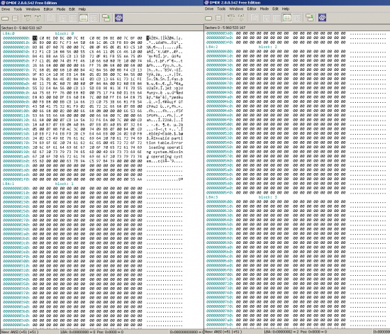

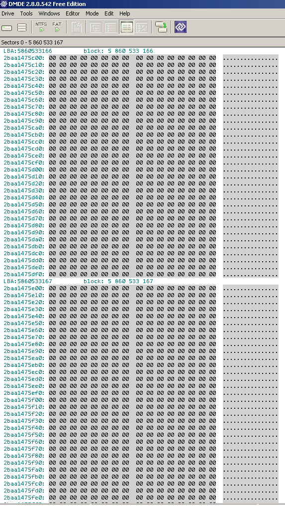

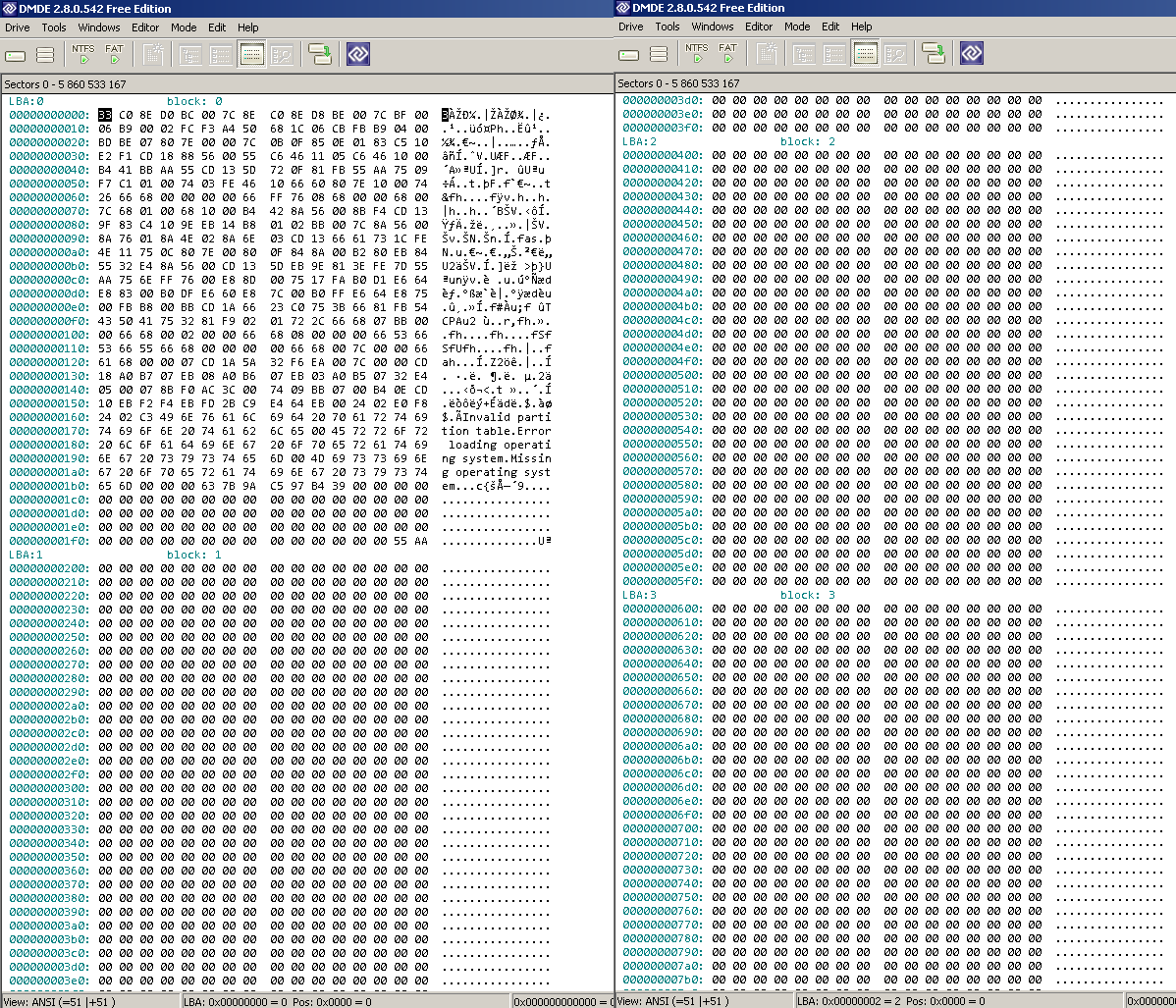

It appears that you've messed up sectors 0, 1, and 2. Could we see the contents of those sectors (in Mode -> Hexadecimal)?

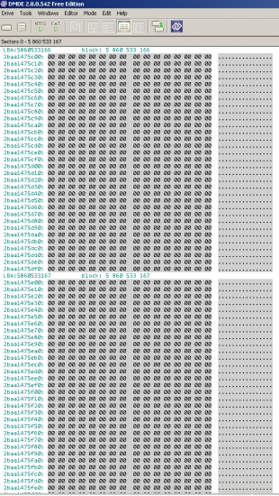

Could you also show us the contents of the last two sectors, namely 5860533167 and 5860533166?
I don't know why PF&M is having trouble, but I suspect that it may have a 32-bit LBA limitation, in which case it would be useless to us.

Here are screenshots of the things you requested:

It appears that you have "initialised" your drive, which means that all the partitioning information has been zeroed. I believe DMDE can reconstruct the GPT structure, but I haven't seen this done on live data, so I would be hesitant to try. I'm sure I could repair your problem by hand, but it would be quite tedious over the Internet.
In short, your data appear to be untouched. You should be able to see your data if you r-click the data partition and select Open Volume, or simply double-click the partition.

When DMDE displays your partitions, r-click the entry that begins at sector 264192, or simply double-click it. You should then see a window with three panes. Two panes will have your folders and files, while the third pane should show your MFT.

Good news BTW I did what you said and opened the volume, and fair enough 50% of the folders are there. It says the total size is 950GB (the root folder that has all the folders in it) but I know for a fact that it is over 2TB.
It gives me two options:
1) Reconstruct File System
2) Recover Files
When I selected Recover Files it pointed to my very small 256GB SSD hard drive to recover the files to. İ Just don't have a hard drive big enough for this option.
I have not tried option 1 yet as I am worried I might break something again. What exactly does option 1 do?
