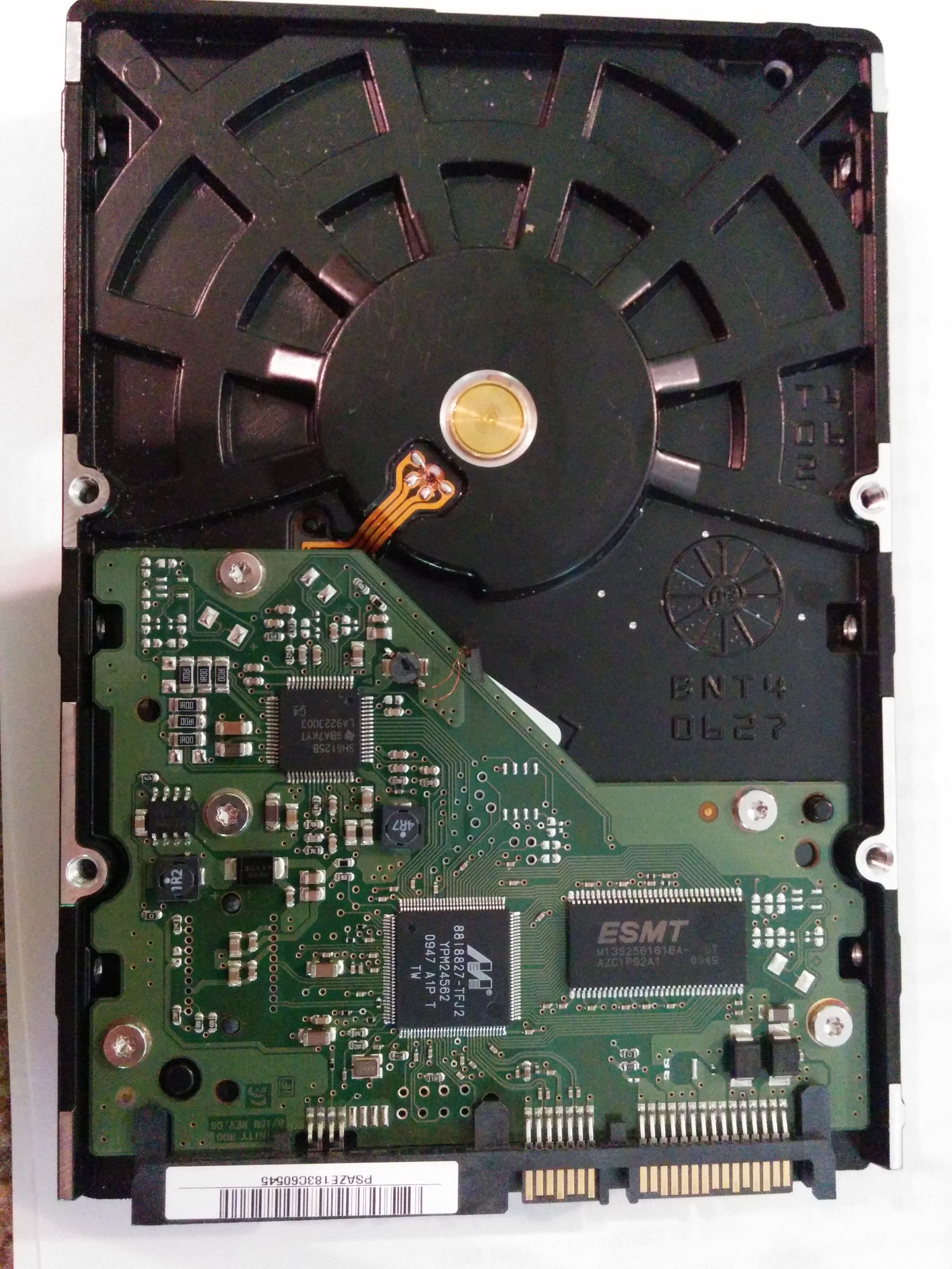

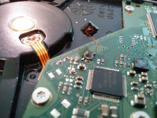

Hey everyone, I screwed up and am looking for advice.

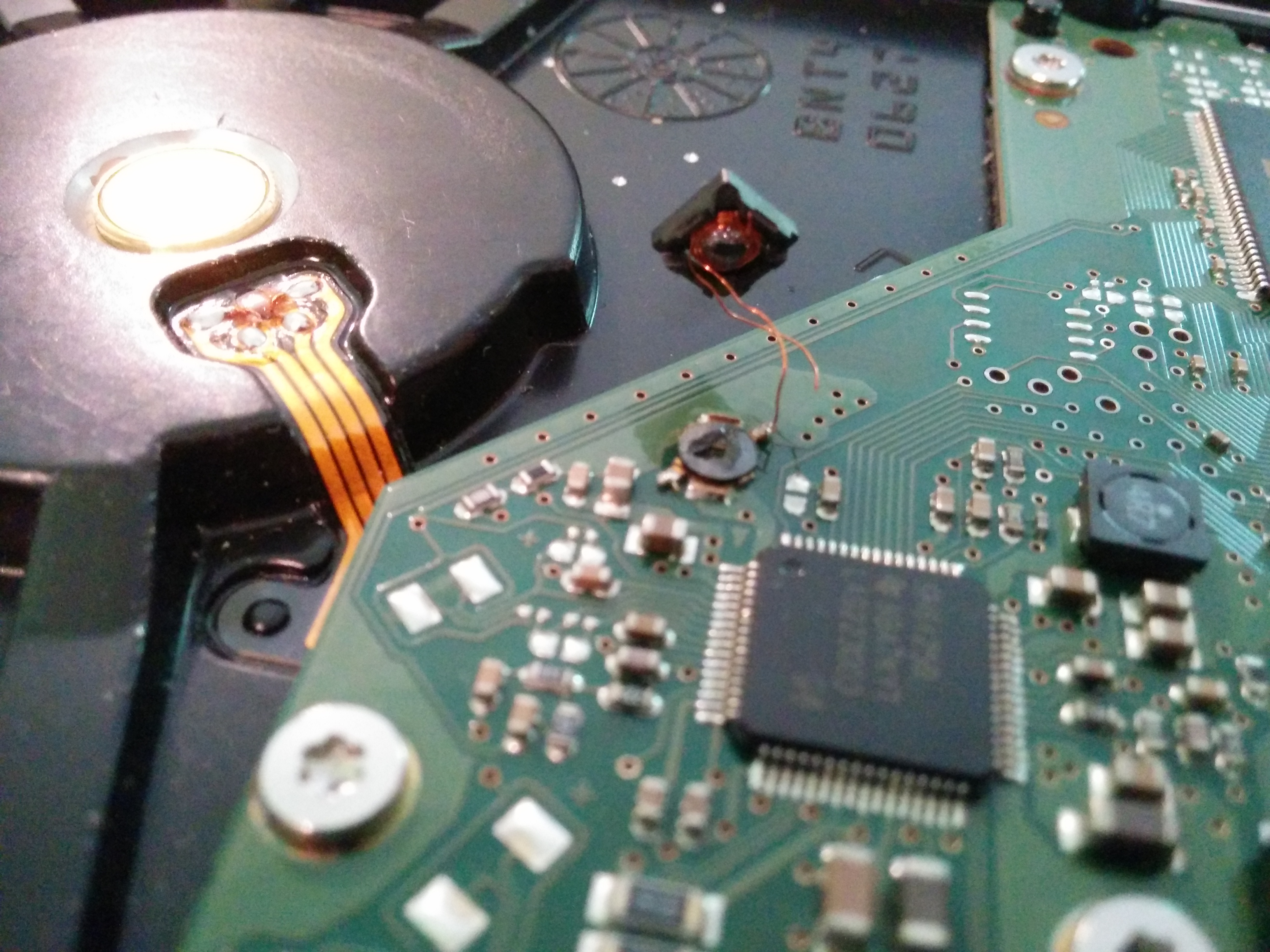

I was in a big rush to pack for my transatlantic flight, and put this internal HDD in my backpack unprotected. When I arrived home and placed it in my dock, it didn't spin up. That's when I looked at the PCB and discovered the inductor dangling there. :oops: (See the photos.) As far as I can tell it's the only damage. Would you expect such a broken inductor to prevent spinup? Any advice on how to proceed?
This HDD contains a lot of sentimental data from the past six months: RAW photos, original videos, and a few other things I don't remember. I have the JPGs, and the best videos have been uploaded to Youtube, but I am still eager to perform recovery if possible.

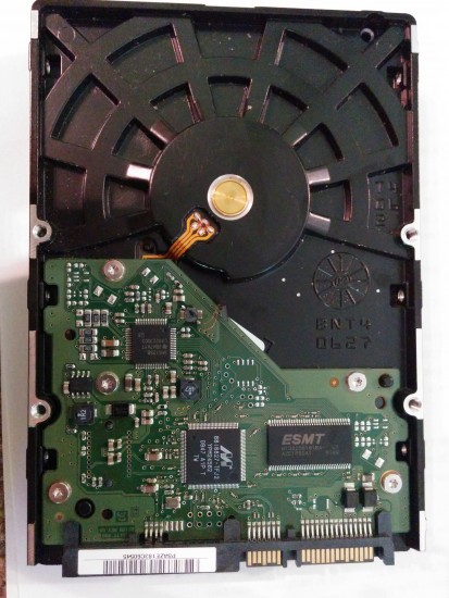

One bit of good news is that this drive is 1 of 5 which I ordered simultaneously from Newegg in Feb 2010. The other four drives are inside my NAS in RAID5. It would be annoying, but I could degrade the array to attempt a PCB replacement. But from what I can tell this procedure is somewhat controversial, since each PCB can store different calibration information for each drive. :(
The other possibility would be to attempt to resolder the dangling wire. Would this be likely to solve the problem, or is it critical that the inductor be fully intact? I assume the dangling wire attaches to the diagonal lead antipodal to the one still attached. I doubt my ability to perform this myself since the lead is so tiny and my soldering iron is normal-sized, but I know people in Europe who regularly solder things much more delicate than this. (I return on Wednesday.)
I would be very grateful for any advice! :)

Dont resolder the wire.
Couldnt you get another board and just swap the damaged component.
I would get an electronics person that solders under a microscope and is careful to do it.

Yes, thats right. I bet if you were lucky, one of us would post you one, or someone close would offer to do the job at a forum rate. I have one here, though it is a bit of a wait(FWIW it is on a Samsung 160GB, so you may not need the same actual disk drive to cannabalise from).
otherwise, I am almost certain fzabkar posted a link to a datasheet/source for an inductor... you could use that info, if they are different to yours, to track down the one you need.
I would first research inductor part numbers, then search for a datasheet for yours, then find a replacement candidate and datasheet, the compare.. finally order it and get it soldered on.
There is a book/resource called something like the SMD databook that is possibly helpful. Or go to a computer recyclers and have a look at the drives and buy one, or ebay.
Though there is the possibility that there is oher issues apart from the inductor, but this wont be known till later.

You should be able obtain an inductor for a few dollars.
Try Digikey, Farnell, Mouser, RS Components.
ELL5PS / ELL5RS-A, Panasonic, SMD Choke Coils:
http://industrial.panasonic.com/www-dat ... 000CE7.pdf

I have no knowledge about soldering small components like this, so I have no idea what's involved. (I don't even understand how the inductor leads attach to the PCB.) Will this be a routine procedure for anyone experienced with soldering under a microscope?
Your local TV/AV repair shop should be able to do this. The only thing I'd be concerned about is the size of the copper pads. Large pads tend to sink a lot of heat, so it's not something that an inexperienced solderer should attempt.

RS Components list the following Toko part as an equivalent for the Panasonic ELL5PS4R7N.
Toko D53LC series p/n A915BY-4R7M, 4.7 uH ±20%, 2.31A Idc, 31mohm:
http://www.toko.co.jp/products/pdf/inductors/d53lc.pdf
http://uk.rs-online.com/web/p/wire-woun ... s/7381208/
Cost 22p per unit, MOQ 5 pieces.
I would closely examine the dimensional data in Toko's datasheet.
