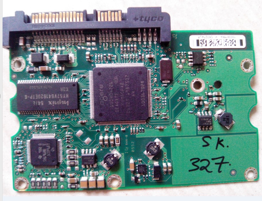

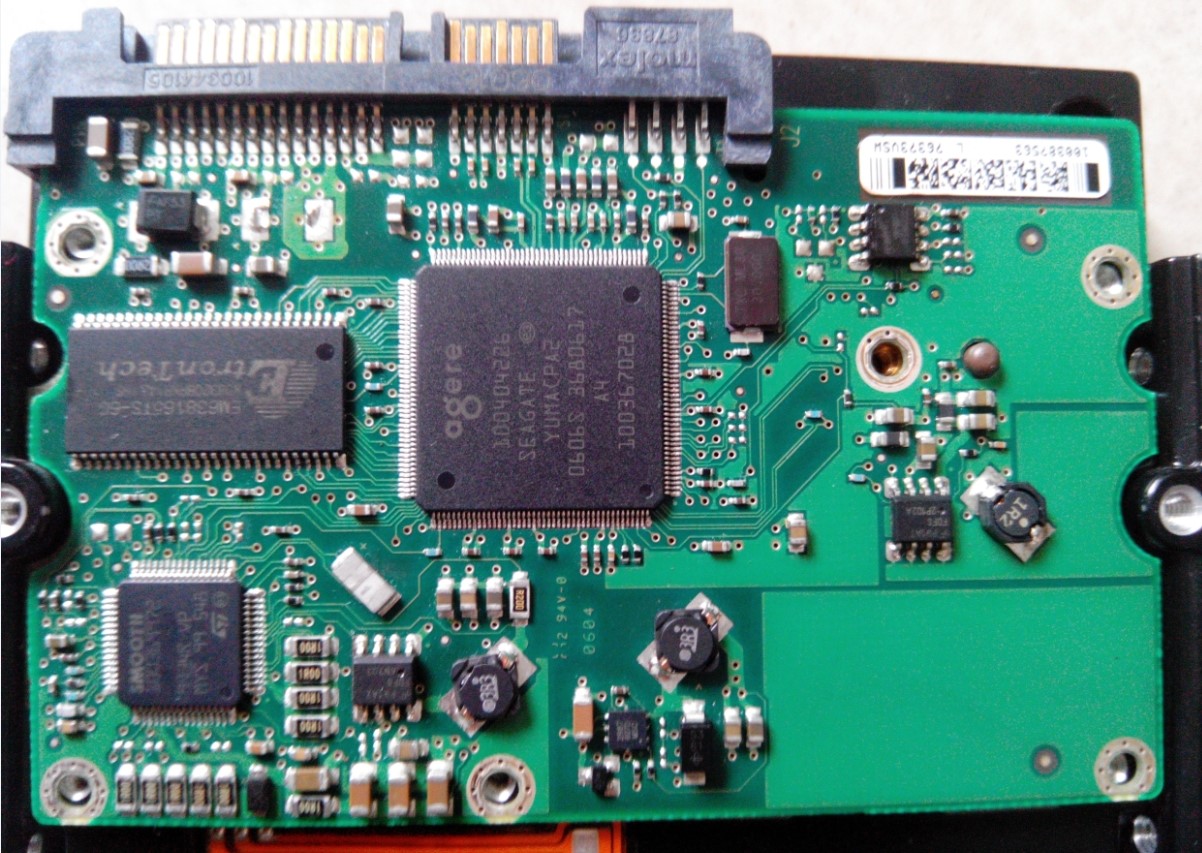

HI,
I have a drive of Seagate 320 GB HDD with Motor rotation issues.
HDD has following symptoms,
1) Checked the patient pcb by changing to working hdd without changing ROM, Donor motor is rotating fine, hence pcb is not faulty.
2) Interchanged matching Donor PCB with ROM Chip, the motor does not rotate either.
Issue arised due to power fluxuation & motherboard burnt down, motherboard of the computer has been replaced, but the hard disk has no detection & motor rotation even after pcb exchange.
Plz find the images of the donor & patient pcb & HDD.
File comment: Donor PCB 80 GB HDD
File comment: Patient PCB 320 GB HDD
File comment: Seagate 320 GB Drive

If you install either PCB on the drive, what resistance can you measure between ground and pin #1 of the "FDFS" IC to the left of the 1R2 coil? I believe this should be the test point for the negative supply to the preamp. If this resistance is low, then that could explain why the drive doesn't spin.

Im getting 9.1 OHM (Donor with its ROM) & 28.5 OHM (Patient with patient's ROM) on the FDFS IC when connected from Ground & 1st pin of IC.
