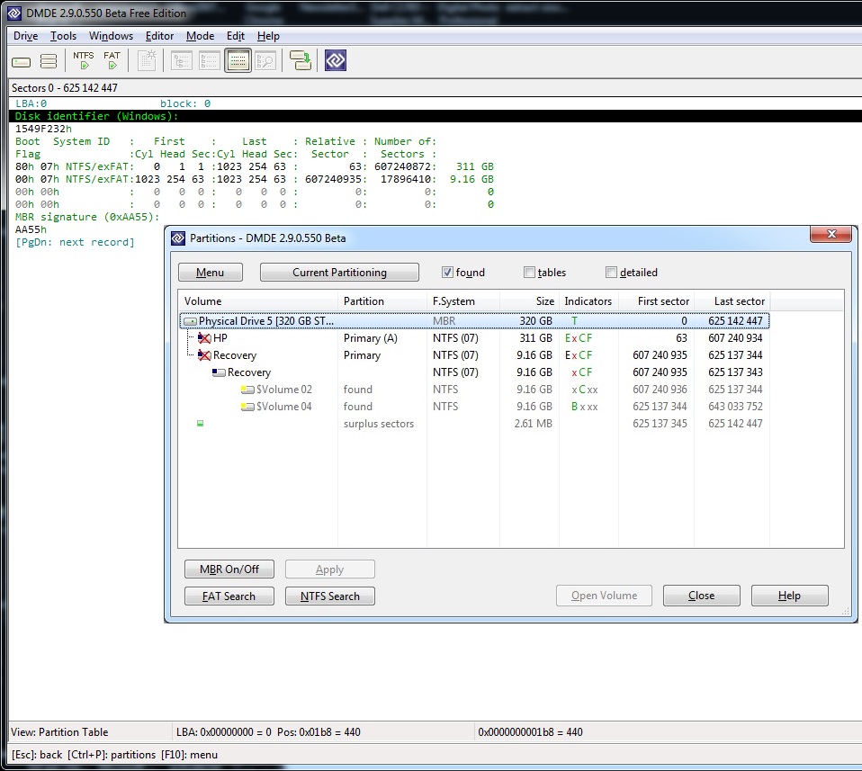

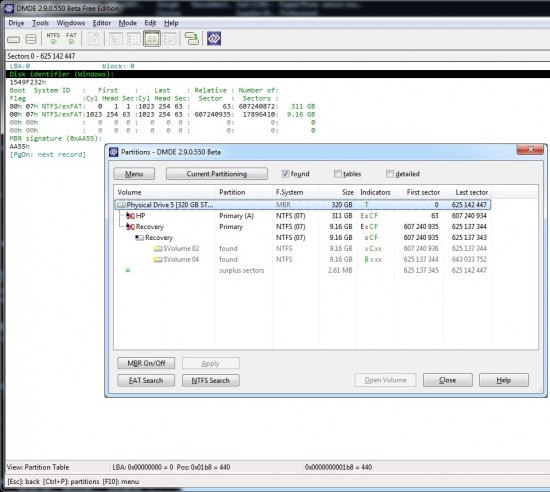

I have a PC from a friend to fix. HDD has issues. I have a new drive, but I just wanted to see if anything could be recovered fairly easily.
Connecting with a SATA-USB, Windows says it needs to format the drive, DMDE doesnt see the drive, neither does disk management.
Doing a search, I have seen reference to a "Pending" bug on 7200.10 drives, and solutions using a loader and other tools. So looks like not DIY?
Terminal is below, and the reason I posted the whole lot of seemingly identical error types is the last line. :

Posts: 3973
Well, I think i have kind of bricked the drive.
I did the commands, the cert matched.
and now the drive detects in DMDE but if it actually reads the drive, all Sectors show 00000.
Terminal is similar to before, though if I try DMDE when the drive is booting, there is some resemblence of a partitioning still available.
