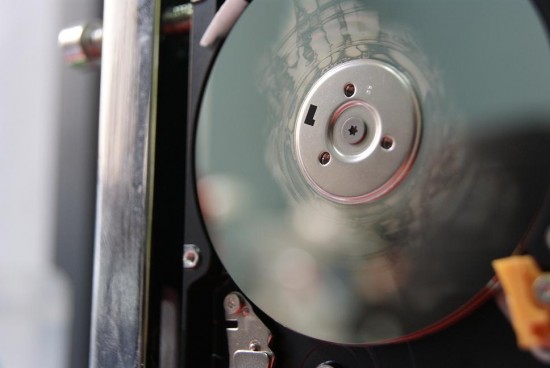

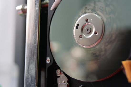

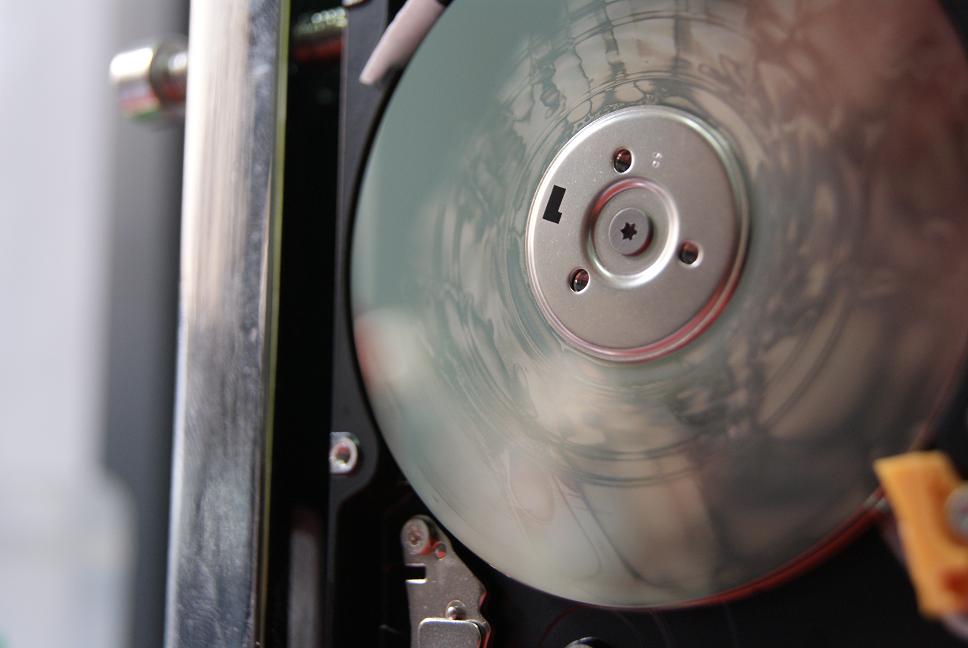

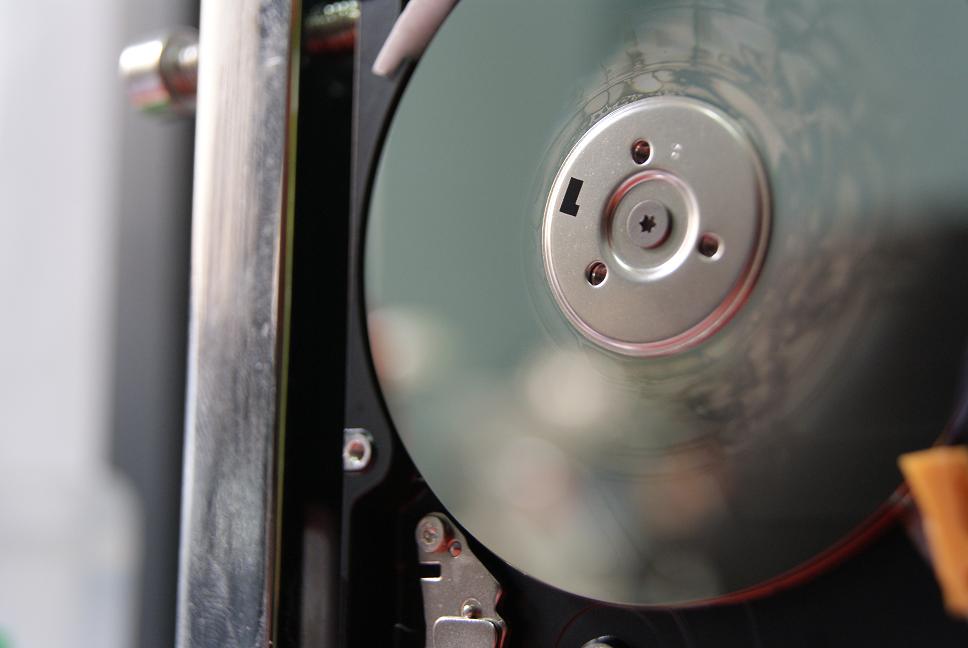

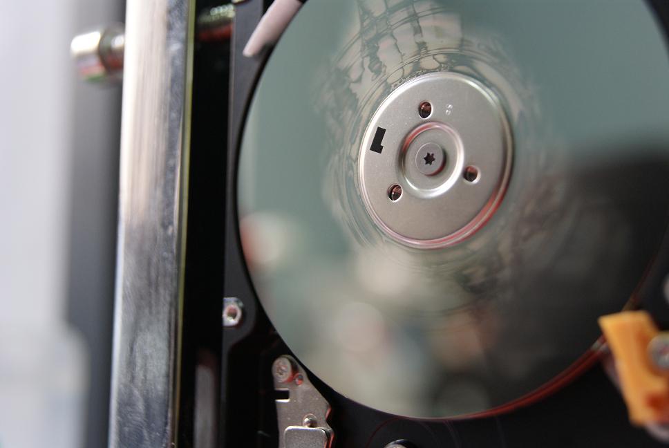

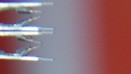

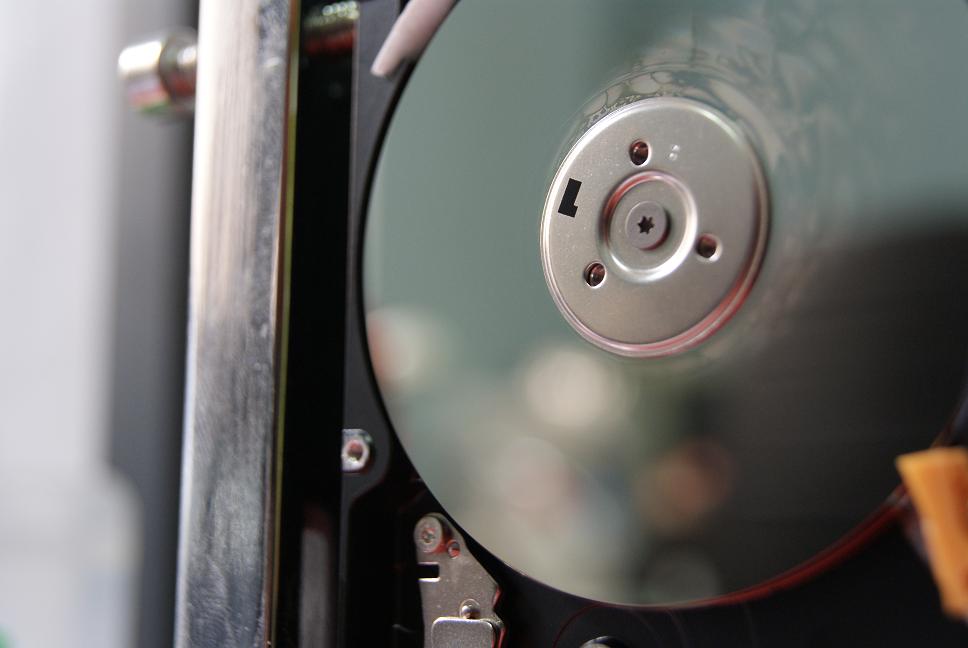

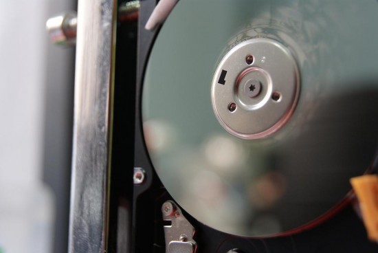

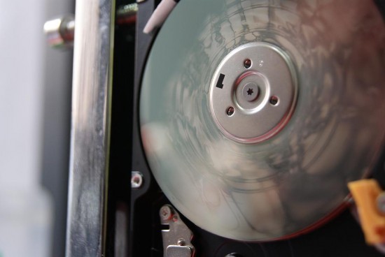

Hi Guys!
I taken a look inside HDD in clean room.
i atach pics, looks badly.
in your opininion, How many data recovery chances?
 Post subject: Re: not RDY SEAGATE Momentus 5400.4
PostPosted: July 1st, 2014, 7:18
Posts: 811
Location: World
Here are pics
PostPosted: July 1st, 2014, 7:50
Joined: October 12th, 2011, 4:13
Posts: 136
In this case, unfortunately the chances of recovery are very few. With this damages in the platters and if the anothers surface above are intact, without damages.. only one our two people in the word have the knowledge and the tools to recover in this conditions. If you have the tools to change the platters see if the surface 0 have headcrash. If so, forget about it, no recovery.

Yet Another sad customer, due to inexperience.
PostPosted: July 1st, 2014, 10:47
Joined: May 21st, 2007, 16:10
Posts: 1592
Location: Gothenburg/ Sweden
hhddrec wrote:
Subject: not RDY SEAGATE Momentus 5400.4
Bosse
hhddrec wrote:
Hi Mr-Spokk!
What you want to say?
I do not untherstand you, i made something badly?
Please report me.
Yes you did, if you unstick heads from the Surface first thing to do is to inspect those heads closely....or better, replace them.
In your case you didn't do that, and as you can see on your Pictures all 4 heads are loose, so when you start the drive they will destroy the Surface.
And with the Surface gone, all clients data is gone...
PostPosted: July 1st, 2014, 11:17
Posts: 811
Location: World
1º step:
start drive and atach it to Pc3K.
the Pc3K log was:
$($0D9E6,155CC,0D9D9,0000,00,64,70,FF)HM HM HM SFI
$($0D27A,01AF9,0D9D9,0000,00,BC,30,00)HM HM HM SFI
$($00940,01076,0D9D9,0000,00,27,70,00)HM SFI
$($0D9DB,11A7B,0D9D9,0000,00,9A,70,00)HM HM HM SFI
$($0D9DC,00FC0,0D9D9,0000,00,4F,70,00)
And with the Surface gone, all clients data is gone...[/quote]
2º Open HDD in Clean Room:
i can view heads parked into their corresponding ramps
3º extract Heads and wiew via magnifier (pic atached to this forum)
4º take a look to the platers status (as you can see to in pics atached to forum)
i do not try to read data with those badly heads, and i do not try with other ones.
in this situation i would to know if any chance of data recovery, before breaking other donnor heads.
yes, heads are loosen, and when i see this heads losen i tryed to see if there was damage on platters without try to read data from HDD
i only start the drive to see drive status via BIOS and/or Pc3k, before to see damages on heads, not after
In this case i think the surface was gone before to start testing drive. the damage is not due to my testings
PostPosted: July 1st, 2014, 11:52
Posts: 738
Location: Ottawa, Canada
My money is on the owner trying the freezer trick, which crashed the heads before you got the drive.

Thanks LarrrySabo, but i think i do not untherstand you
PostPosted: July 1st, 2014, 12:50
Posts: 738
The surface looks like it would after the drive had been in a freezer. If the owner tried that trick, he could have caused the surface damage that's on your drive's platters, which would have killed the heads when they tried to start up the drive after freezing it. It would look like this: https://www.youtube.com/watch?v=ad1uVAB5bNA
PostPosted: July 2nd, 2014, 6:43
Posts: 3549
+1
PostPosted: July 2nd, 2014, 6:46
Posts: 3549
hhddrec wrote:
The drive have sticked heads on Platers, i open it in clean room and un-sticked it.
now the drive is very instable, sometimes can RDY and i can see any sec but commnly not get RDY
So you unstuck heads, they were totally screwed, but still you powered on the drive.
Given the fact (for me) that the drive has been in the freezer as well, and that there are obvious rings on the top platter, I would not waste another set of heads for this.
PostPosted: July 2nd, 2014, 8:52
Posts: 811
Location: World
Thaks Larry and NorthWind!
