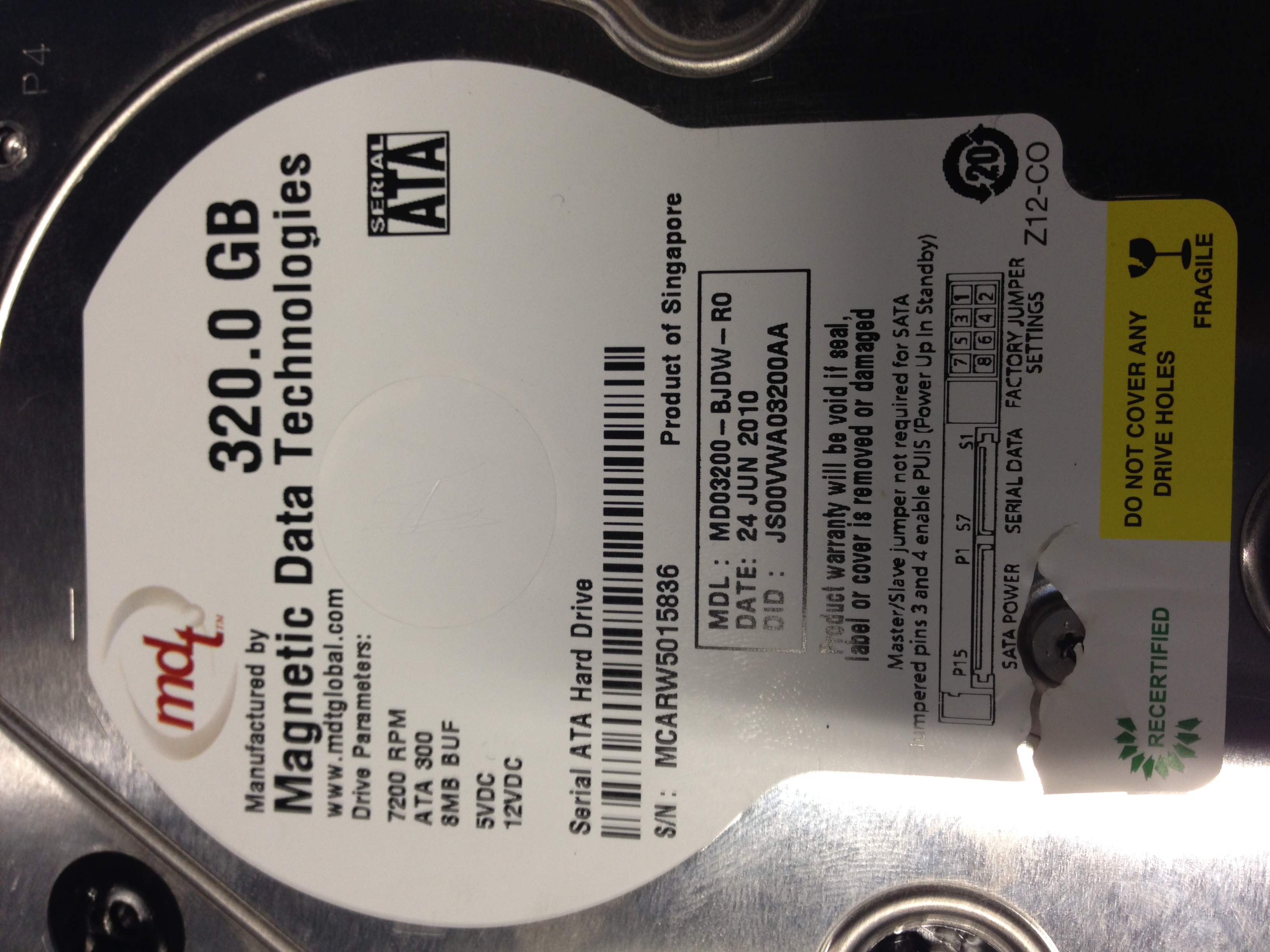

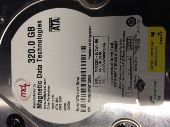

Here is a picture of the label, let me know if you need a picture of the drive internals as I'll have to get it back into the 'clean' cabinet for that
cheers.

With the picture seams a WD refurbished. The drive shut down and is recognised in PC3K by the PCB? Try to change the RAM map for 0 to test the head 0 and pres F7 our soft reset and go out to see if the drive can read the FW with that head.

It is rebranded WD3200JS-00VWA0

You need to change heads.
I also suggest you do not power up the drive again, until the heads are changed.
As hddguy said, this is a Tornado, so you can use a compatible one for heads.

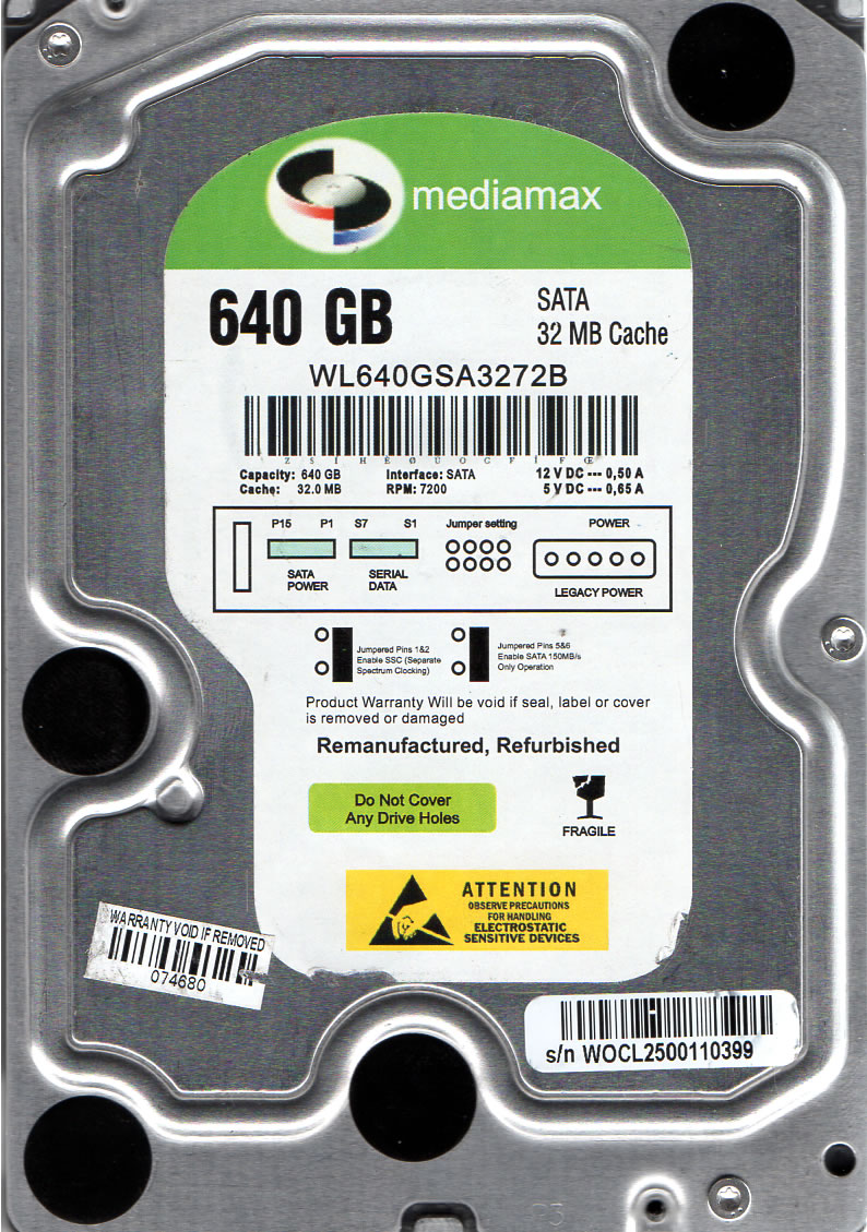

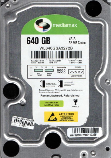

Here is a nice Mars, rebranded by MediaMax.
4 heads, 3 platters.
