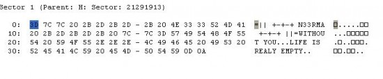

All jpg files showing 61 KB size
Not able to open it seems virus attack. is there any solution?

We need more details than this.
1. What was the original problem?
2. Did you get a full clone of the drive?
3. Are we looking a a file from the original, clone or from recovered data using a data recovery program?
4. Can you provide the headers of more than one file to compare?
Original problem is that unable to open JPG files
yes
Original file/tried recovery program but same issue it also shows same size of file
all jpg files showing same as shown

If this is due to a virus attack then i think it has attacked the filesystem.
Have you tried to recover your jpg files with R-studio (probably you'll need to do a full scan for RAW recovery)?
If you can recover those files via R-studio save on a third drive.

RAW Recovery worked
