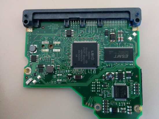

I'm dealing with a seagate barracuda 7200 11 1.5TB, with a "burned" electronic.
When the accident happened the drive didn't even had the time to power on or start spinning.
I have gathered a replacement external PCB as an attempt to have the drive to power on again and recover my lost data.
the part number printed on the PCB is the same, it powers on the drive, but the drive "clicks".

Post a good picture of the component side of the board so we can see what was burned.

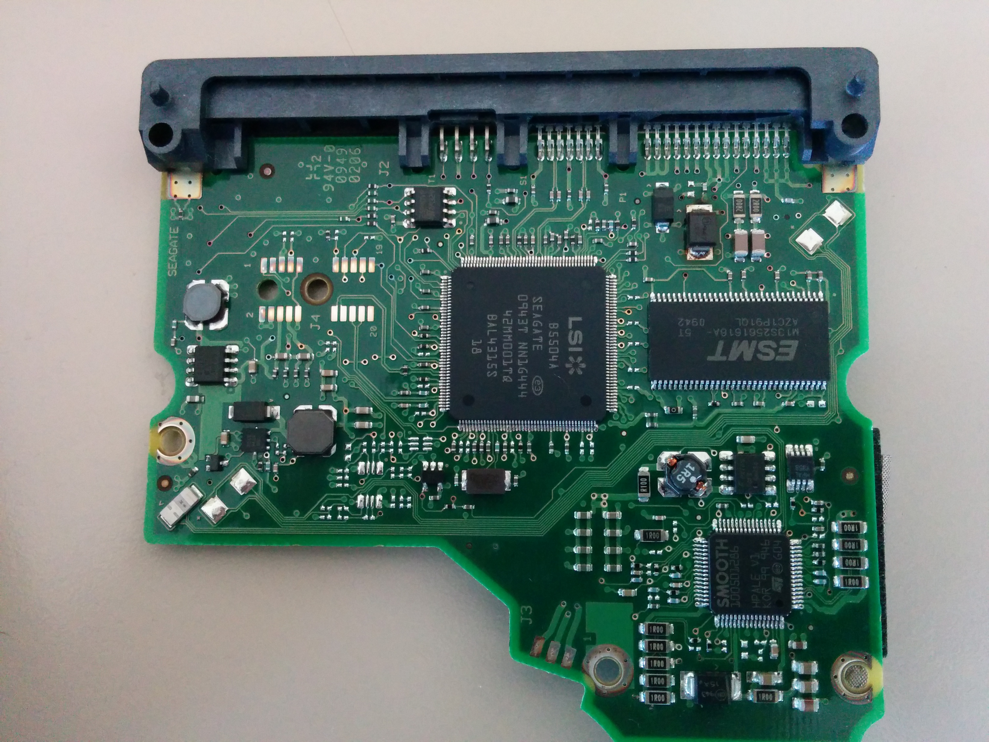

Here is a pic of the damaged PCB
hope the resolution is detailed enaugh as it's all i can get with my phone's camera
Thanks very much again for the help

TVS is shorted. Replace it.
which one is the TVS?
 Post subject: Re: Need a little help with a Seagate Barracuda 7200 11 1.5T
PostPosted: July 10th, 2014, 3:37
Posts: 1898
Location: In your hard drive.
The one with burn marks and deformed/overheated legs.
Hint: Top right.

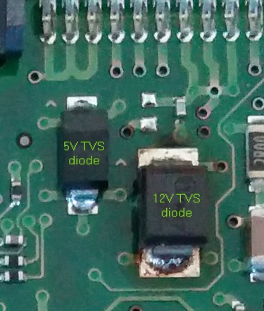

Also see http://hddrepairing.com/downloads_n_vid ... airing.pdf
You don't need to replace the shorted diode. Simply remove it. However, be aware that the drive will no longer be protected, so don't overvolt it again.
BTW, the usual culprit in an external enclosure is the 12V TVS diode, especially if you have used a 19V laptop adapter.

Personally, I would not run a customers drive without a 10cent TVS. But that's just me.

i think i can simply replace the diode.. it's the 12V one i guess..

If you feel confident with soldering, use the TVS from your donor PCB. Just make sure you get the direction correct on the TVS.

removing TVs is enogth to get data, but if you want you can replace it, this is securelly option.

I'm already stuck lol, the plus in the TVS is the one indicated by the up pointing arrow on the PCB?i mean looking at the pic, the top one
