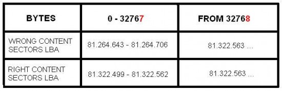

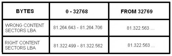

Somehow, one of my very important 468.368 bytes txt file is partially corrupted when opening with some programs but not corrupted when opening with Winhex.
When opening it with Notepad or Wordpad or Firefox... the first 32768 bytes has unexpected content and the rest of the file is good. Those 32768 bytes (64 sectors) are picked up from a different part of hdd and the rest is picked up from the right place.
But, when opening it in Winhex the content of the first 32768 bytes are god (the rest also good).
When I make a copy with Commander or My Computer I get bad copy (first 32768 bytes wrong, the rest is good) but when make a copy with WinHex or TestDisk I get a good copy (right content) of “corrupted” txt file and later it can be wieved in Notepad or Wordpad...
So, I have some questions:
- WHAT IS THE REASON FOR THIS DIFFERENCE
- does it mean that is unsafe to backup data without WinHex/TestDisk or some other similar direct access tool because the backuped data may be corrupted because of some BUG when Windows operate with files
- does it mean that Windows Copy command is partially BOGUS and Windows as a “copy tool" also
- does it mean that backup made with Windows may NOT be IDENTICAL with original as it should be and there is no warning about it

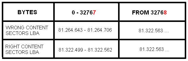

It is irrelevant which program is opening txt file (Notepad, Wordpad, any txt viewer). It does not opet complete file (468.368 bytes). It reads first part (64 sectors) from LBA 81.264.643 instead of LBA 81.322.562 where 32.768 bytes of REALL txt file are stored.

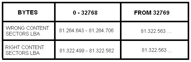

Actually, the problem is in DIFFERENCE in reading from hdd between WinHex/TestDisk (direct access) and by Windows My Computer. Same thing happened when tried to view file in Commander with View command (F3).
So, my question is WHY different tools show DIFFERENT results of GOOD file. What is the cause? Where from they read stored file's data (location, lenght...) Is it from $MFT or not and how is possible to have not the same results when reading that txt file content.

Here is the good table pic
