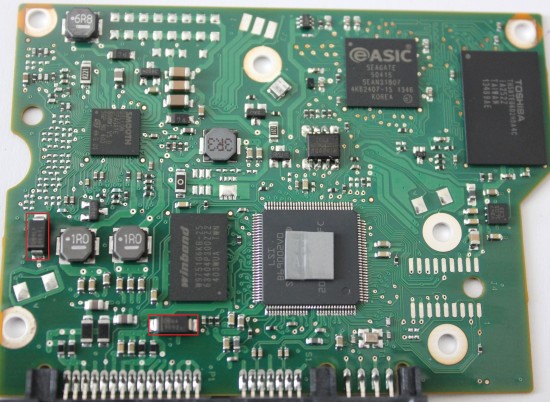

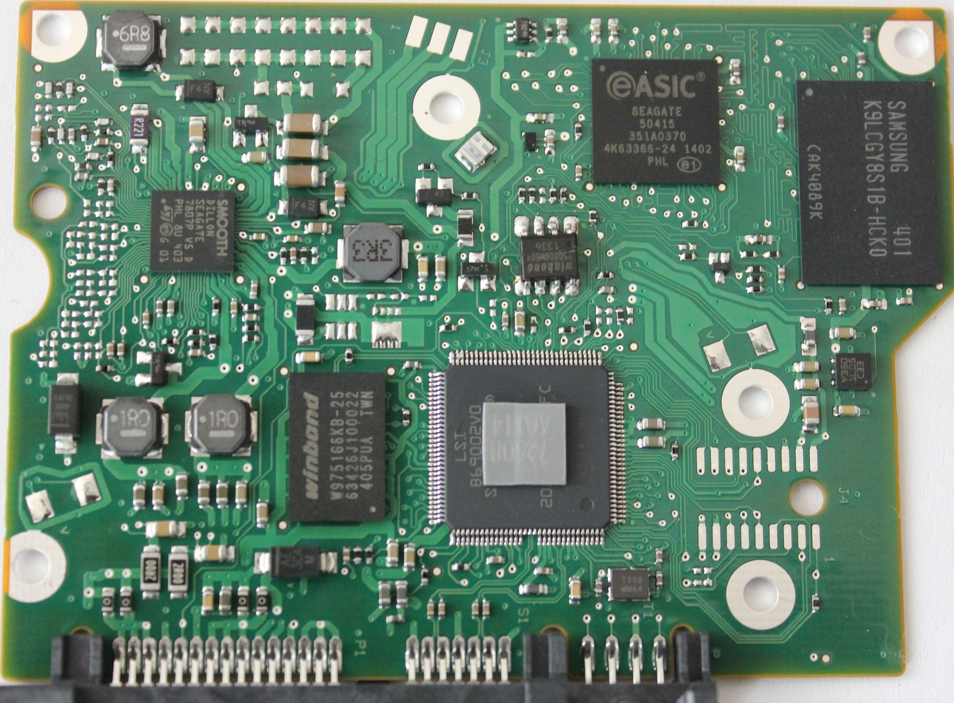

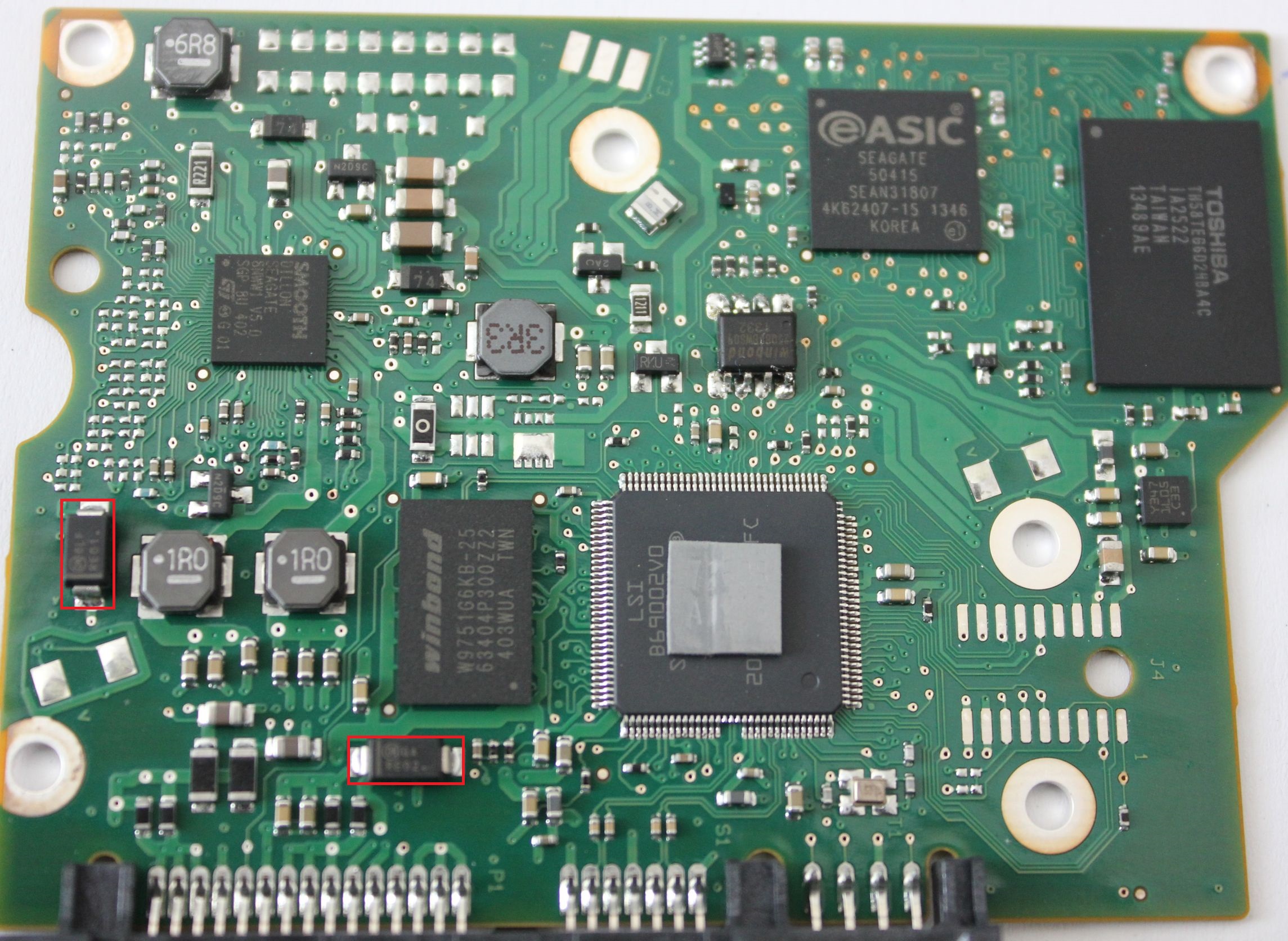

Hi all,
I hope someone can give me some hints on this one: I got a Seagate hybrid harddrive that does not spin anymore (Seagate Desktop SSHD 1 Tbyte) and does not give any terminal output. The HDD comes from a Desktop-PC.
Things I tried so far:

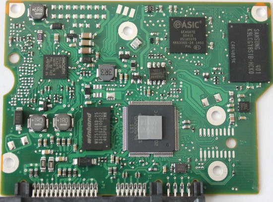

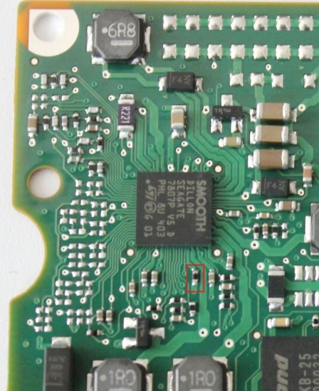

- The PCB looks fine, no burnt components as you can see in the images attached.
- I tested the TVS diodes (marked red) and they seem to be ok (diode test: no beep).
- So I tried swapping the winbond ROM chip (8 legs) to a new drive (same model number, same firmware, same site-code, same date-code).
After ROM chip transfer the disk spins up fine, detected in BIOS, capacity matched but I was unable to Image:
- First tried with Acronis (maybe would have been the fastest way) - did not work bc HDD not recognised.
- So tried with DDI. DDI could not head map, forward Imaging failed completely, backward imaging failed with UNC :-(
So I soldered back the ROM, would be better to fix the PCB itself, anyone successfuly fixed those Seagate hybrid pcbs?
Thank you all,
@pcimage: You posted a similar case http://forum.hddguru.com/viewtopic.php?f=1&t=27790. Have you been able to fix that drive?
File comment: Known working PCB

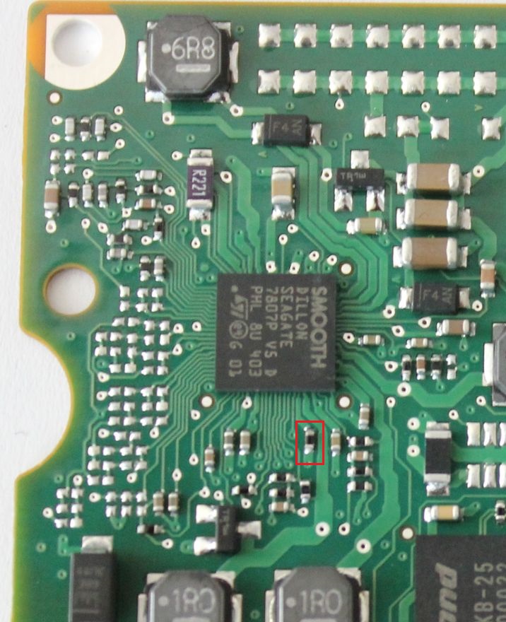

File comment: Original BAD PCB

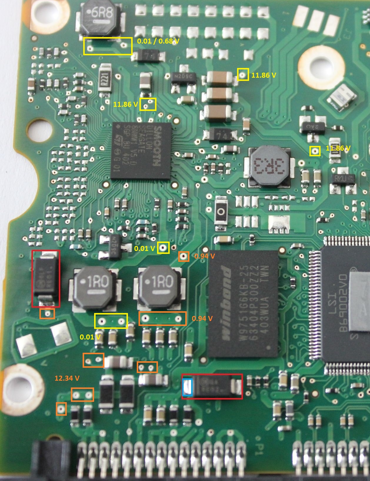

@Tomset: What exacly do you mean with initialization of NVC and how can this be done? I thought the disk is not readable because of the ssd-part / caching.

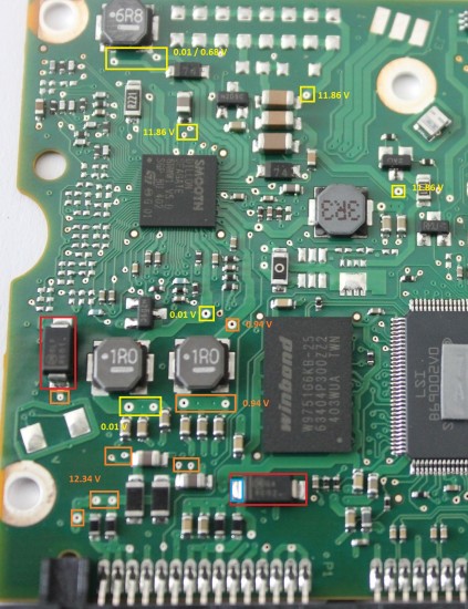

@fzabkar: My knowledge in electronics is limited, it would be kind if you or some other of the hddgurus could give me some hints on that board. I measured voltage on many testpoints on the pcb and attached a picture showing the voltages.
I think all orange points are OK at 12.34 V / 0.94 V
The blue one is 5 V should be OK
All the yellow voltages are not OK:
0.01 V should be 1.05 V
11.86 V should be 12.34 V
So what component could be damaged and what can I do to fix that PCB?
File comment: Voltages

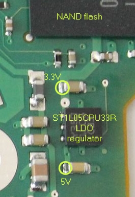

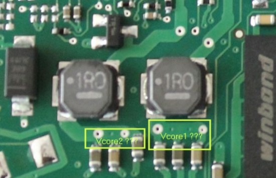

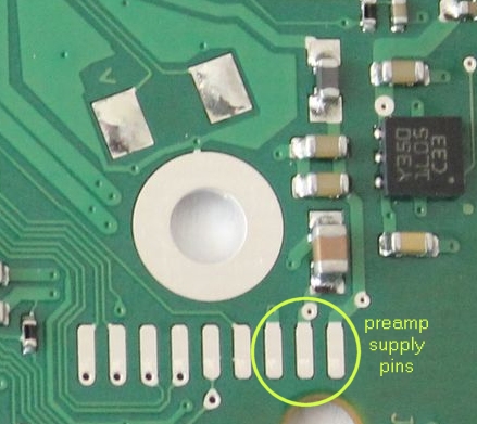

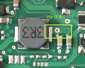

I can see that some voltages are present and at least one other is missing. I don't know whether this constitutes a fault, or whether the MCU is switching one or more of the voltages off.
The attachments are my guesses as to the location and identity of various test points. A comparison with your working board would be helpful.
I expect that the ASIC would require Vcore and Vio voltages of its own. It may or may not share these with the main MCU.
The serial flash memory and SDRAM appear to require 1.8V.
The NAND flash requires 3.3V, probably supplied by the LDO regulator.
ST1L05CPU33R, ST Microelectronics, LDO regulator, 3.3V, 1.3A, marking 1L05C33:
http://www.st.com/web/en/resource/techn ... 186925.pdf
W9751G6KB-25, Winbond, 8M × 4 BANKS × 16 bit DDR2 SDRAM, 1.8V:
http://www.winbond.com/NR/rdonlyres/548 ... 51G6KB.pdf
W25Q80BWIG, Winbond, 8Mbit, serial flash memory, SPI, B = 1.65V - 1.95V:
http://www.nexflash.com/NR/rdonlyres/A4 ... 5Q80BW.pdf

@fzabkar: Thank you for your help with this one. I checked those test-points (good & bad pcb):
3V3_LDO_reg: These are correct: 5V and 3.3V
preamp: gives me 0V 5V 0V

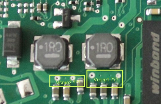

Vcore: On the bad pcb Vcore2 is 0V, Vcore1 is 0.94V / Good pcb Vcore2 is 1.05V an Vcore1 is 0.94V
Vio_1V8: Is correct with 1.8V on good & bad pcb

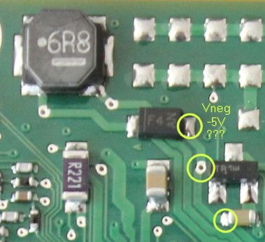

Vneg: All 0V on good & bad pcb, but on the left side of the black chip should be 12V I think (good pcb) vs 0V (bad pcb)
I will check the docs you attached tomorrow.

Could the absence of any terminal output be due to an inability of your equipment to handle the 1.8V LVTTL signal levels?
My next thought would be whether there is a short circuit on the Vcore2 output. Can you measure the resistance between this test point and ground?
The absence of the negative preamp supply appears to be due to it not being enabled by the SMOOTH IC. This is normal behaviour in some designs. That said, I am not certain that I have correctly identified the corresponding DC-DC converter circuitry. Perhaps the regulator in the top left corner is a buck boost converter that generates the boost voltage (18V ?) for the VCM circuit during normal operation and which is switched off when the spindle motor is not spinning?
Anyway, ISTM that the primary cause for concern should be Vcore2. If this supply powers the main LSI MCU, then its absence would explain why the PCB is brain dead. At the very least, this MCU should be receiving a Vcore and Vio supply from the SMOOTH controller. Once the MCU powers up, it can then tell the SMOOTH chip to switch on the other supplies, or to leave them in power saving mode. Alternatively, if Vcore2 powers the ASIC, then it could be that the MCU is switching it off. That said, if the NAND flash is receiving its 3.3V supply, then it wouldn't make sense to switch of the ASIC's Vcore supply on its own.
I would determine which of the Vcore supplies is powering the MCU and which is powering the ASIC. To this end, I would measure the voltages across the small bypass capacitors that surround each of these two controllers. Alternatively, you could just measure the resistances between the Vcore test points and each of these capacitors.

Here is a board (from ST1000DM003 or ST2000DM001) with the same SMOOTH IC and similar switchmode supplies:
http://ep.yimg.com/ay/yhst-444636922352 ... 7658-4.gif
It appears that the two Vcore regulators are for a dual-core MCU. It could be that they also power the ASIC.
The 6R8 coil does appear to be part of the negative preamp supply.
