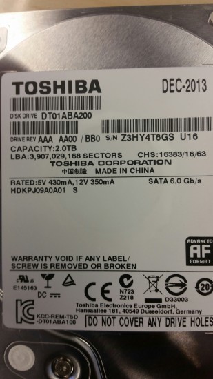

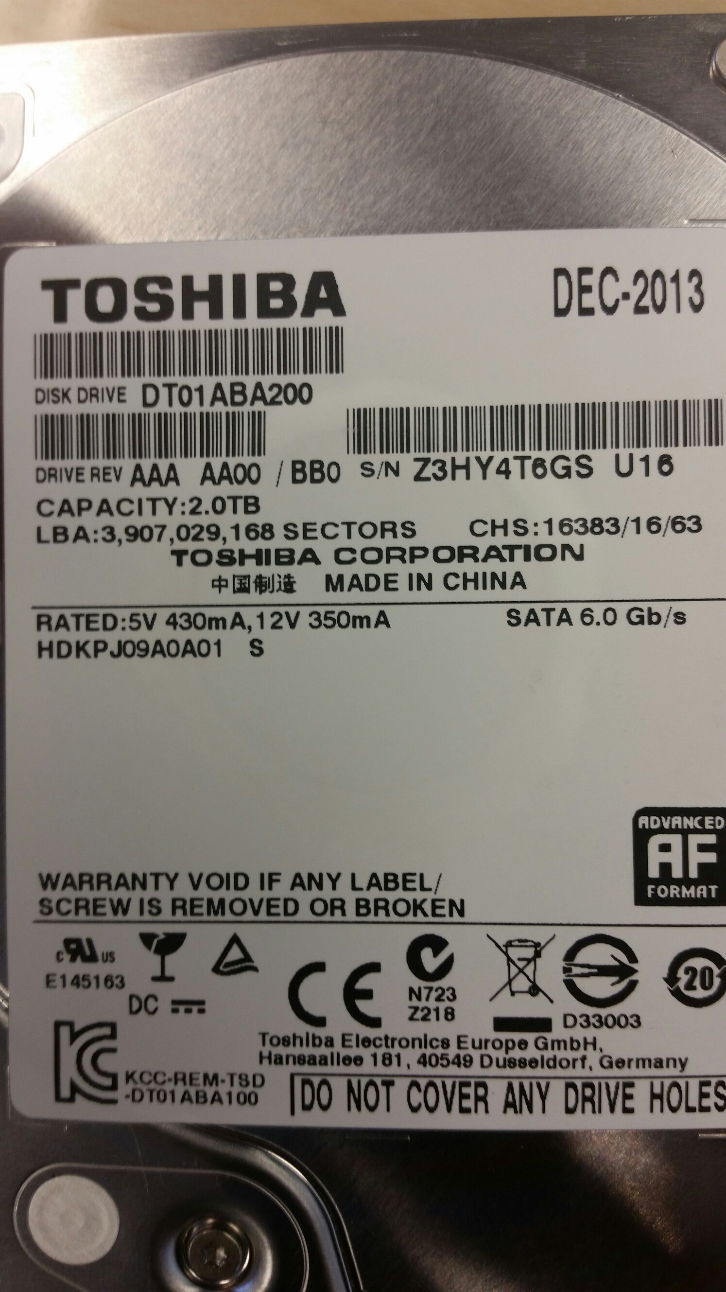

Just got one of these Toshiba 3.5" in for the first time. Any ideas on what parameters to use for head replacement?

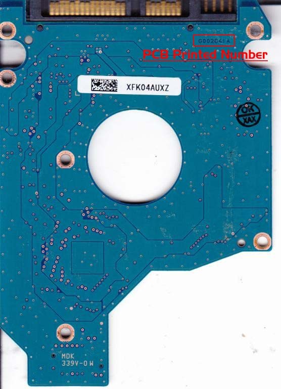

Check donor drives checklist http://www.donordrives.com/hard-drive-pcb-donor-match
Toshiba
Circuit Board / PCB Match Criteria.
Note: Chip Transfer Required in most cases.
1. Full Model Number. Example: MK3265GSX, MK1017GAP
2. PCB printed number. Example: G002641A, B36021242013-A
Hard Drive Match Criteria (for Head Stack Assembly replacement or Platter Swap)
1. Full Model Number. MK3265GSX, MK1017GAP
2. Closest HDD Code Possible. HDD2H83 F VL01 S, HDD2151 Y ZE01T
Pictures:
http://www.donordrives.com/images/toshiba_pic2_2.jpg
http://www.donordrives.com/images/toshiba_pic1_2.jpg

This is a 3.5" hard drive rather than the usual 2.5", so the normal parameters do not apply. ie. there is no HDD number etc.
 Post subject: Re: Toshiba DT01ABA200 Head Replacement Parameters
PostPosted: July 17th, 2014, 15:04
As it is an Hitachi under the hood, based on what I'm seeing, you will need to follow Hitachi matching standards, not Toshiba.
PostPosted: July 18th, 2014, 4:25
Posts: 811
Location: World
good advice Luke!
