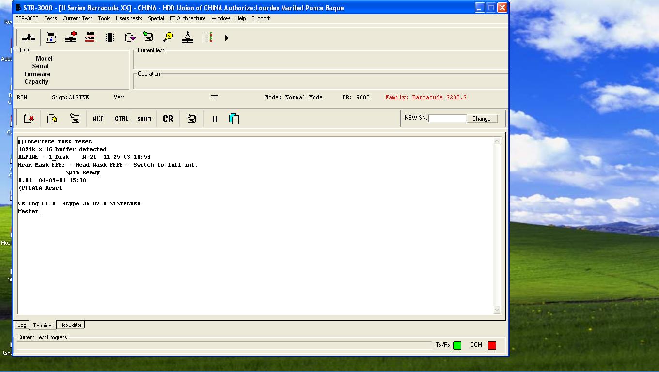

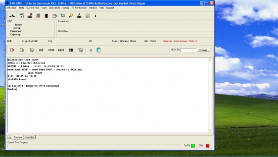

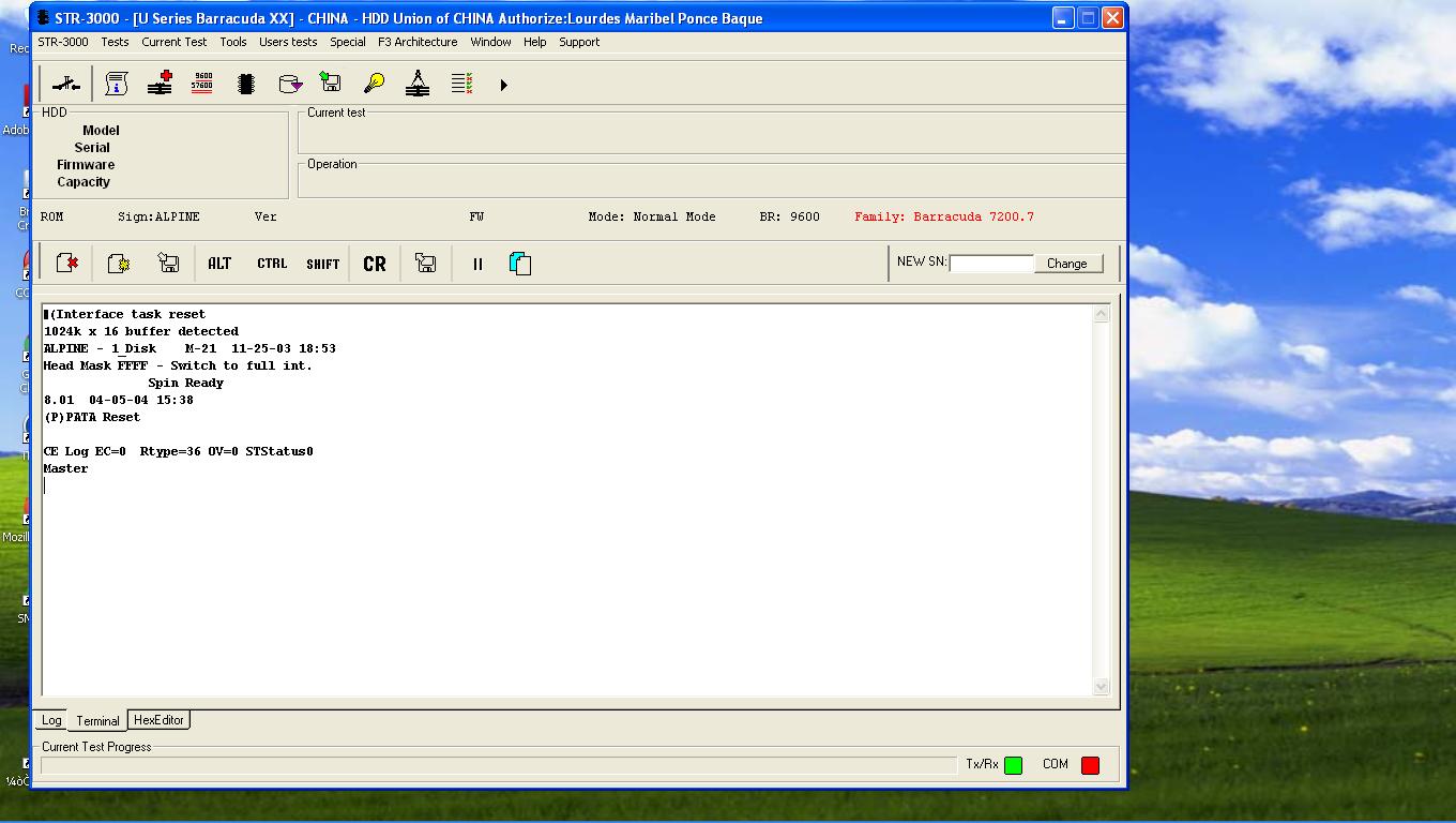

first i boot hdd on str com
terminal log show me error ce-log

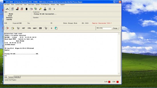

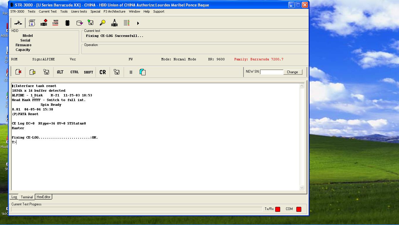

then i fix it with fix error log
after that show is ok
then i restar the hdd
it's come back show error log
what step if i want this hdd work again
i dont want to recover data only refurbish the hdd

Head is damaged,
Try to depop the damaged head.

thanks to your answer , but i think str cannot do for depop head....any suggest other software...?
