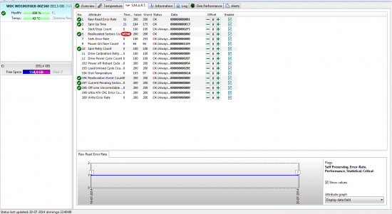

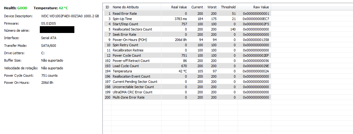

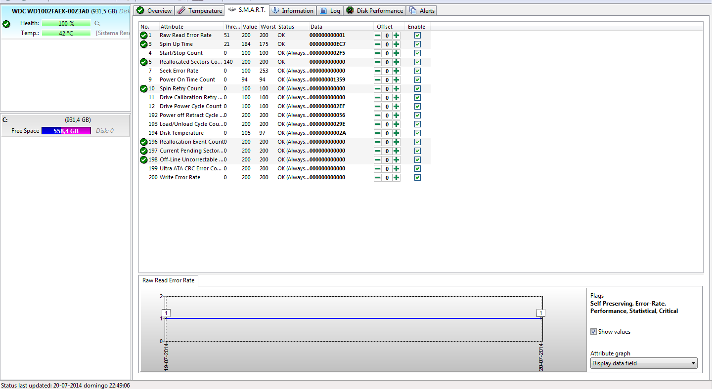

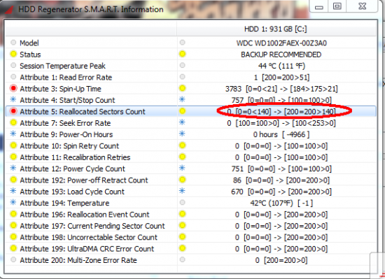

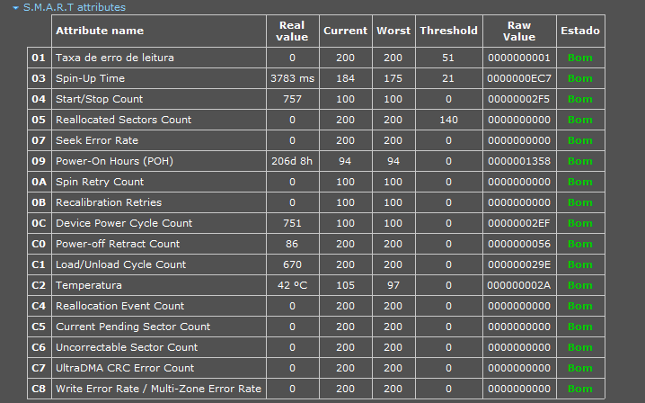

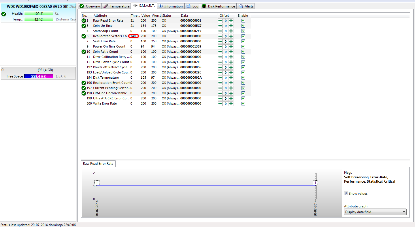

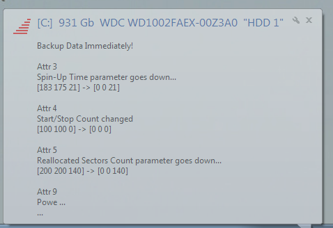

Yesterday I was using Defraggler from piriform to do a defrag, and I suddenly got a Disk Health: bad, and checked SMART, and all was 0, all SMART attributes was with error and bad, temperature was 0ยบ (of course incorrect) a new disk with about 1 year and half, then I canceled the defrag and only have done a chkdsk (just chkdsk) on restart, then it took too much time, but at this time when I opened Defraggler, and I checked the Disk Health: good, also all SMART attributes was right.
It was a bug?
I think so because I was running Norton 360 Scheduled malware search and Defraggler simultaneously.
Then I put the WD diagnostic tool running, and done a quick test and extended test and I got all tests OK and passed.
Well, I let you 7 screenshots and please analyze this and say me if all is ok, and if all SMART attributes are there and OK or is someone attribute missing, or I should take it to warranty.

HD Sentinel:
http://gyazo.com/66148ffd5a76e07f5fb2dee84bf4e42c.png
http://gyazo.com/6c751bf0385fbe4a987be3e50e4a776a.png

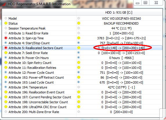

Well and about this...?
HDD Regenerator
http://i.gyazo.com/847ab807e031964301dab1168619f9a0.png
http://i.gyazo.com/639388eae7b919357151d805ad3ac3d7.png

Let you one more photo from HDD Regenerator:
http://i.gyazo.com/12126ffff3e6c6257467073fbe635702.png

Problem is that some sectors are damaged but they have been reallocated (140 reallocated sectors).
Your drive is going to die, backup your data on a new one as soon as possible

Before an attribute is being reported as bad must reach a certain threshold.
"reallocated sectors" hasn't still reached the "bad" threshold for this reason is still indicated as good, but you can see that is going bad.

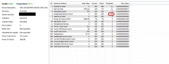

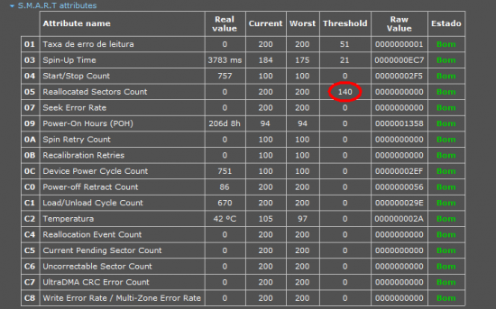

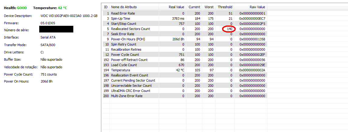

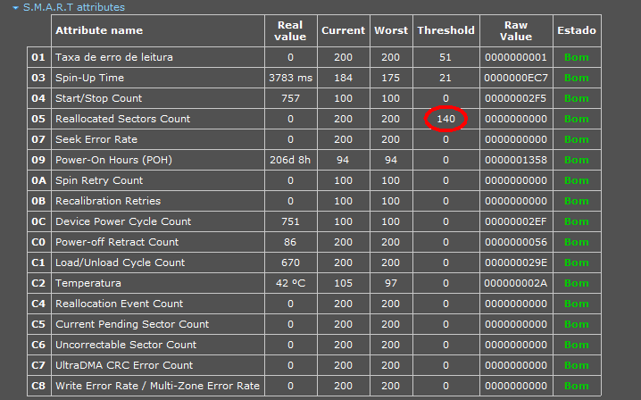

Can you show me where you saw about 140?
 Post subject: Re: Western Digital Black WD1002FAEX Health bad
PostPosted: July 22nd, 2014, 17:06
Posts: 17323
"140" is the normalised threshold. The raw count is 0. AFAICT, the SMART report shows no evidence of any problem.
BTW, I would avoid HDD Regenerator (and SpinRite).
See viewtopic.php?f=1&t=28780
So everything is fine with my WD Black FAEX?

fzabkar right, i was wrong. Sorry
140 is the theshold.
HD Sentinel http://i.gyazo.com/6c751bf0385fbe4a987be3e50e4a776a.png no: 5 threshold 140
Speccy http://i.gyazo.com/58ac447cdba7f2a045d24cccf1cfaf6e.png no: 5 threshold 140
Defraggler http://i.gyazo.com/2d5edfd7ecd060ebb389ecc533787733.png 5 threshold 140
