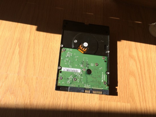

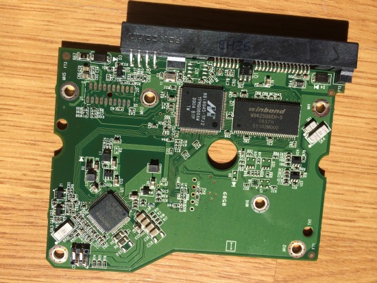

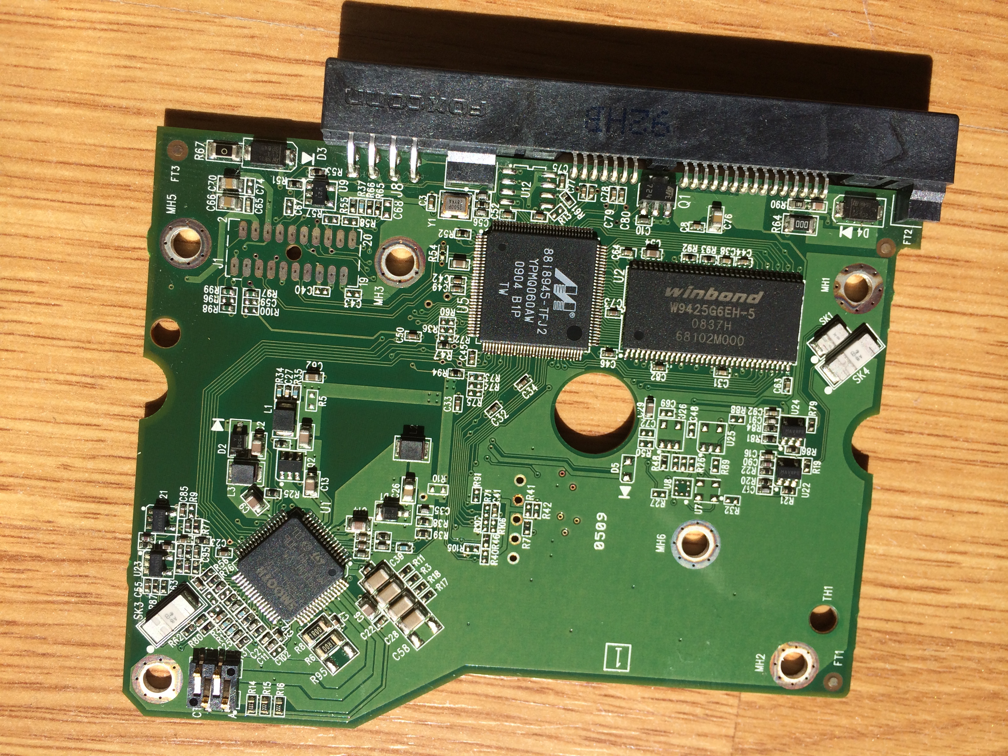

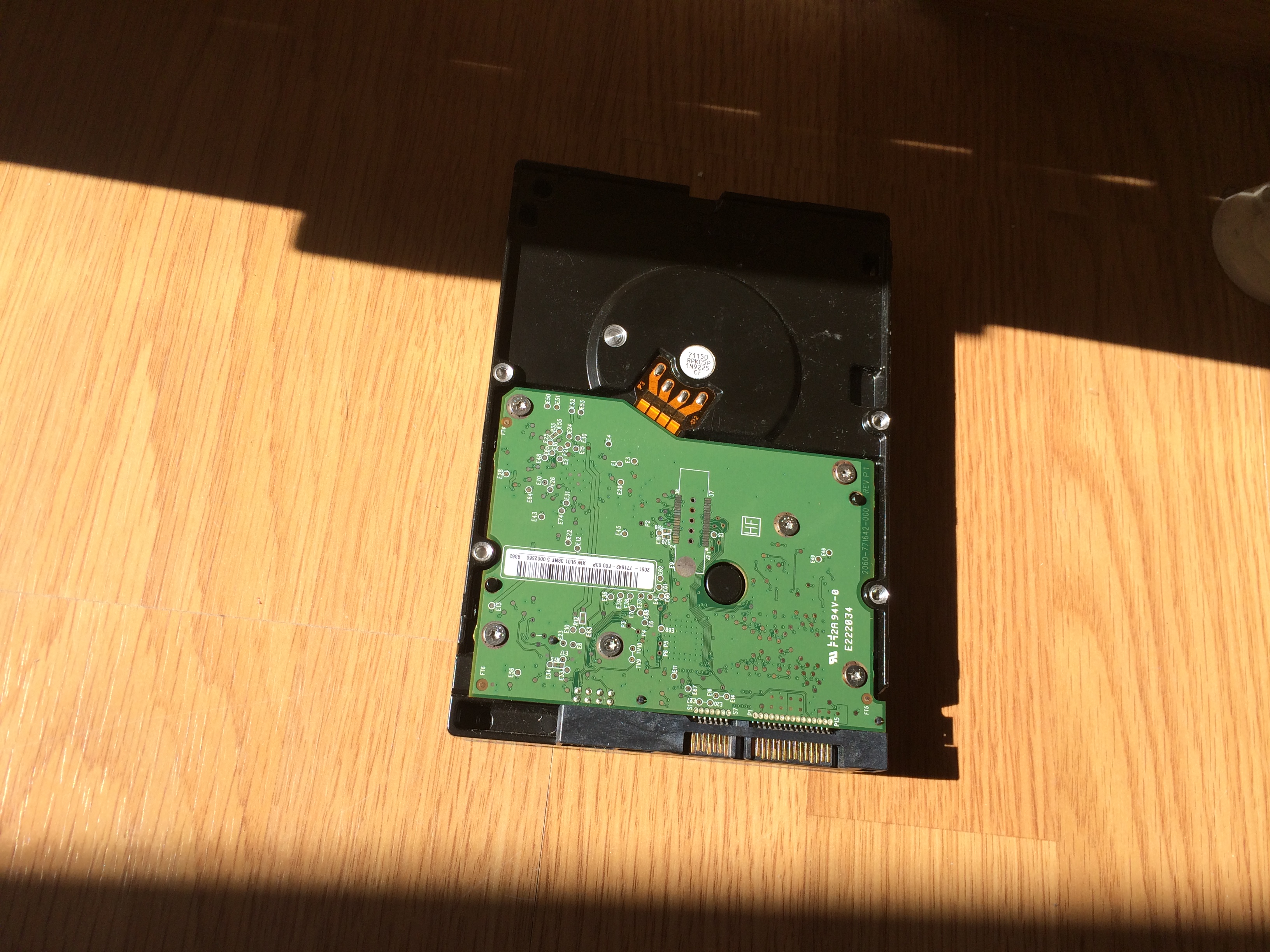

Dear all,
I have 2TB Western Digital hard drive, which doesn't respond. I connected it through USB-SATA-connector and shortly it shows and is down again after 2-3 seconds. It does a very quiet noise, which is difficult for me to record as it is so quiet.
Something like buuuzz bick bick bick buuzz bick bick - end.
That is all. Here are the data and some photos from the PCB:
Western Digital 2.0 TB WD20EADS 32 MB Cache Caviar Green
512B Sectors
MDL: WD20EADS-00R6B0
WWN: 50014EE202930CA8
DATE: 24 MAR 2009
DCM: HARCHV2AAB
LBA: 3907029168
5VDC: 0.60A
12VDC: 0.45A
R/N: 771642
PCB E222034
Marvell 88i8945-TFJ2 YPMQ060AW 0904 B1P TW
Winbond W9425G6EH-5 0837H 68102M000
Smooth L7251 31 990UW V5 MYS 99 906
PCB Model: 2061-771642-F00 03P
XW9L01 38NF 5 0002360
Thanks in advance if somebody could help here.
 Post subject: Re: Western Digital 2TB WD20EADS 32MB Cache Caviar Green no
PostPosted: July 23rd, 2014, 7:52
Almost certainly a physical (heads) issue. :-(
PostPosted: July 23rd, 2014, 14:18
Joined: January 11th, 2014, 20:59
Posts: 6
Location: Germany
Oops. And it isn't possible that it is a problem of PCB? And if physical heads issue, would it be possible to rescue the data for me? I have a same hard disc.
PostPosted: July 23rd, 2014, 16:37
On this model, very small chance of PCB issue causing drive to click and spin down. Some "Tornado" series drives had known PCB issues causing these symptoms on rare occasions, but never seen it on this series.
There's a good chance we can recover your data, but you'd have to ship it over to UK.
If it does by some miracle turn out to be the PCB, the cost will be be low :-)
Coincidently enough, I've just come back from Germany. A "business trip" to Hamburg. Reeperbahn and all :-)
PostPosted: July 24th, 2014, 5:26
Posts: 811
Location: World
The most porbably will be a head isue.
Contac with a local pro, because clean bech needed.
