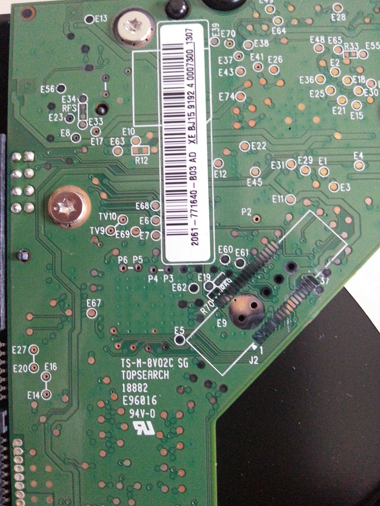

I did try to connect (a few days later) the HD with it's genuine AC Power supply and the USB Cable to my Computer, but the led won't light up, and I can't hear the HD starting to spin.

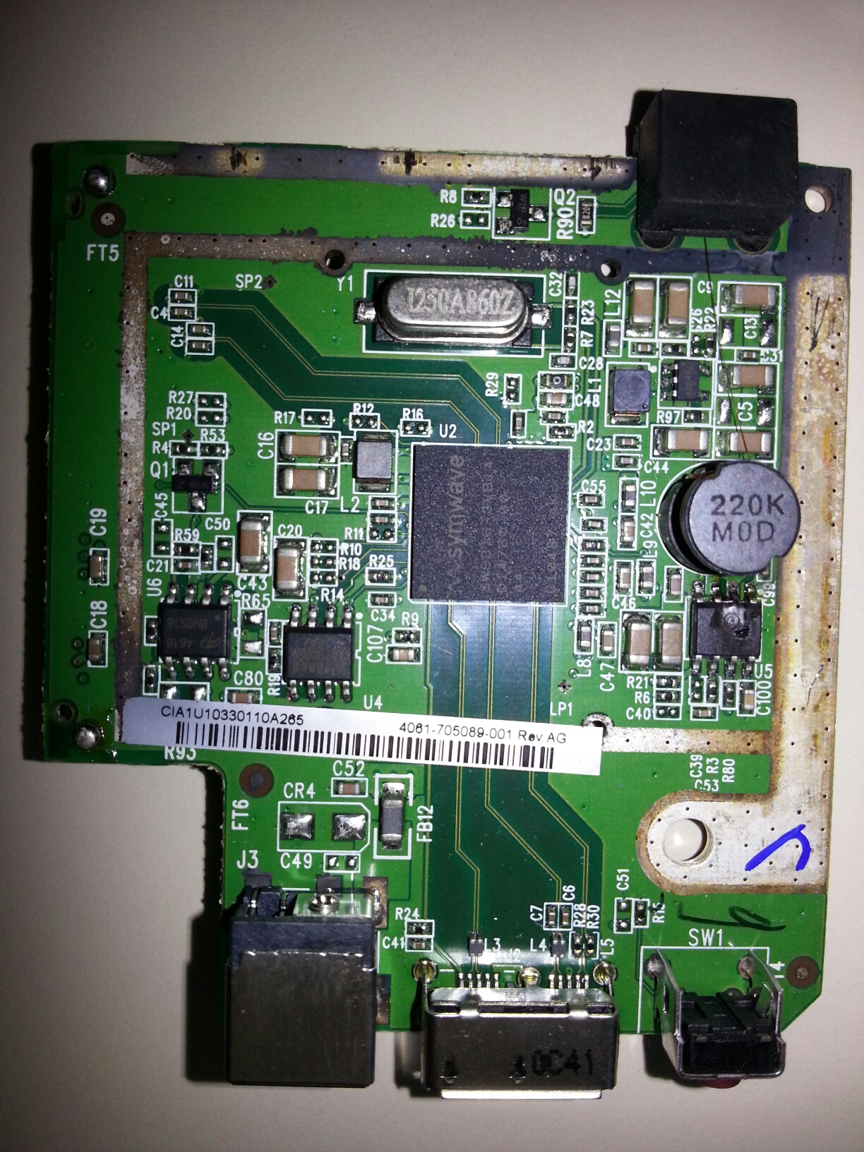

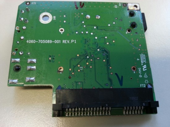

So from that point I decided to unbox the Mybook (not the disk itself), and see how it's look inside. Unboxing the HD was quite easy and took me a few minutes to do it.
on the PCB (4061.705089-001 Rev.AG) We can clearly see that the chip U5 heated to much. to my eyes all other components looks good. Here is a view of the PCB:

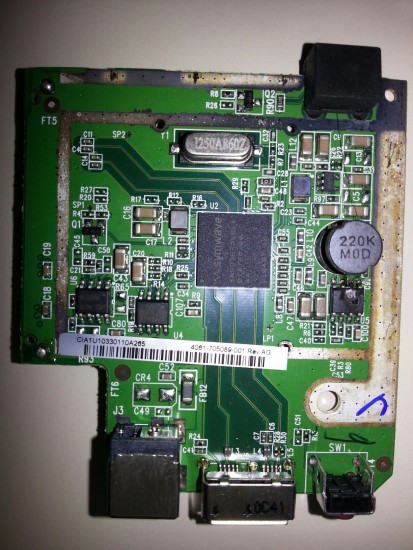

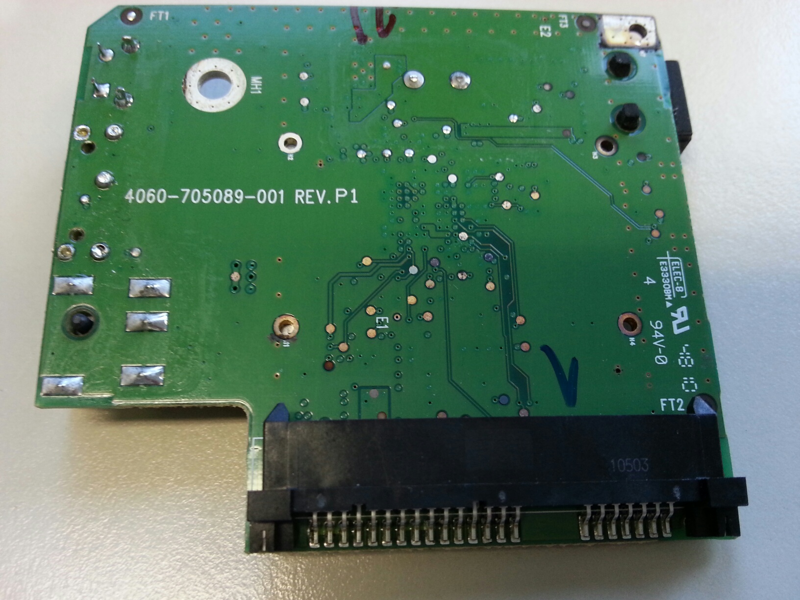

Here is a view of the bottom side of the PCB (this time labelled 406-70589-001 Rev.P1

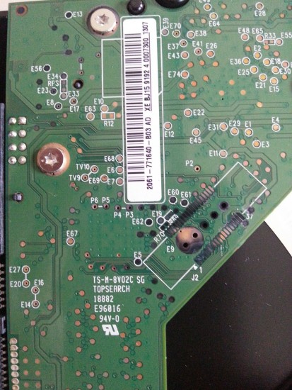

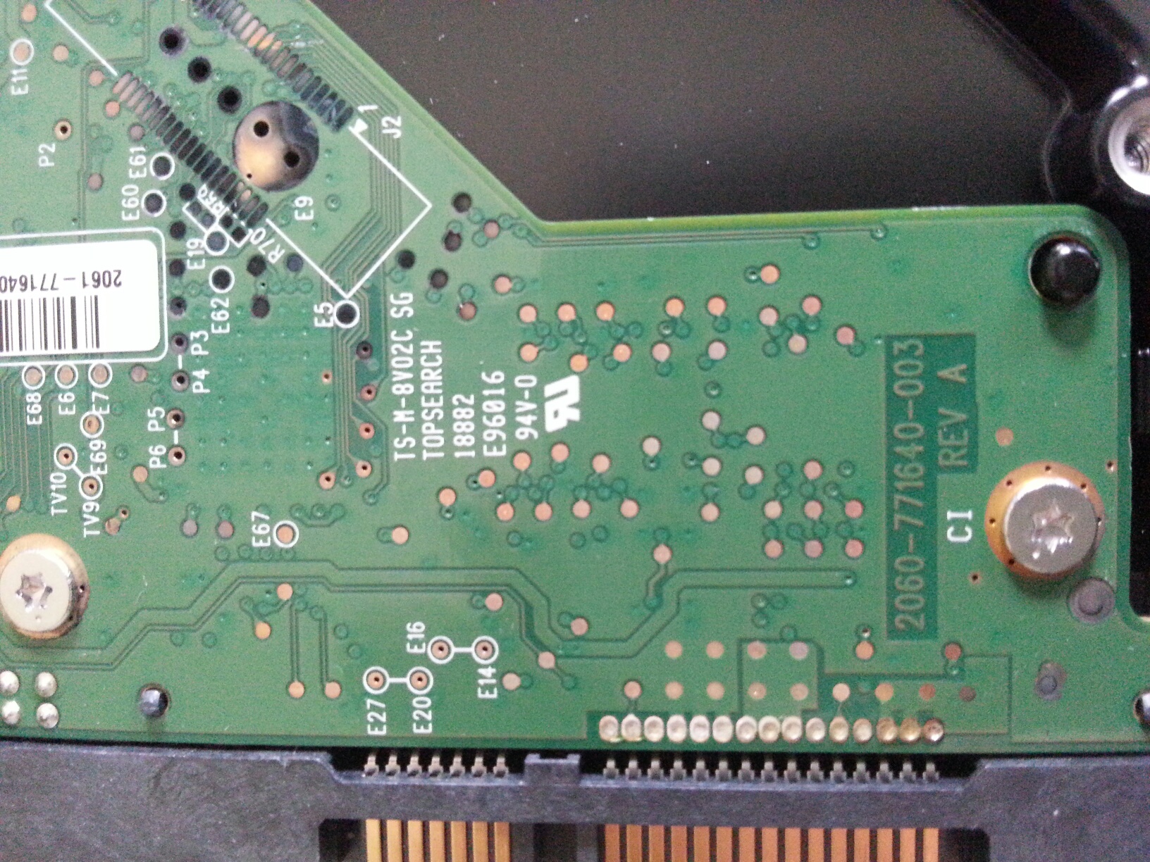

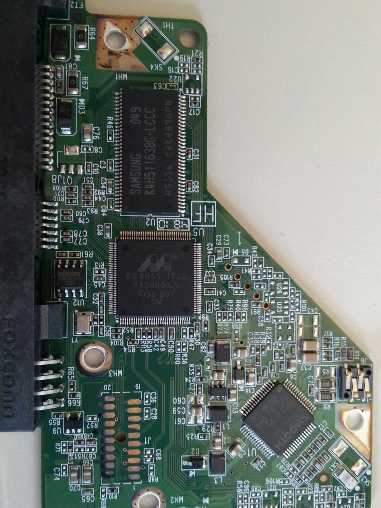

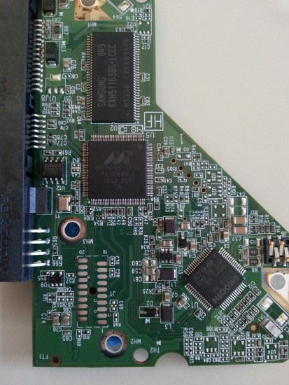

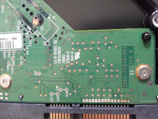

Here is now a picture of the SATA PCB (printed on the board as 2060-771640-003 Rev A, and labelled on the white sticker as 2061-771640-B03 AD) bottom side first

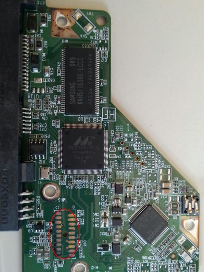

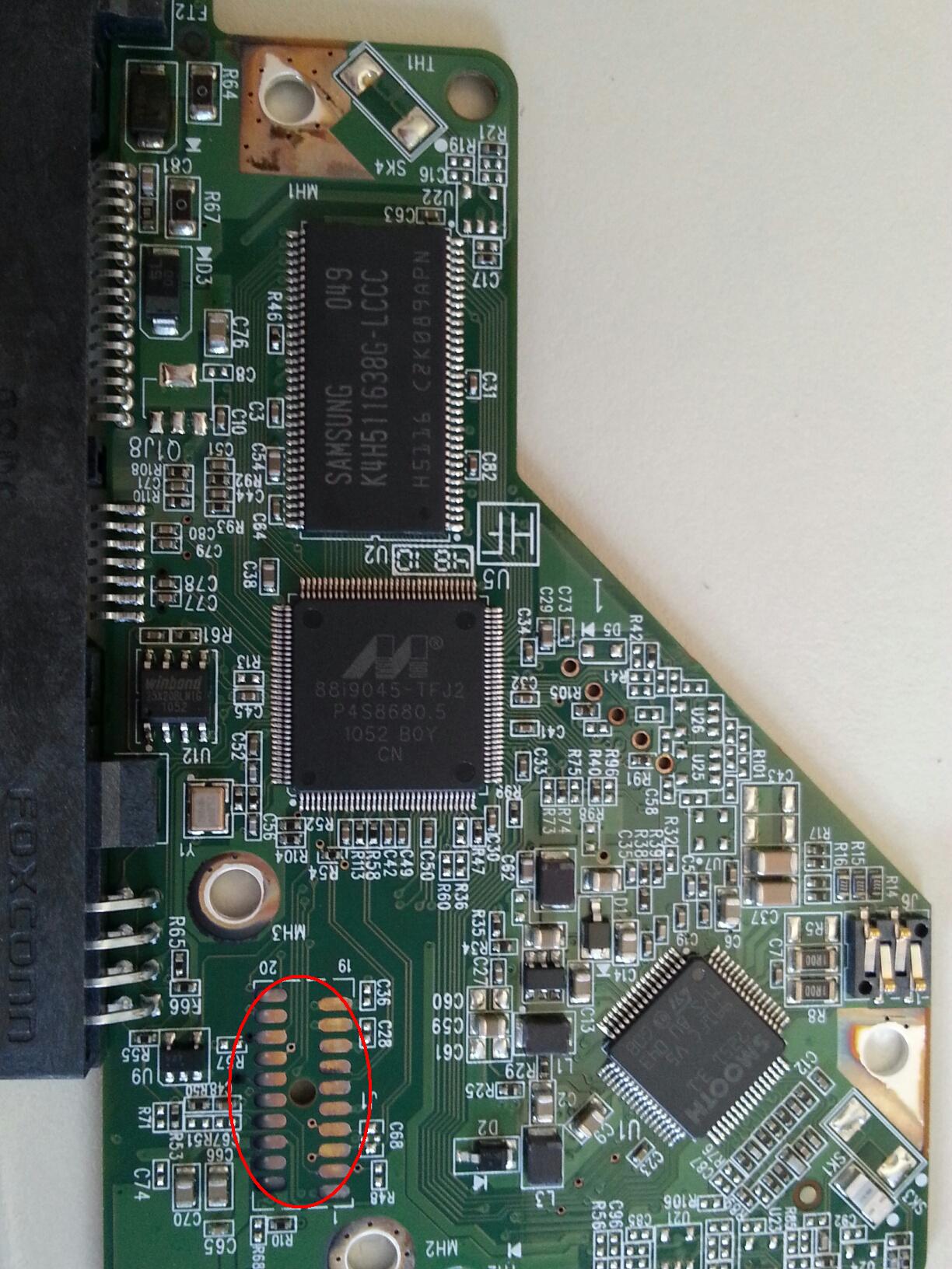

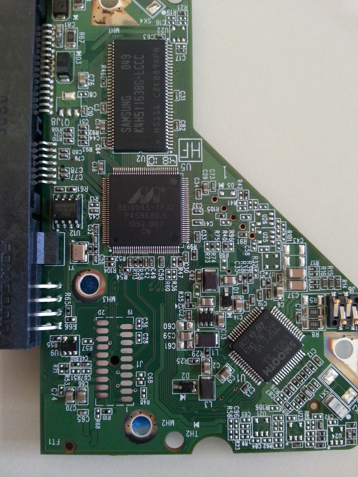

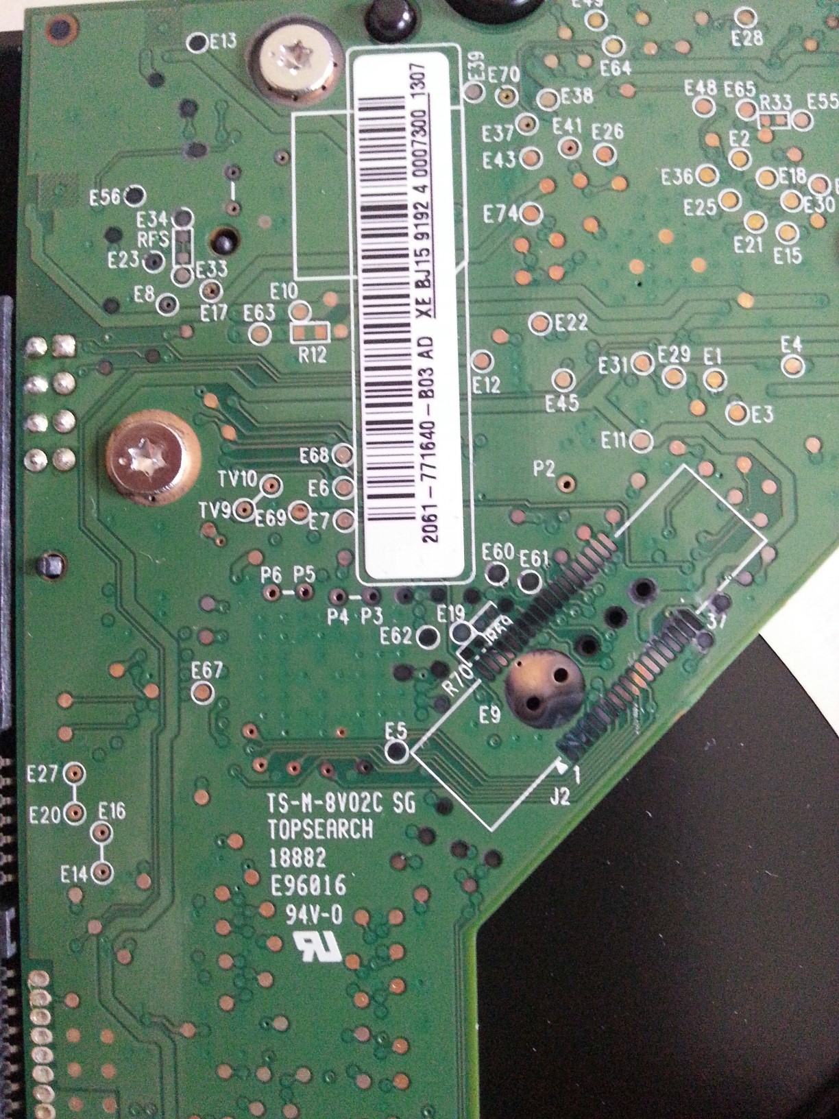

And finally the top side of the SATA PCB. To my "good" surprise I could see the U12 Chip on it. Which (if I learned well by reading all your posts) is the Rom of my HD. To my eyes the SATA Board (or at least the chips on it) are all OK.
No view of the disk itself. It contains no trace(s) of burned part.

Probably only My Book Essential pcb is burned, you have to change it.
The hard drive pcb should be ok if motor spins when connected inside the computer.
If you are going to connect the drive inside the computer (sata connection) then don't try to boot it in windows because without the eclousure it would not be loaded (due to hardware encryption) and you might do further damages (example initializing the drive).
To check if drive spins try to connect only the sata power cable (don't connect the data cable) and listen if it does spin sounds.

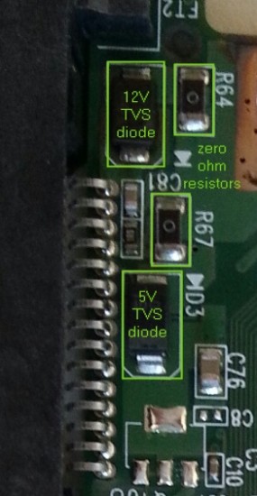

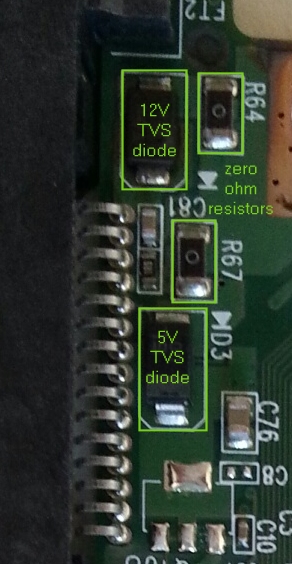

The burnt component on the USB-SATA bridge board appears to be a PWM controller for the +5V switchmode power supply. It appears that the +5V input to your HDD may have survived unscathed, but I would measure the resistances of the TVS diodes (D4 & D3) and zero ohm resistors (R64 & R67) just to be absolutely certain.

If I do it step by step. I believe it is safer to test first resistances of the TVS diodes before to test if the disk spin. I m right?
@ Fzabkar, what do I need to test it? a multimeter? and then, do I have to plug the SATA PCB to the disk? Or do I have to test it alone?

How to test TVS diodes - hddrepairing.com pdf slide 5
http://hddrepairing.com/downloads_n_vid ... airing.pdf
Regarding other question yes you would fit the SATA PCB to the hdd & only connect the power cable.

You can try to plug the sata pcb (without the drive) to the computer power sata cable and see if it does smoke.
If it smokes then stop, it would mean that the pcb is really faulty.
If the sata pcb does any smoke or any burn smell then power off the pcb and screw it again on the drive, then power on the drive and feel if it spins or not.
You might plug the power sata cable to the drive while the computer is already on but it's safer if you connect the power sata cable when the computer is off.
Don't do anything with the essential adapter pcb (the one with the burned chip), no need to test it because we already know that is faulty.

Hi Dick,
Petrol I don't have, I have white spirit, should it be ok too?
Which circuits points do I have to clean? those next to R70, E9, J2?
best regards
0383A
 Post subject: Re: WD Mybook Essential 1tb smoke
PostPosted: June 25th, 2014, 7:20
Posts: 1744
Location: Verona, Italy
Clean contacts marked by red circle with a pencil eraser:

Thank you Michael Chiklis, it worked well. Here is the result:
Kind regards
0383A
