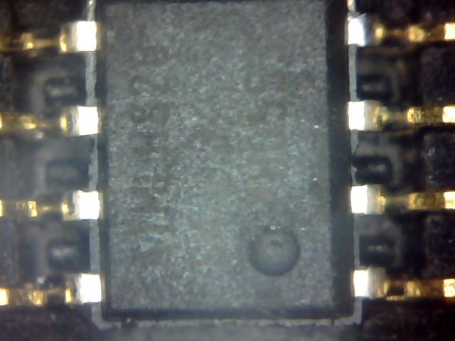

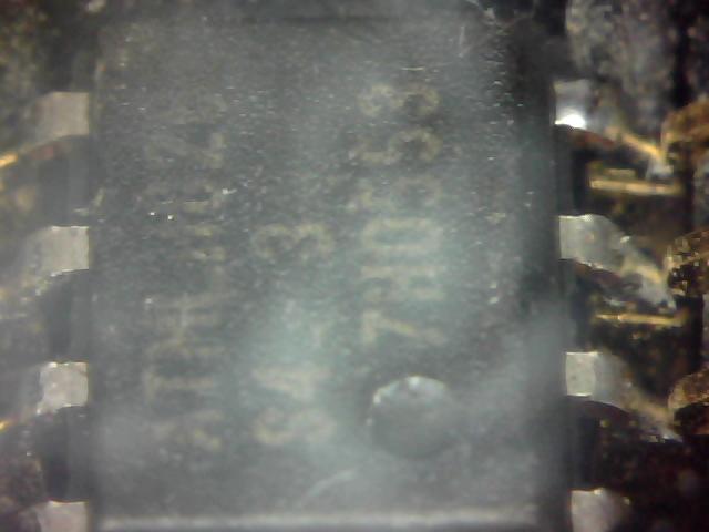

Here some pics of the rom chip, not clear bit i did the best i could:

The "7H0553" looks like it might be a batch code. AISI, the "53" discounts it as a possible date code.
Obviously it's an Atmel part. I think that the "S4" marking probably identifies it. I suspect that the "4" might mean that it is a 4-Mbit part, in which case there could be something wrong with the way you are reading it. Have you managed to get the part's manufacturer and product ID via your programmer?

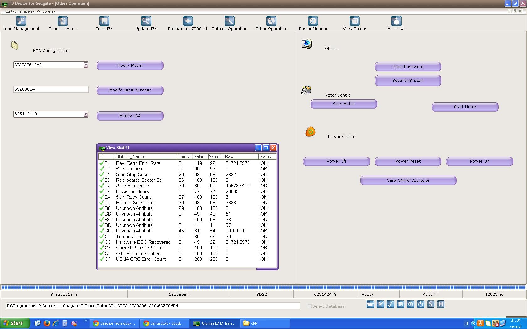

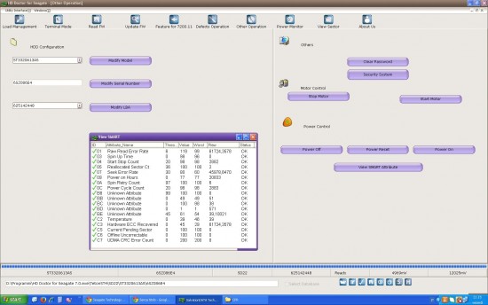

Who sold you the bad donor?
I got donor pcb from china shop.
Donor pcb is good, also rom ST25P40VP on donor pcb was good (i written on it the rom content of my customer and worked fine).
The only bad thing was the Atmel rom chip that i found on original customer pcb, this because DR company changed it, probably original rom was ST or Winbond
Terminal Log.txt [383.9 KiB]
Downloaded 971 times
