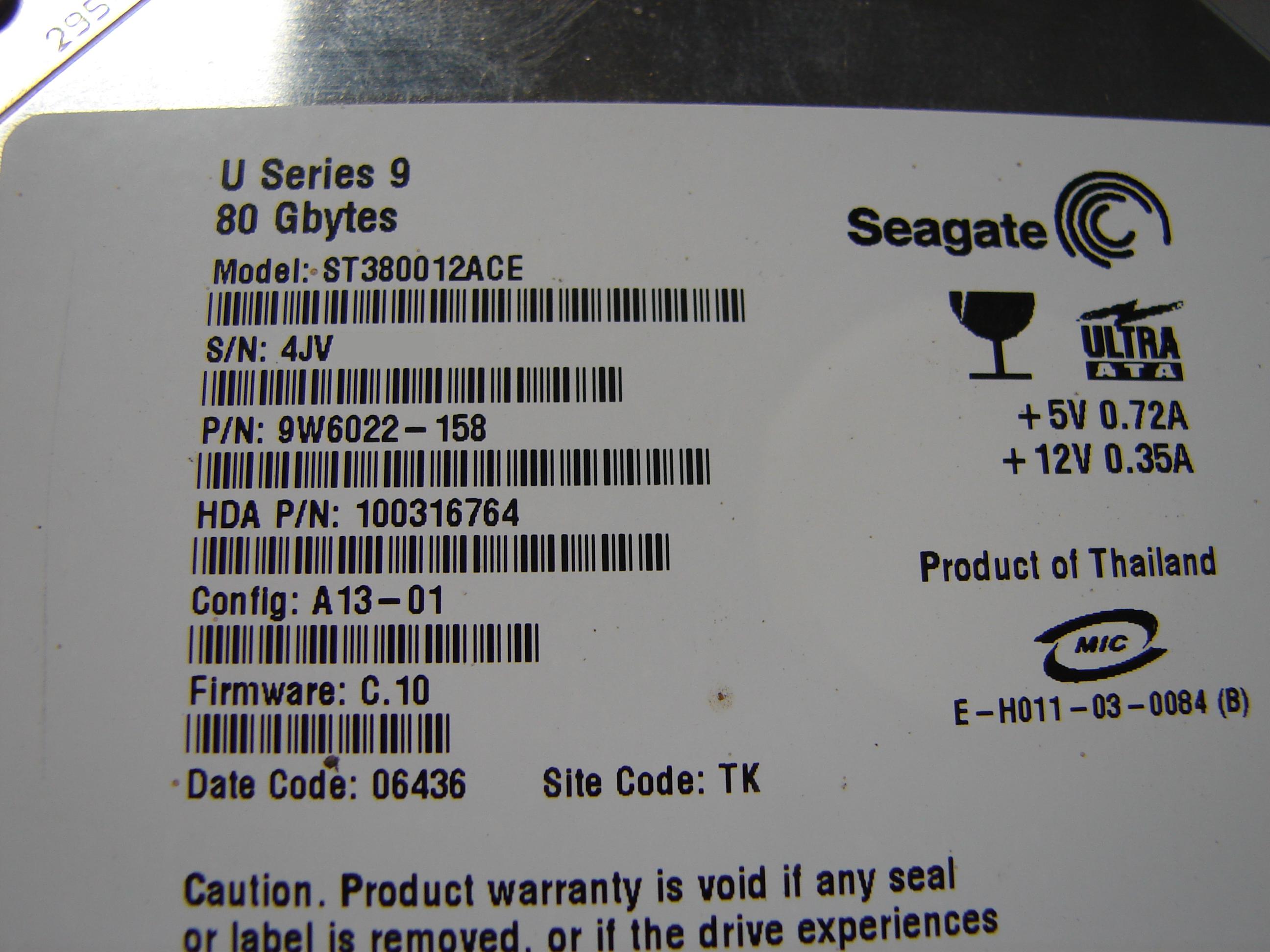

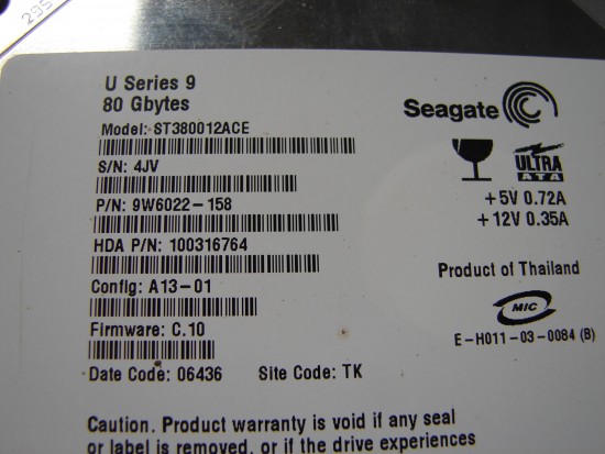

anybody know how to disable security on these drives?
thanks

On U9 you will have to erase pwd by editing vendor track sector 6 edit first two bytes to 00 .
