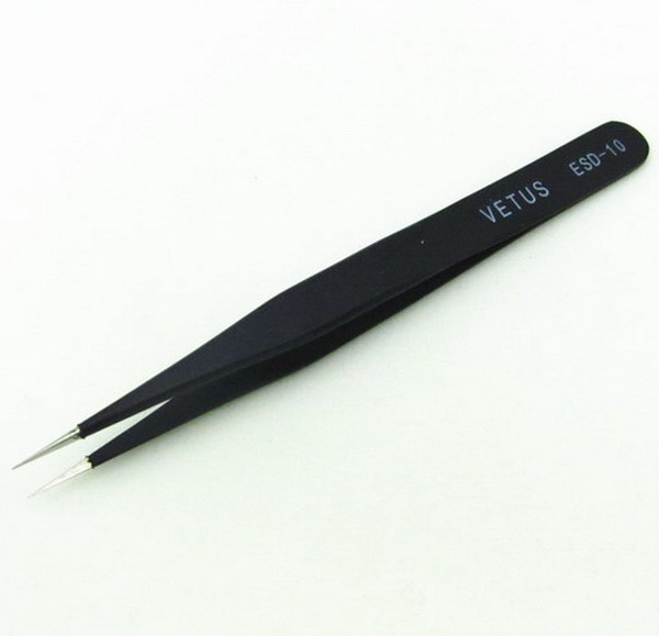

My trick is to use SOP8 to DIP8 adapter as this:
https://www.google.it/search?q=SOP8+To+ ... d=0CC8QsAQ
i insert the rom chip in the adapter, all rom pins will be connected to the adapter pins except the one that is broken, then i use thin tweezers with metal tips:
http://www.drivestar.biz/images/univers ... esd-10.jpg
with one of the tweezers tips keep touching rom stub pin and the adapter pin together to ensure electrical connection, then read rom with eprom programmer.
I read rom many times, 10 times for example, and save all on 10 files.
Then i compare all those files with Hex editor such as Hex Workshop to find if saved files are all same, if two or more are the same then means that very likely is a good rom read.
Hex comparing is needed because connection with tip twezeers is not perfect (you might have bad readings), you have to keep a steady hand while you read the rom.
After all you can write the good rom reading into a new rom chip by using the eprom.
