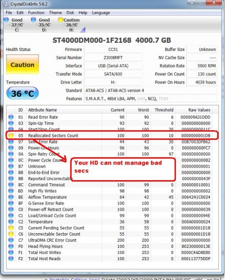

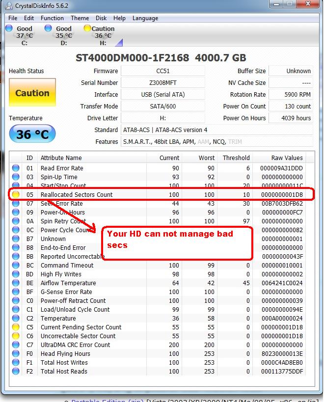

Smart report, crystaldiskinfo:
I'll post an update on how it went with Ubuntu later.

 Post subject: Re: Seagate External USB 4TB HDD Turns RAW
PostPosted: August 6th, 2014, 16:54
Posts: 17330
CrystalDiskInfo is indicating that your drive has significant media/head problems. Your best DIY chance would be to clone your drive with a tool such as ddrescue that understands how to work with bad media, and then use data recovery software on the clone.
You would improve your chances immensely if you could disable retries and reallocation as explained in the following thread, but you would need to remove the drive from its enclosure and connect to its serial diagnostic port.

Hi ZooBooBooZoo
fzabkar is on true; you need clone your drive as soon as posible because you have media/head problems, and maybe your HDD go worst.
see pic
