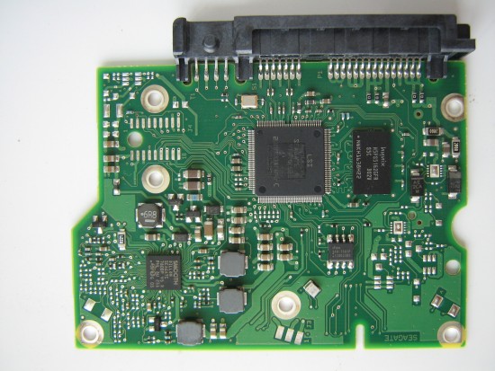

HDD produces its usual noise, no suspicious sounds. These errors during controller/buffer test make it believe that it's PCB failure, but no visual defects detected. (see attachment)
Is it possible to make suggestion about what's up with this HDD?
Is it PCB, firmware or mechanical failure?
Do you know any HDD Raw Copy program that can make copy of specified area (I mean pointing out starting and ending sectors). It may be helpful if copy operation is too long at can't be completed at once. Logging the numbers of sectors that failed to copy would be also great feature.

No pcb issue because you are accessing to sectors, if pcb was faulty you wouldn't access to sectors in Victoria.
Without any professional tools as DE or DDI i would start to clone sectors on a new drive via DOS utility as Mediatools Prosoft or DMDE.
TTL adapter can help for further inspection and for handling firmware issue as for g-list clearing (full g-list might case slow speed reading).
If after clearing g-list you still have slow reading speed all over platters surface then very likely would mean that some head is weak.

The "rubbish" seems to be the result of Victoria trying to process an Identify Device sector consisting of "BAD<space>", ie "42h 41h 44h 20h" or "20 44 41 42" (little endian).
For example, "LBAs: 541344066" corresponds to ...
541 344 066 = 0x20444142
deric wrote:
2) S.M.A.R.T. values seem to be OK (there's also a 4-5 seconds delay or just error without delay)
http://imgdisk.ru/images/2014/07/28/vic-smart.jpg
I don't know why you think the SMART values are OK.
The Reallocated Sector Count is reporting 2880 bad LBAs (probably 360 bad physical sectors).
Attribute 187 is reporting 439 Reported Uncorrectable Errors.
There are 40064 Pending and Offline Uncorrectable Sectors.
