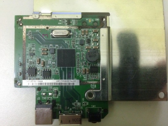

Hi, you most probably have a drive with heads issue.
If the drive spins up for 10-15 sec then spins down, then make a retry and after that spin down and stays down, then it's heads related…not a power problem.
And yes there is encryption as well.
Not a DIY case.

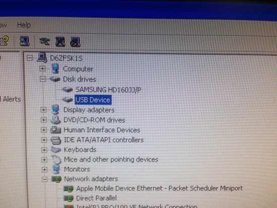

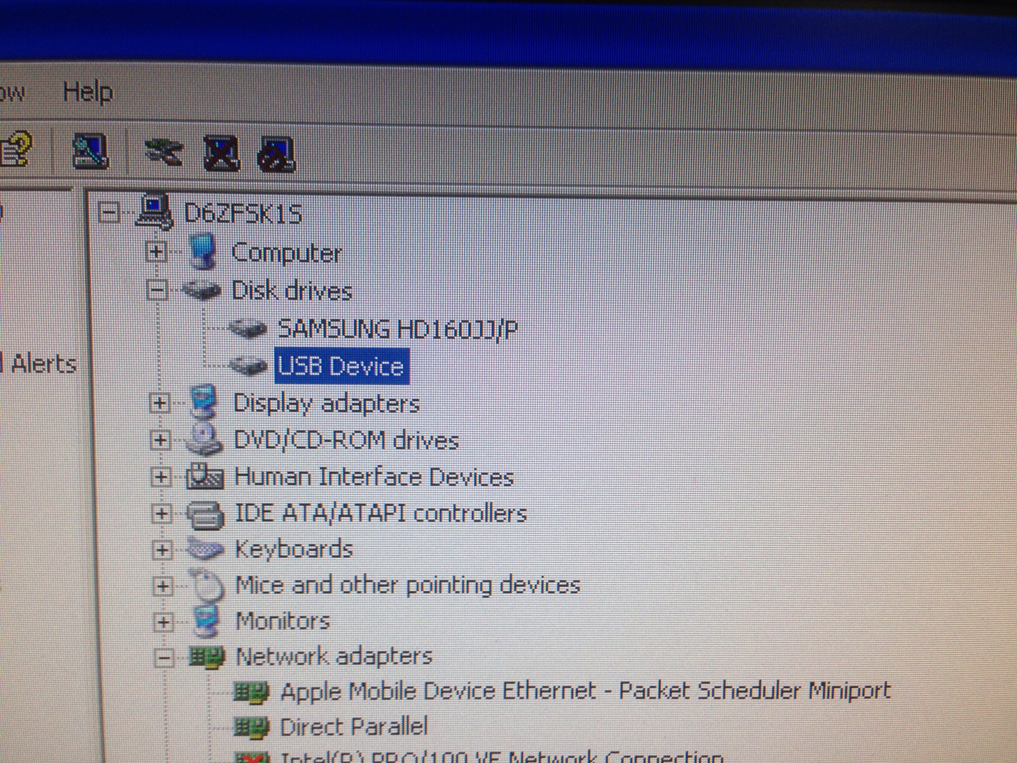

Post a picture of the drive being detected in device manager.

It could be a possible head issue or an insufficient 12V power on the bridge board interface.

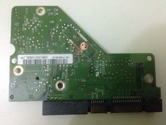

Hi! You could do a simple test by connecting a spare drive to the bridge board. Initialize and format it. Then write data to it and check to prove the board and usb interface are working. One thing to note is sometimes certain makes and drive models seem to require more power (amperage) than the power pack can provide. You need to methodically check this.

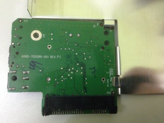

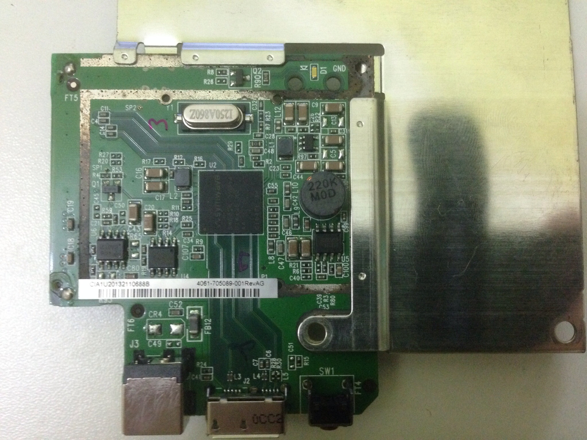

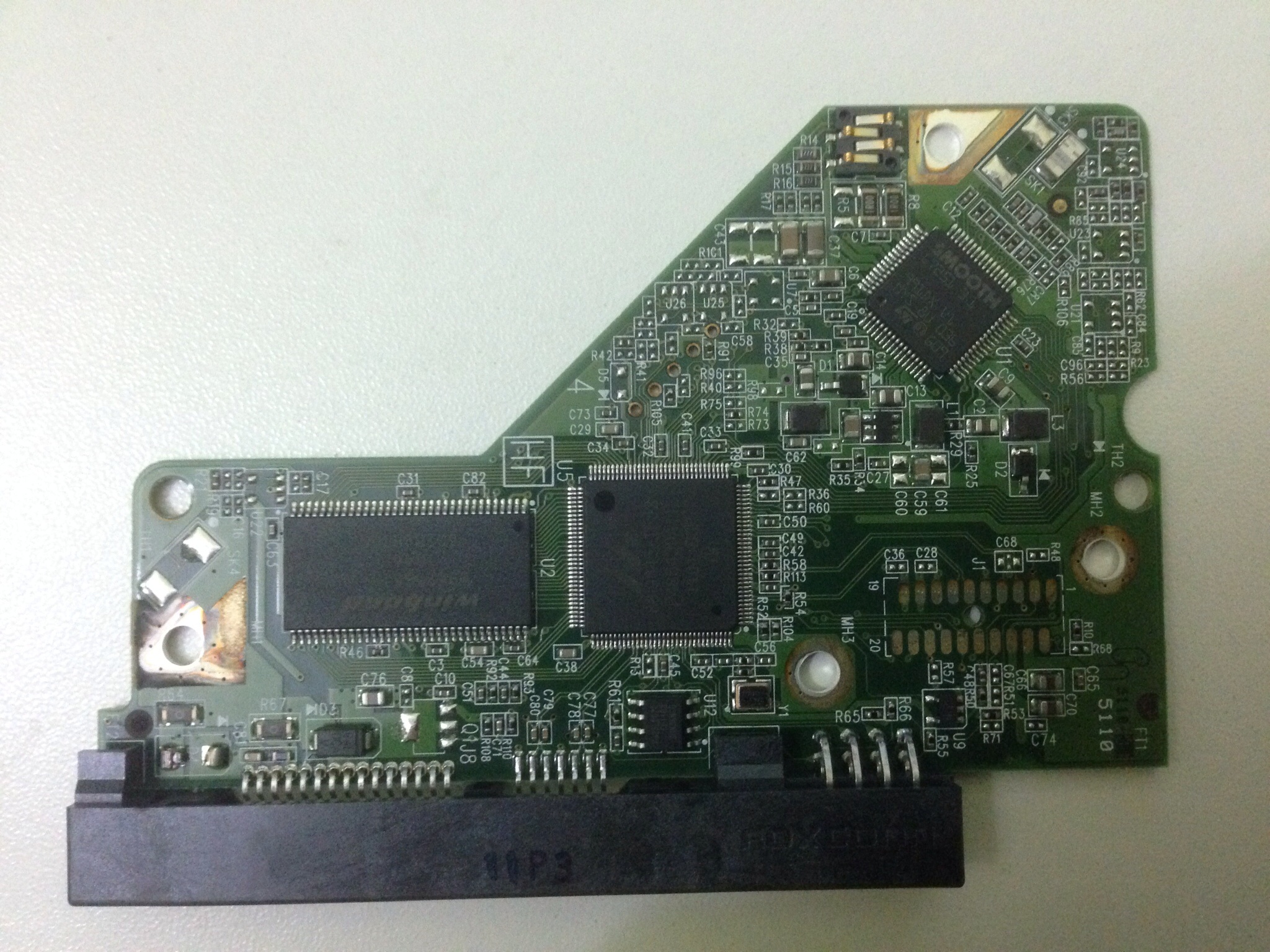

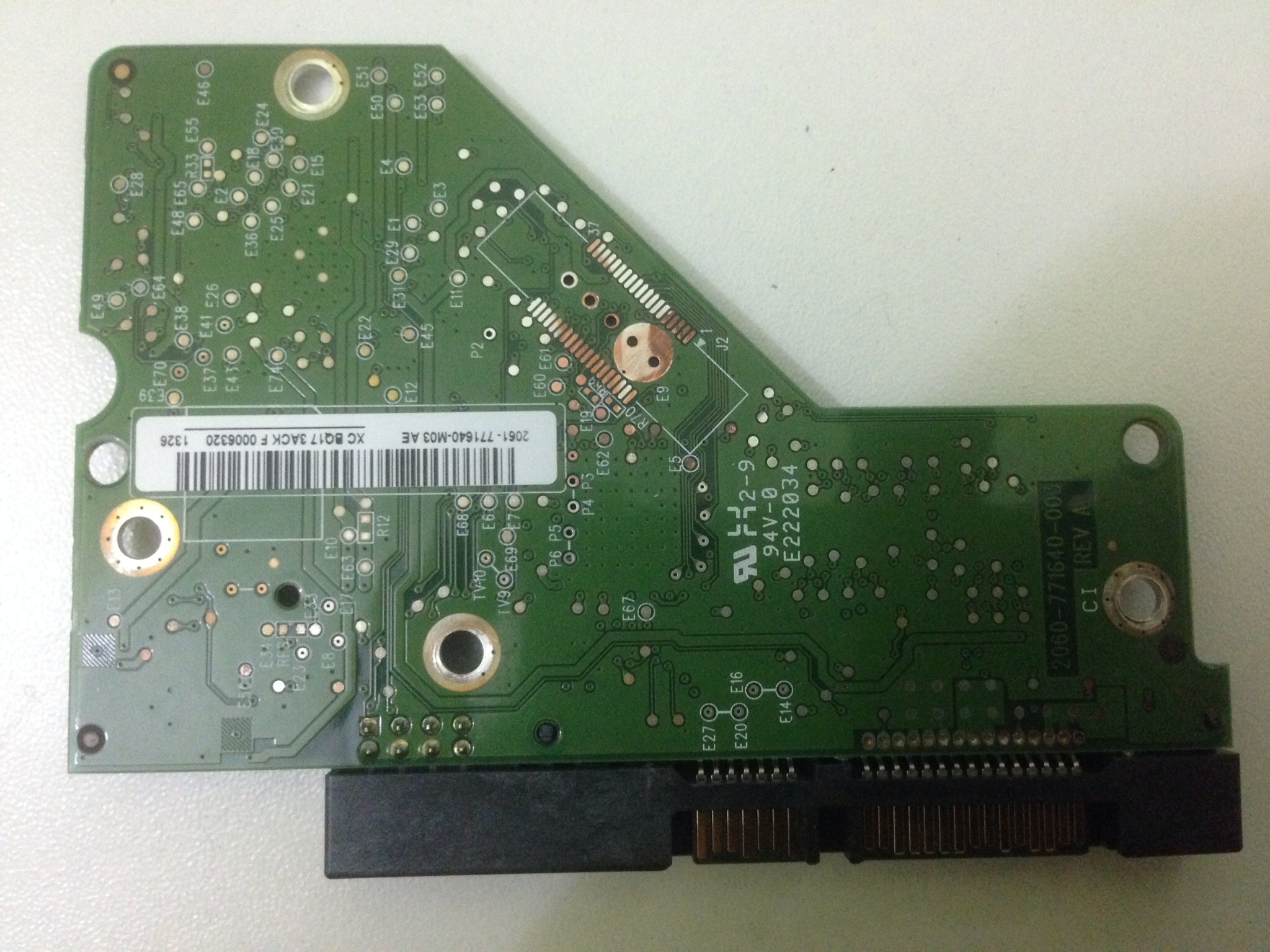

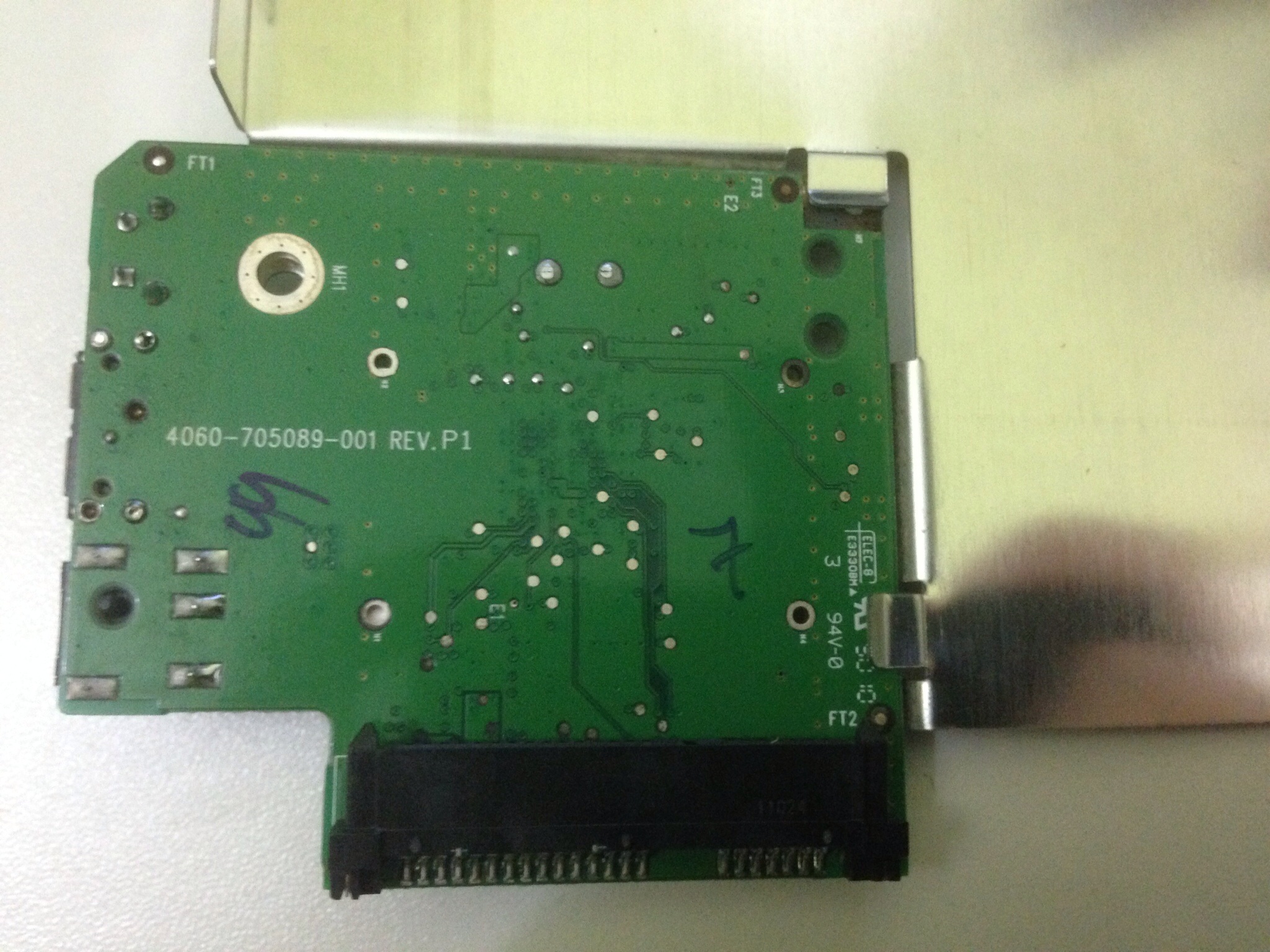

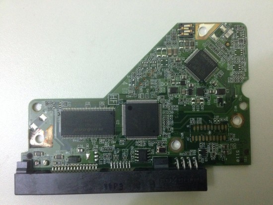

I'm also attaching photo of my PCB and bridge board for references.
File comment: Bridge board 2
File comment: PCB2
File comment: PCB
Hi, you can refer to my previous post with attachment. Thanks!

PostPosted: August 2nd, 2014, 18:03
unhappy_wd_user wrote:
If it is the heads issue as you mentioned, then why is the HDD detectable when I connect it without the bridge board?
The pic posted looks like drive is connected via the bridge.
Wanted to see what the drive shows up connected in Device Manager connected without the bridge per your question/wonder above.
 Post subject: Re: WD MyBook External 1.0TB - No longer detected!
PostPosted: August 2nd, 2014, 23:08
Joined: July 31st, 2014, 23:54
Posts: 34
Location: Singapore
The pic posted is when the drive is connected to my desktop by using SATA to USB cable without the bridge board.
If my HDD is detected in Device Manager while being attached to bridge board, then i will be a much happy man. Hahaha..
PostPosted: August 3rd, 2014, 1:30
You are misunderstanding the purpose of the test. Connect the drive via SATA port directly to your desktop. This way we can identify whether your drive works properly or not, hence rendering the bridge as the culprit.
