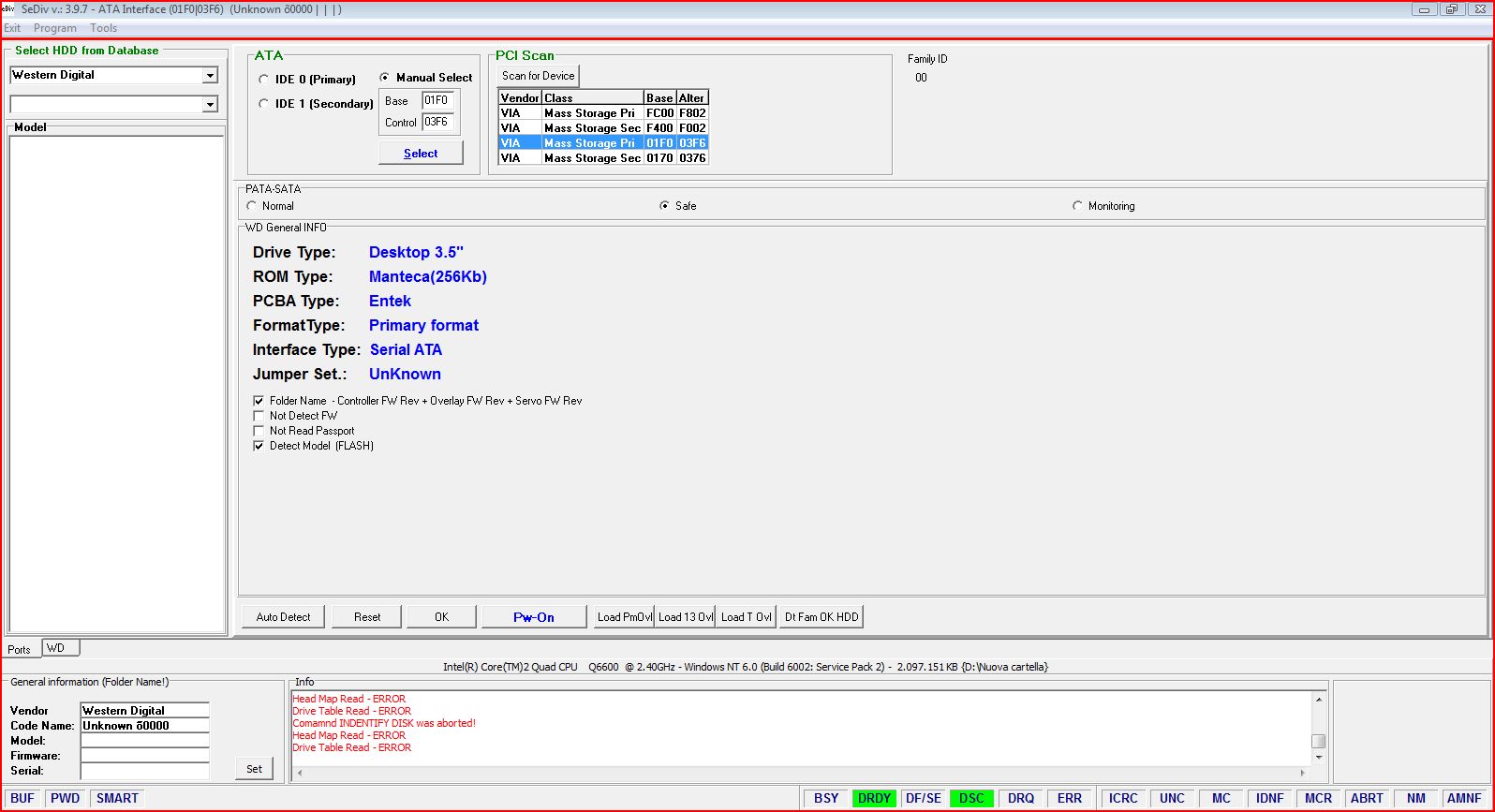

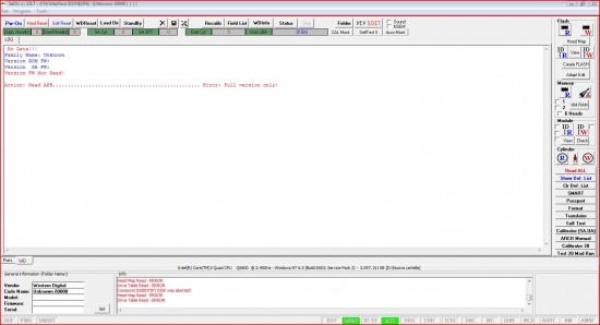

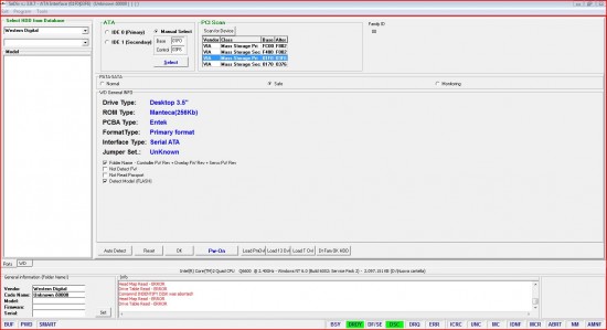

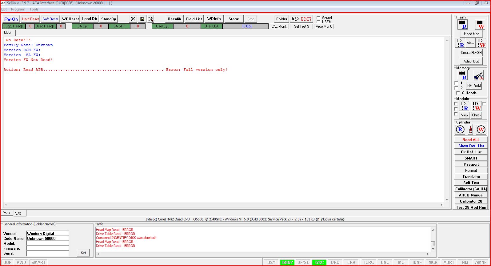

 Post subject: Re: hard disk size 0 but it spins !
PostPosted: August 9th, 2014, 7:41
Joined: August 7th, 2014, 10:04
Posts: 40
Location: Leghorn, Italy
The drive has a reserved System Area (SA) that contains various firmware modules. There is also some firmware in the flash memory on the PCB.
SeDiv (demo version) is a software tool that can read the above firmware. Many problems in WD drives are related to "damaged" SA modules, eg MOD 32.
I got and run 'SeDiv' software.
I cannot see SA and ROM modules.
What do you think?
Thanks for your precious help.
PostPosted: August 9th, 2014, 14:23
Posts: 396
Location: slovenija
hello zio_mangrovia,
if your mb have 4 sata connectors and your primary drive is on port 1, then connect your damaged drive to port2.
In device manager disable secondary channel.
then in sediv select secondary channel.
check botom links
follow following instruction http://sediv2008.narod.ru/Settings.rar
PostPosted: August 10th, 2014, 7:08
Posts: 40
check botom links
OK, I have only 2 SATA ports.
I'll set BIOS as you indicated.
So I will link damage hdd to 2nd port and in Windows I'll disable this port.
It's hard to read in Russian language this site: http://sediv2008.narod.ru
Can you suggest me suitable hot fan gun or electric solder to buy for PCB BIOS please?
