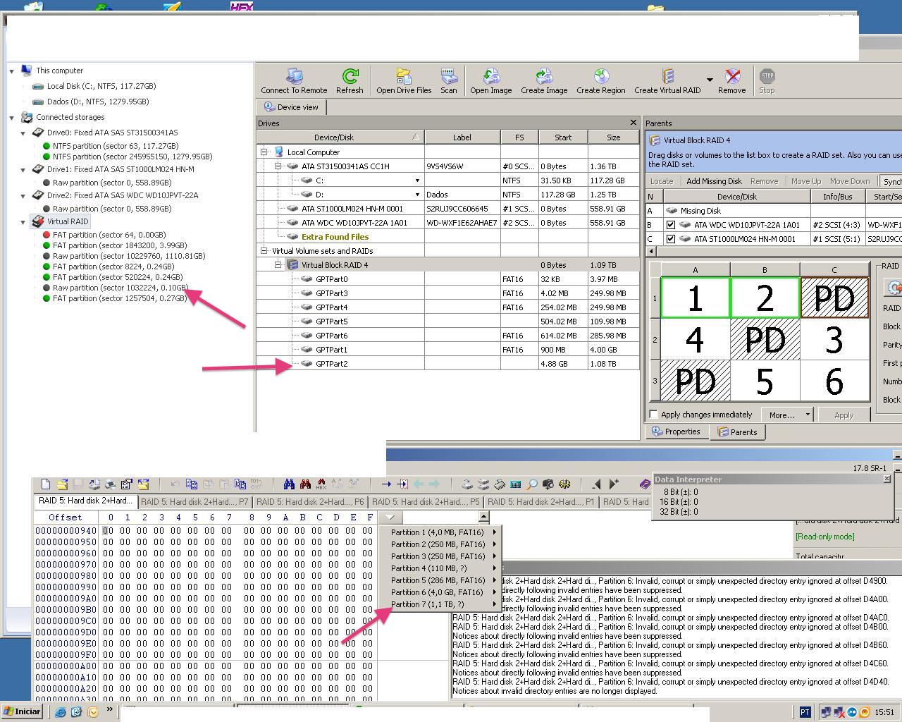

Hello to all!
Sorry!
I can not see the data on that partition ...
Please look jpg!
Thanks all helps!
:mrgreen:

 Post subject: Re: RAID 5 (3 HDDS) 2 HDDS GOOD
PostPosted: October 4th, 2014, 16:20
Try a program like UFSExplorer that recognizes XFS.

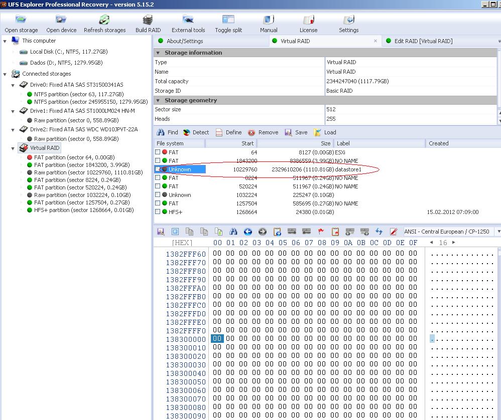

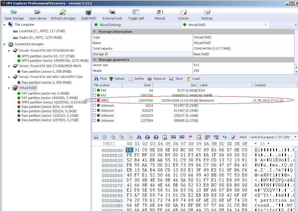

Hello!
is look part 3.jpg is stripe size 128kb no data is partition...
is part 2.jpg is stripe size 64Kb
PostPosted: October 6th, 2014, 5:45
Posts: 1091
Location: Angel Data Recovery
Matter not in stripe size which you can change and try, change and try.
Matter is in layout . Datastore1, datastore2 labeling of volumes by default , uses mostly in P800 and newer server models , there is not regular Left Synchr mode.
PostPosted: October 7th, 2014, 8:15
Posts: 1060
ok thanks all infos!
Solved!
100% data recovery!
:mrgreen: :mrgreen: :mrgreen: :mrgreen:
