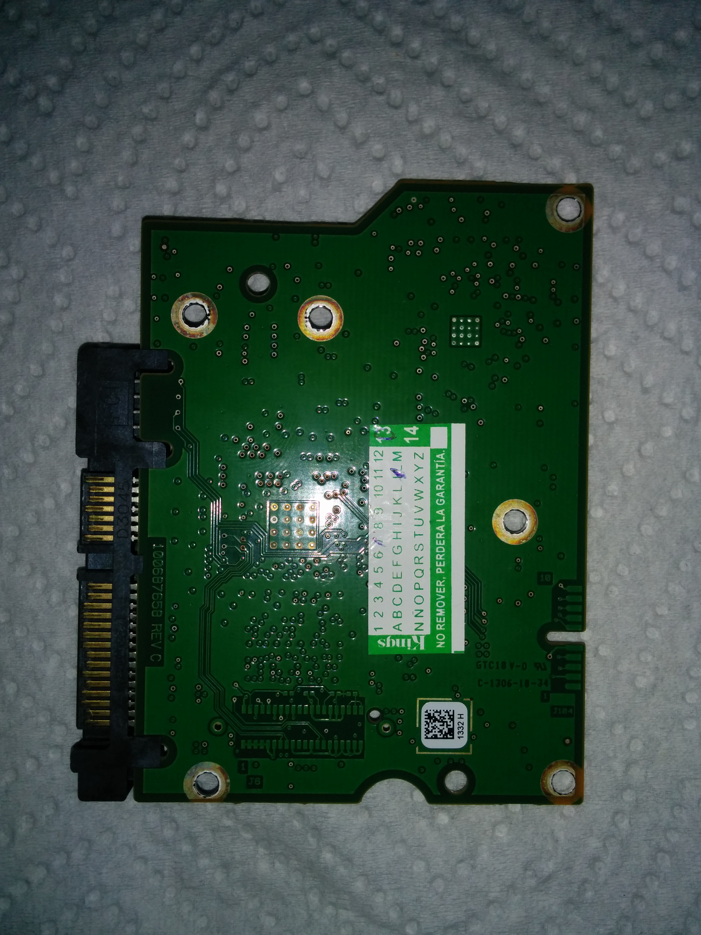

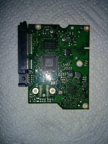

Hi guys!

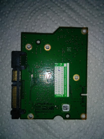

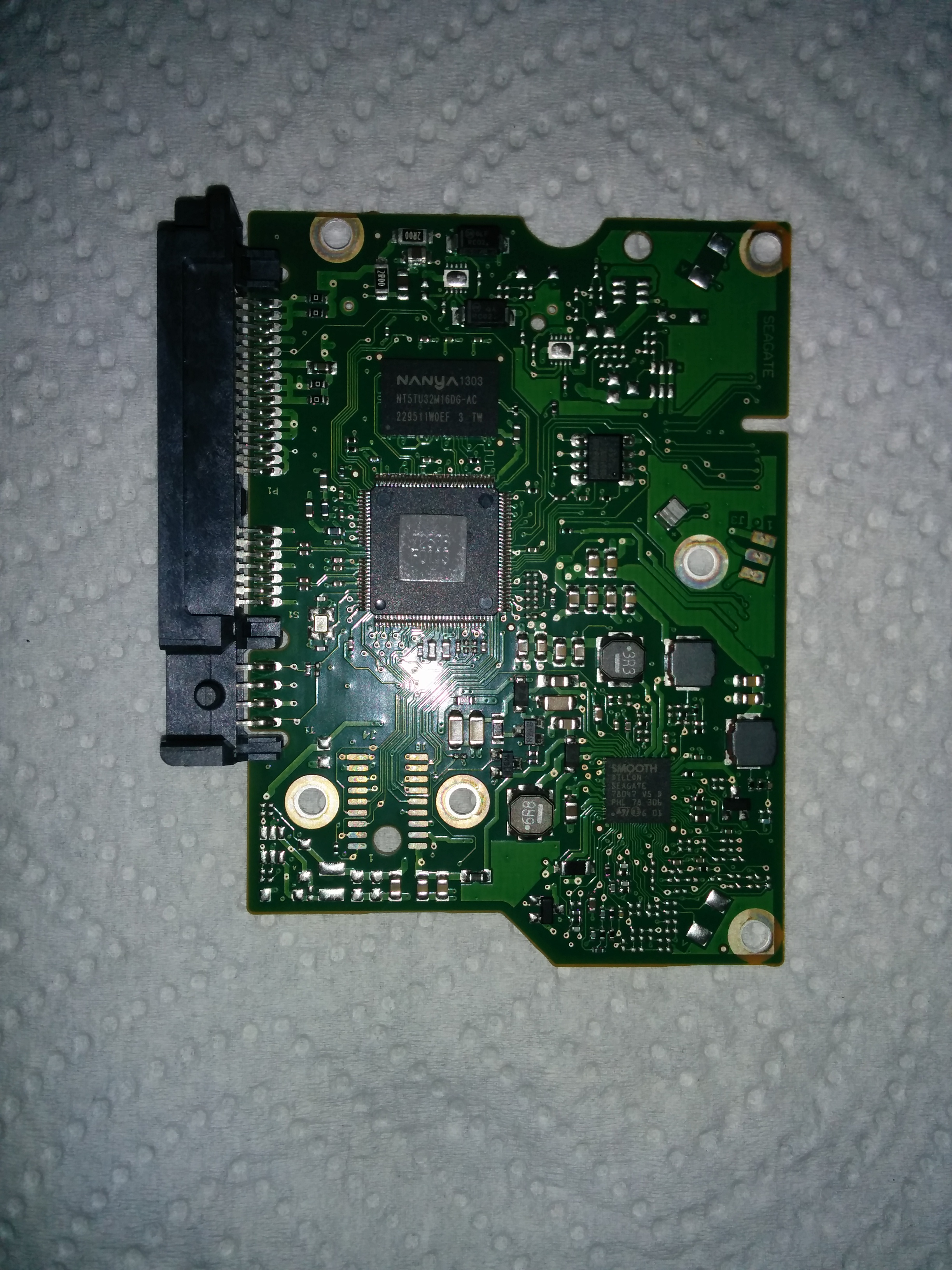

I rechecked everything and found that the jumper cable I was using was not doing a good connection. Anyway, now I can connect to the drive and access the ASCII Diag mode. I'm attaching some pics of the board and a screenshot of the terminal. Now I'm going to search the forums and look for some diagnostic procedure.
Thanks!

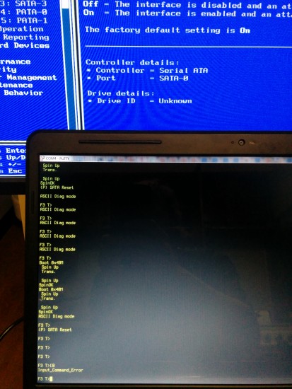

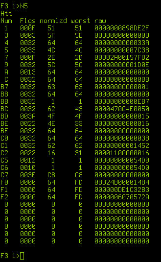

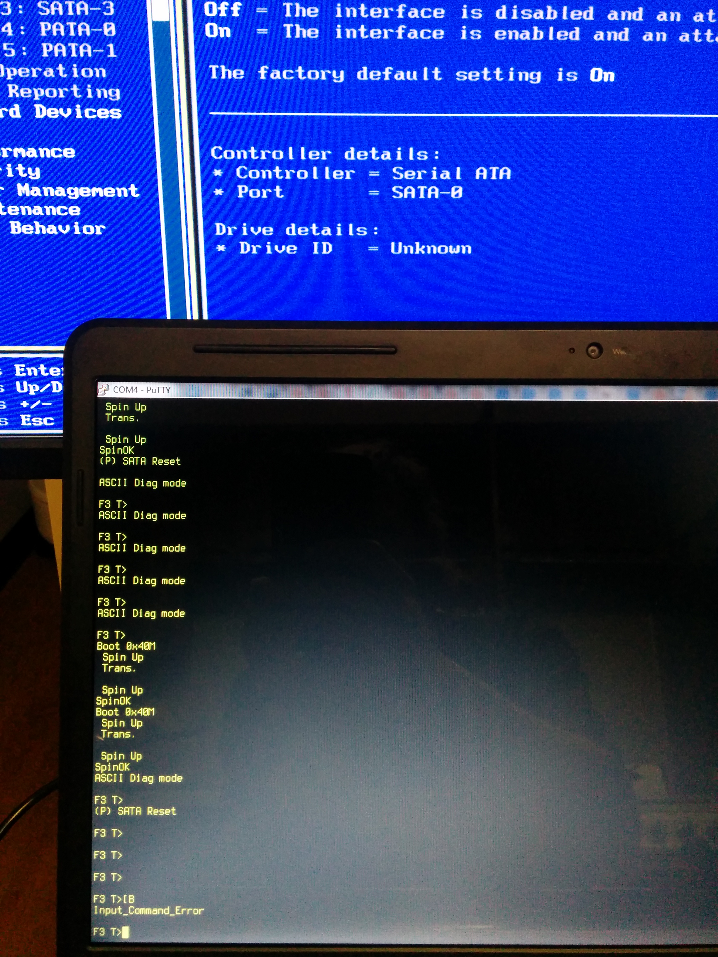

Ok.

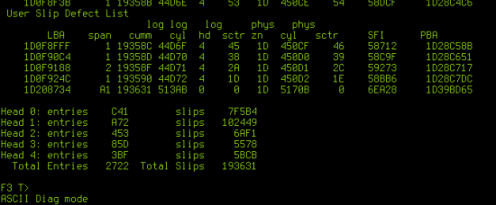

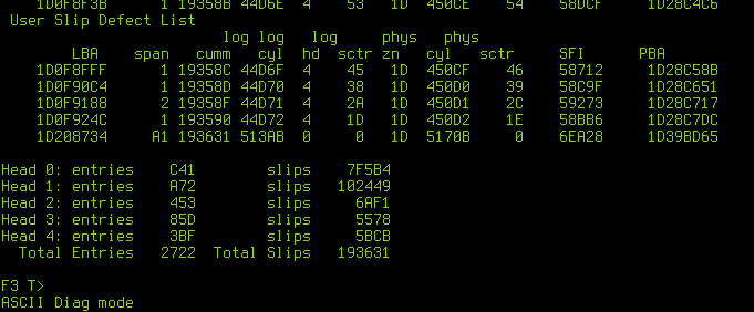

So I've been dumping the logs and g-lists. V1 and V3 have excessively huge lists. V4 gives a big list and then just gives a Diag error. The SMART attributes look high also. So I guess the hard drive is a very bad shape.
What I really don't understand is why is the BIOS not recognizing the drive? If it is only bad sectors, why is the drive not being seen?
I'm attaching some screenshots.

 Post subject: Re: Seagate ST2000DM001
PostPosted: August 18th, 2014, 21:27
Joined: August 14th, 2014, 23:49
Posts: 6
Location: East Lansing - USA
So, I managed to get the first lines from the V4 output before the DiagError 0x27 kicks in. I see there are a lot of reassigned sectors and there are a lot pending.
F3 T>V4
Reassigned Sectors List Enabled
Entries: 3A99, Alts: 0FF2, Removed: 0000,
Pending: 2AA7 Host Pending: 5538
PostPosted: August 19th, 2014, 0:29
Posts: 285
Do not try the 7200.11 fix commands or other commands without properly understanding the problem with your drive.
your drive may have firmware (or heads) issue, if data is important do not randomly try terminal fix commands. you will make matters worse. A pro will be able to get your data safely without much cost either
Read the forum for problems due to 7200.11 fix commands tried on these drives
F3 7>X for testing heads
F3 T>V40 will give you the NRG list

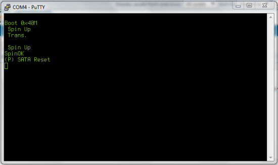

PostPosted: August 31st, 2014, 19:30
Joined: August 31st, 2014, 19:23
Posts: 22
Location: Bay Area
Hi despedes,

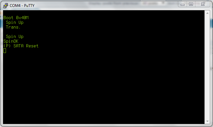

I am trying to diagnose the very same hard drive with firmware CC24. It was in a stationary DELL workstation, never got moved, is less than a year old. At one point during a reboot the BIOS hang up and could not recognize the hard drive anymore. I am trying to understand what happened and if there are chances to recover some data.
I have successfully connected to the terminal. I can not reach the F3 prompt via CTRL-z though.
Output (putty) is:
C!¨ë0x40M
Spin Up
Trans.
Spin Up
SpinOK
(P) SATA Reset
There it stops.
I can see in your first "success" post that you got to the same point. In the next post you add logs etc.. How did you get to the prompt? Did you take any further steps after diagnosis?
Thanks for your answer.

ghandi wrote:
C!¨ë0x40M
It's what you get with Prolific PL-2303HX bridge cable, before modification with diode an resistor (don't remember if I could get prompt or not). But after modification, all is fine with ST2000DM001.

ghandi wrote:
Surprising to me though as the PL-2303HX can handle 1.8V according to the spec sheet! I measured the HDD tx/rx voltage and I confirmed it is 1.8V.
Pin #4 of the chip (VDD_325) is the "Power Supply for Serial I/O Pins". Ideally it should be powered from a separate supply, in your case +1.8V. A 2.5V supply will probably be OK.
I suspect that most designs simply loop the device's 3.3V output pin (VO_33, pin #17) back to the VDD_325 pin. This means that the device defaults to using its own internal 3.3V regulator for the serial I/O.
If I had a bridge based on this chip, I would modify it by adding 2.5V and 1.8V LDO regulators, and use jumpers or a selector switch to choose between the 3 possible supply voltages.
