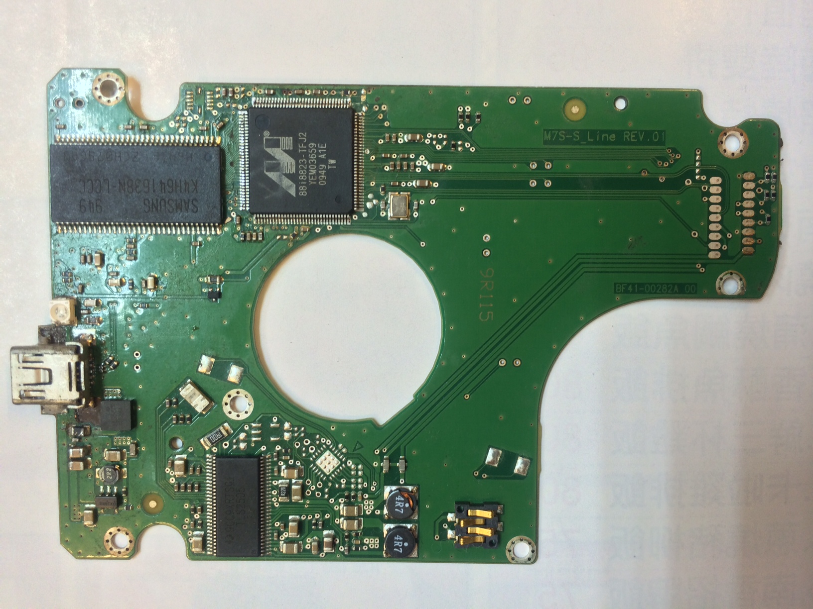

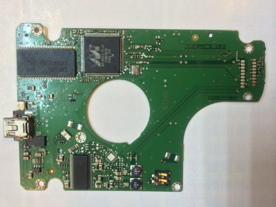

I'm not sure if I can fix the PCB, cuz it's in a very bad condition.
The MCU has been removed before.

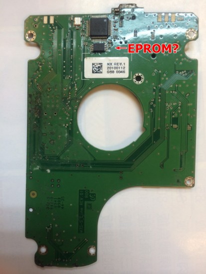

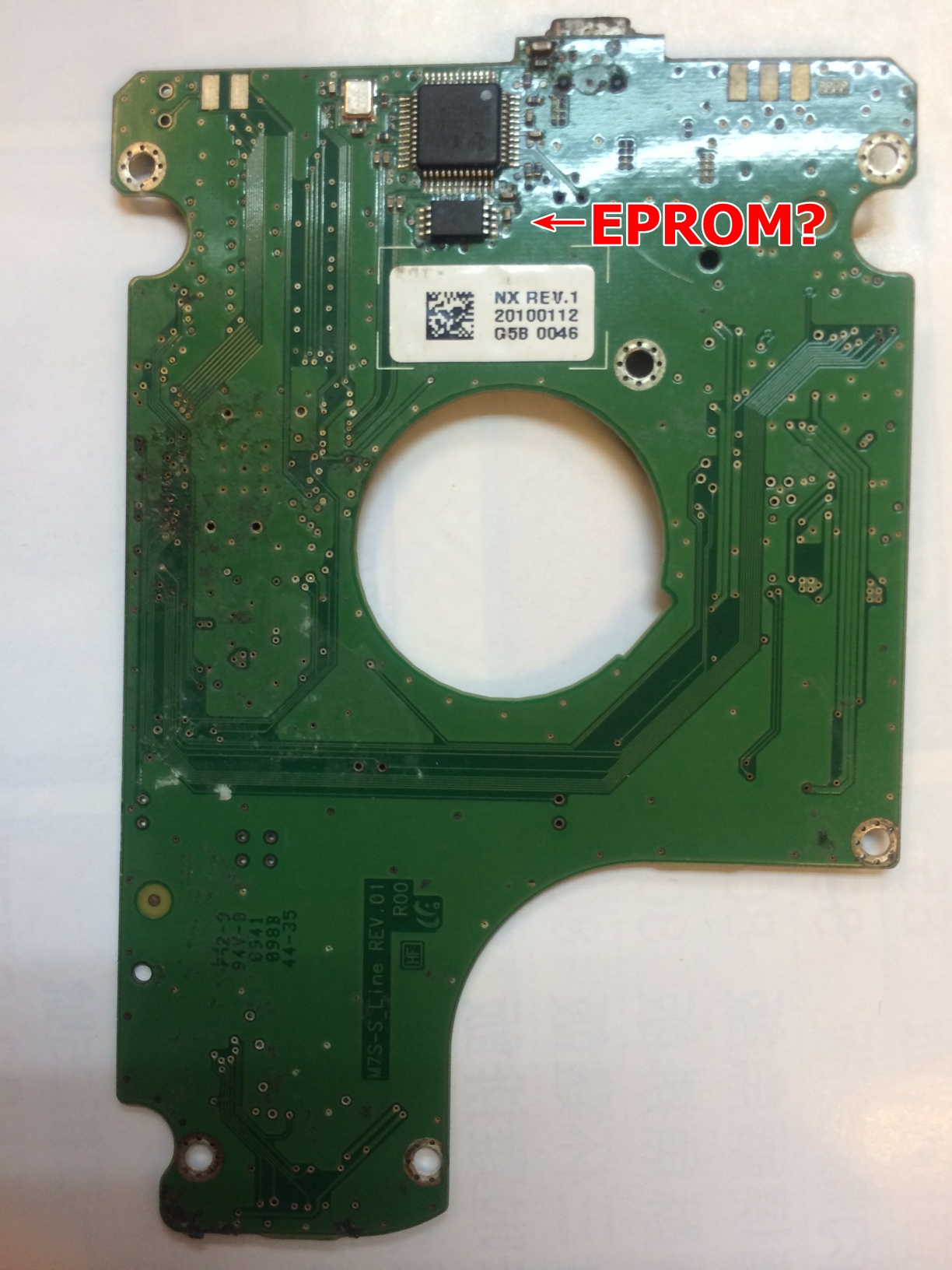

I wonder if the chip on the back with 8-pin is EPROM or not?
Havent try it yet. or should I swap the MCU :shock:
Thx for helping

The EEPROM on the underside is associated with the bridge IC. It doesn't need to be moved. The HDD "ROM" code is embedded within the Marvell MCU. BTW, it doesn't look to me like the MCU has been replaced. If it has, then it's a very neat job.
As for the damage (?) around the USB connector, ISTM that a decent tech should be able to clean it up.
What were the original symptoms? Did the drive spin up? Was it a USB detection issue? Can you measure the voltages at the 4R7 coils? One coil is slightly damaged, but it may still be OK.
If you are unsuccessful with your repairs, and if the drive still spins up but is not detected, then you could try converting the drive to SATA. This will bypass any defective bridge circuitry.

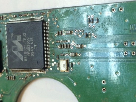

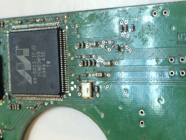

fzabkar, thx for reply
here's a closer picture, the MCU is floating :?
I don't know what happened before I get this drive, but I guess it was a fw problem or just not spinning.
I've converted the drive to SATA interface, it's not recognized as well, stayed BSY.
Luckily, it spins up without noise.
And the log in terminal was attached above.

As for the MCU, its date code is "0949", and this matches the "949" on the SDRAM. It's not conclusive proof, but it would suggest that the MCU is native.
