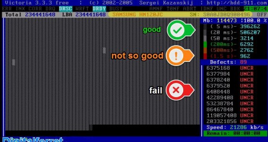

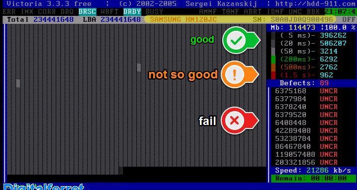

maybe grab a hard disk test program, such as MHDD or Victoria, that boots and runs from CD (ie before Win starts up).
You can d/l from the files section of this website or check google for multi-tool utilities like Hirens boot CD or UBCD.
Use with care.
If you start to see multiple errors close the program and take appropriate action to get data back, if needed, as HaQue mentioned.
Kern
