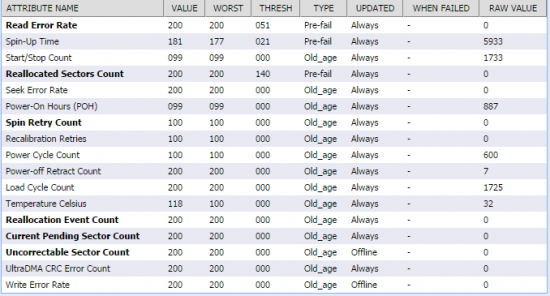

Hello
I'm using Flexraid as a raid and pooling software.
As of late I have had a few issues with a disk suddenly disappearing and wanted to check it to make sure it's still fine or if it need replacement. Also it would be good knowledge to have for the future :)
I was directed to hddguru by the good folks on Flexraids forum.
I'm really new to all of this HDD checking - normally I would just get a new one, but money is a bit tight and some of the other HDD's are bought at the same time, so I want to make sure none of them are affected. Also I want to be sure before I send it in for RMA, or it could add another bill.
I have tried to look around but guess I'm searching incorrectly - so hoping a kind soul would point me in the right direction or explain how to do a proper check on the disk(s).
I tried SMART, and as far as I can see it's telling me there are no errors found - but was told that could be misleading.
Thanks in advance

Hello again and I really appreciate all the help.
einstein9: Thanks for the PM, but I think that is a bit out of league to do - then it would be better to do RMA, if I can prove the error.
Daenerys_WD: I have talked with Flexraid support. They told me this was an issue outside there software and kindly referred me to this forum. Which was nice, as it has shown me the Internet is still filled with amazing people :)
labtech: What kind of testing if I may ask, to be sure if it's? I will follow your advice and run WD software a few more times, and properly HD Tune Pro - still can't figure out how to properly setup HDDScan.
I couldn't copy the numbers out from WD's software, so this is from the SMART module in Flexraid.

Drive looks healthy based on SMART values.
Also, I would have expected some other errors had the SATA cable been an issue. So, not sure what else to suggest at this point that would not be too complex and potentially ruin the current set up.
