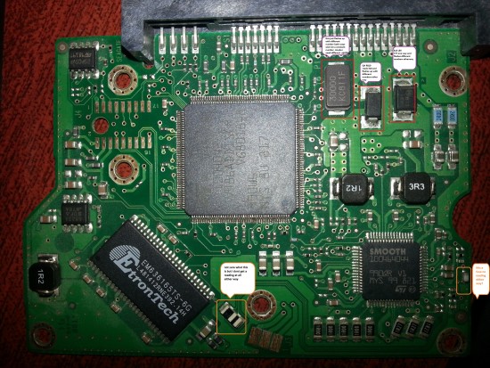

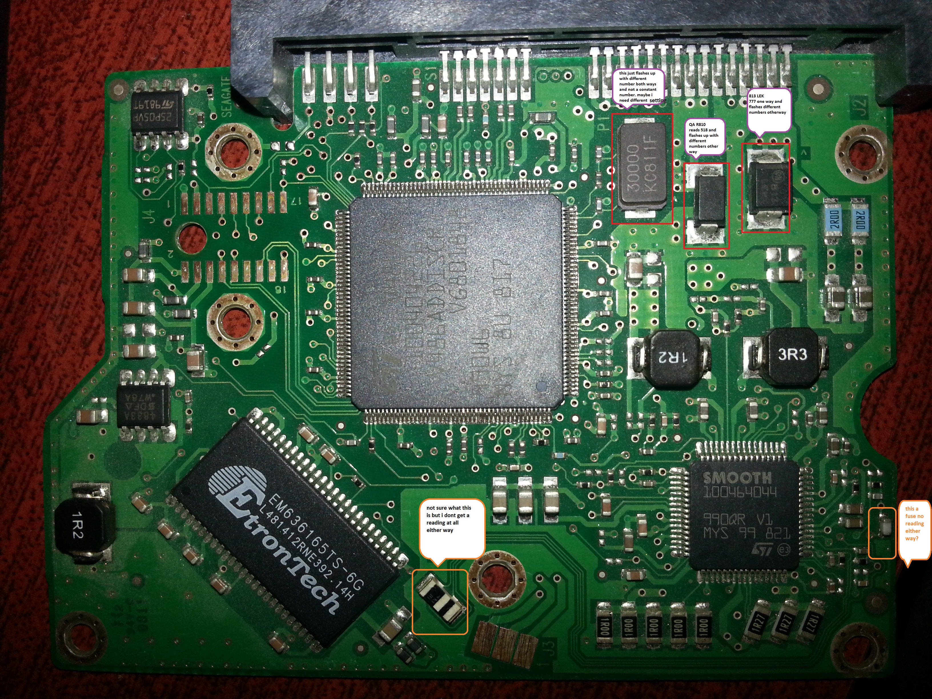

hey. i have a seagate barracuda 7200.10 160gb
ST3160215AS
firmware 4.AAB
When drive is connect disk is not spinning and im getting a high pitch sound coming from pcb board. i have tested some diodes and i think they are ok. Can anybody give me some pointers please ill try upload picture with what i have tested and results i got
hope you can read text on picture
thanks

The "30000" component is a 30MHz crystal.
The white component near the EtronTech SDRAM is a shock sensor.
See http://hddscan.com/doc/HDD_from_inside.html
AIUI your model can be repaired with a straight PCB swap, provided that the firmware is a match. Otherwise you might need to transfer the 25P05VP flash memory chip at the top left corner from patient to donor.

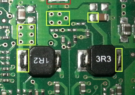

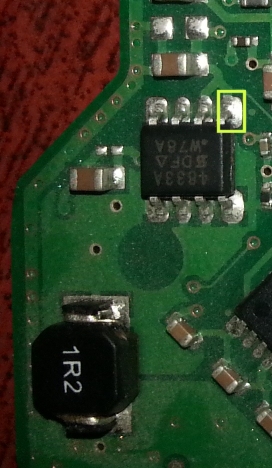

I would measure the resistances between ground and each of the 1R2 and 3R3 coils above the SMOOTH chip. Assuming that neither is shorted, I would then power up the board and measure the voltages at these same two points. I would also measure the voltage at pin #1 (nearest the dot on the PCB) of the 4833A chip near the SDRAM.

hi thanks for reply. when you say "measure the resistances between ground and each of the 1R2 and 3R3 coils" do i put multimeter on diode setting and just touch a ground point copper ring around screw holes and then test both ways on diodes.
Im abit of a noob when it comes to this but can you tell me which ground to use and i take it i use black lead for this? then i will post results

not sure if im doing this correctly but ive put black lead on ground and then tested the diodes both ways with the red cable and im getting
3R3 reads 540 &542
1R2 next to 3R3 reads 046 & 046
1R2 000 and 000 bleeps boths ways
thats if im doing it correctly

ISTM that the 46 ohm reading may be a bit low but it could in fact be OK.
The 0 reading for the second coil (they're not diodes) is to be expected because the coil is grounded on one side.

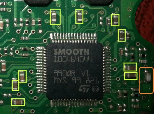

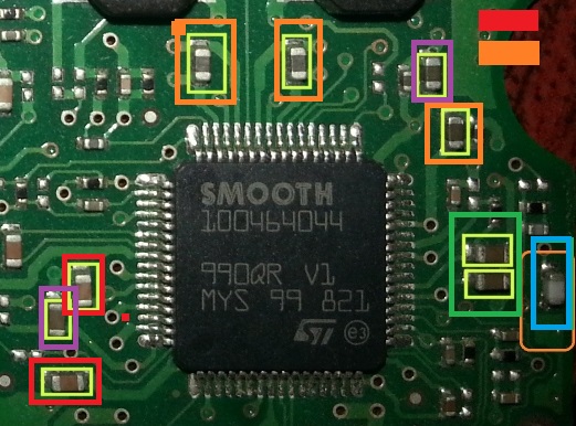

red 1's = 12v
orange = 5V
green = 3-4v
blue= 2.8v
and the purple ones i get no reading at all
thanks
EDIT: that chip does get abit warm

I'd say that the SMOOTH chip is dead, in which case there would be no economical way to repair the board.
