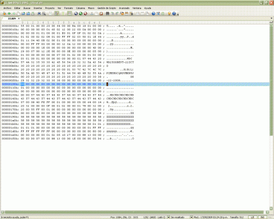

Please can someone helpme, a can´t unlock my hdd here is mi .bin its a western digital.
P,d- sorry for my english

Thank´s for read mi problem, the probles are:
When i connect the hdd to pc a can´t see, no format, no low level format.
In HDAT2 appears "The device is locked in max"
ZU "No unlock"
Victoria "No unlock"
I can´t read nothing, i think is the MBR but don´t leave me read.

kratoz3 wrote:
The HDD is a WD Scorpio Black model WD2500BEKT-75PVMT0.
MOD 02 is showing a model number of WD2500BEVT-22ZCT0.
Can you read the drive's firmware modules using SeDiv?
http://sediv2008.narod.ru/Easy3.9Passwo ... 567890.rar
Did you use HDDHackr on this drive?
