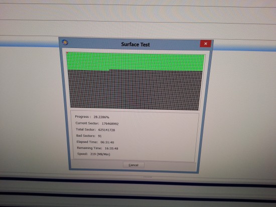

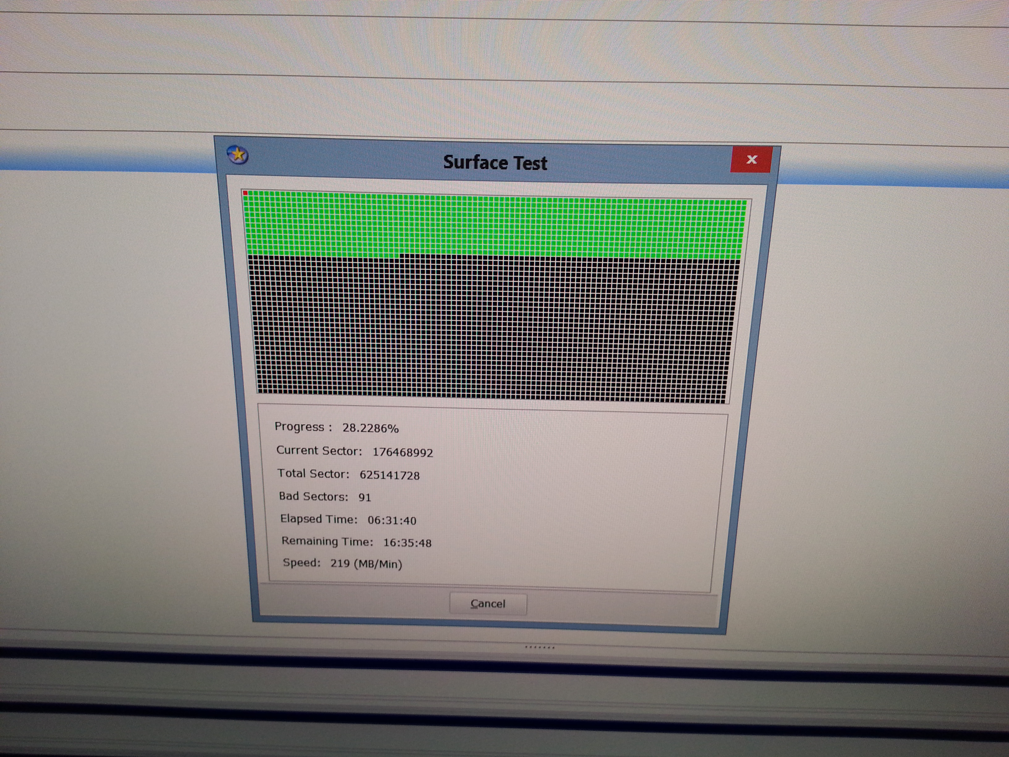

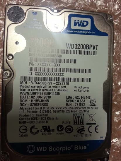

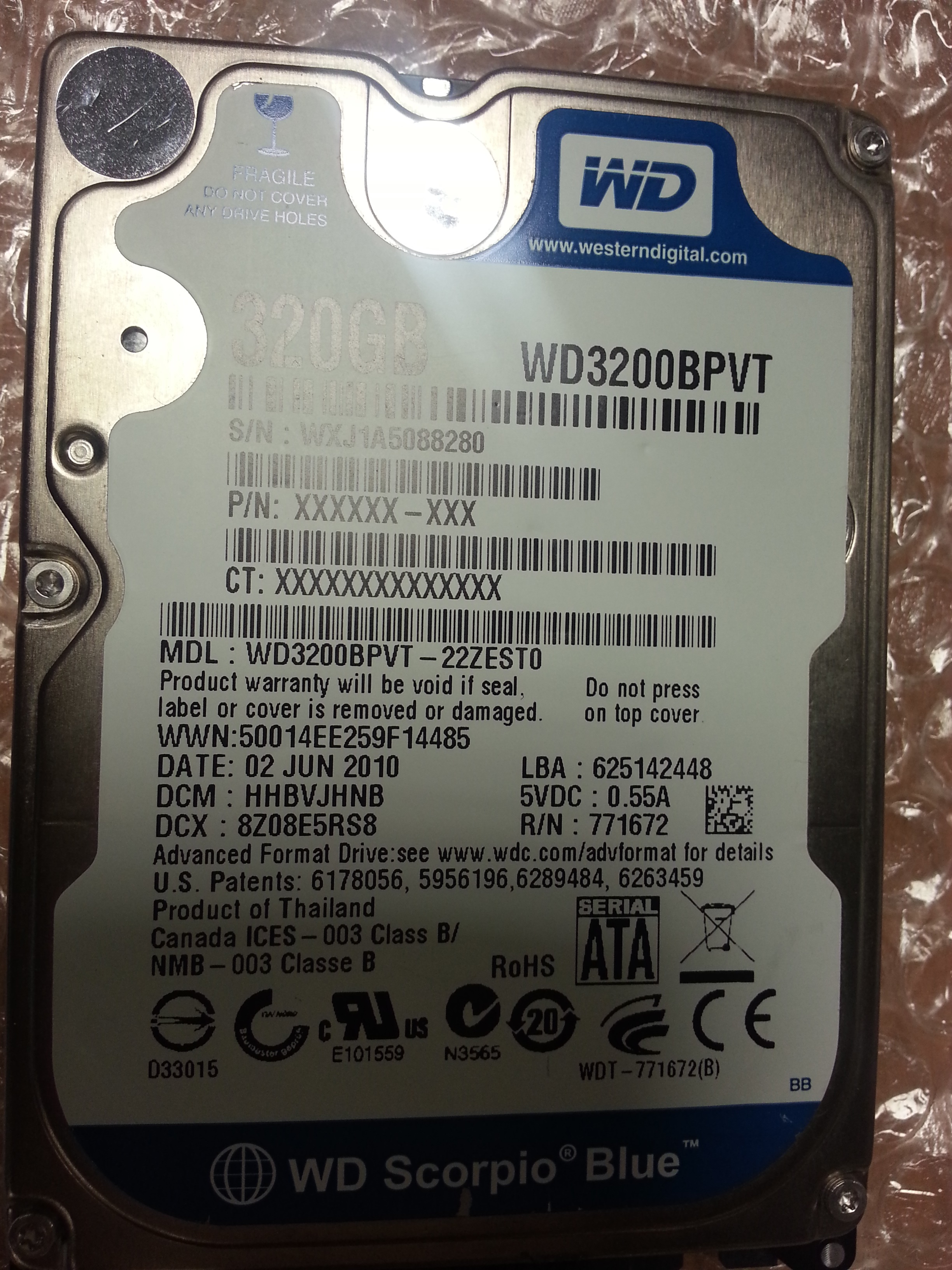

I need some help with faulty hard drive (on picture), the drive it's on the picture.
I don't have any data on the drive that i want to recover.
Mechanically the drive doesn't produce any strange sound/noise.
The scan (on picture) only render the first sector as BAD, I assume the rest of the drive it's fine.
Every time I try to format or crate a partition (Windows and Linux) I get a generic 'no can do' error.
To my understanding, the problem is the bad sector on the first sector (MBR and Partition Table).
I wish to use the disk as a non-bootable disk.
what software do you recommend to do a low level format on a WD disk?
Any idea make this disk usable on linux?

 Post subject: Re: Bad sector on first sector, is it still usable?
PostPosted: October 3rd, 2014, 5:26
Posts: 17323
If you write to a bad sector, the drive should automatically reallocate its LBA to a good spare. Try zero-filling the drive and then rescan it. Alternatively, try writing to sector 0 using a disc editor (eg DMDE freeware).
That said, I wouldn't trust the drive with my important data, but you may have non-critical uses for it.
Incidentally, what does SMART tell you?
