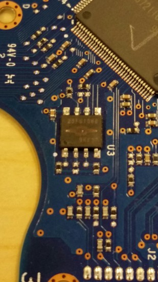

This drive had a burnt out board. Looked like liquid had been spilled on the laptop. Installed new board and NV-RAM swap. Drive comes DRD without clicking. I can read/write NV-RAM okay. Switched off heads in RAM. Any interaction with the drive causes it to either go BSY (and stay BSY) or ERR UNC. Is this bad heads?

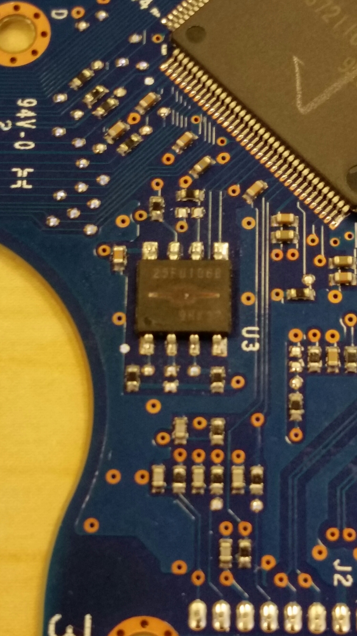

Here is the chip I moved.
 Post subject: Re: HTS725032A9A364 - Bad Heads ?
PostPosted: August 29th, 2014, 16:31
Wrong one! That's the ROM.
There should be a smaller (NVRAM) one, U6 from memory (at home now).
Won't hurt to move both, so move the NVRAM and you should be good to go!
