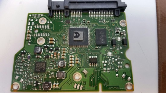

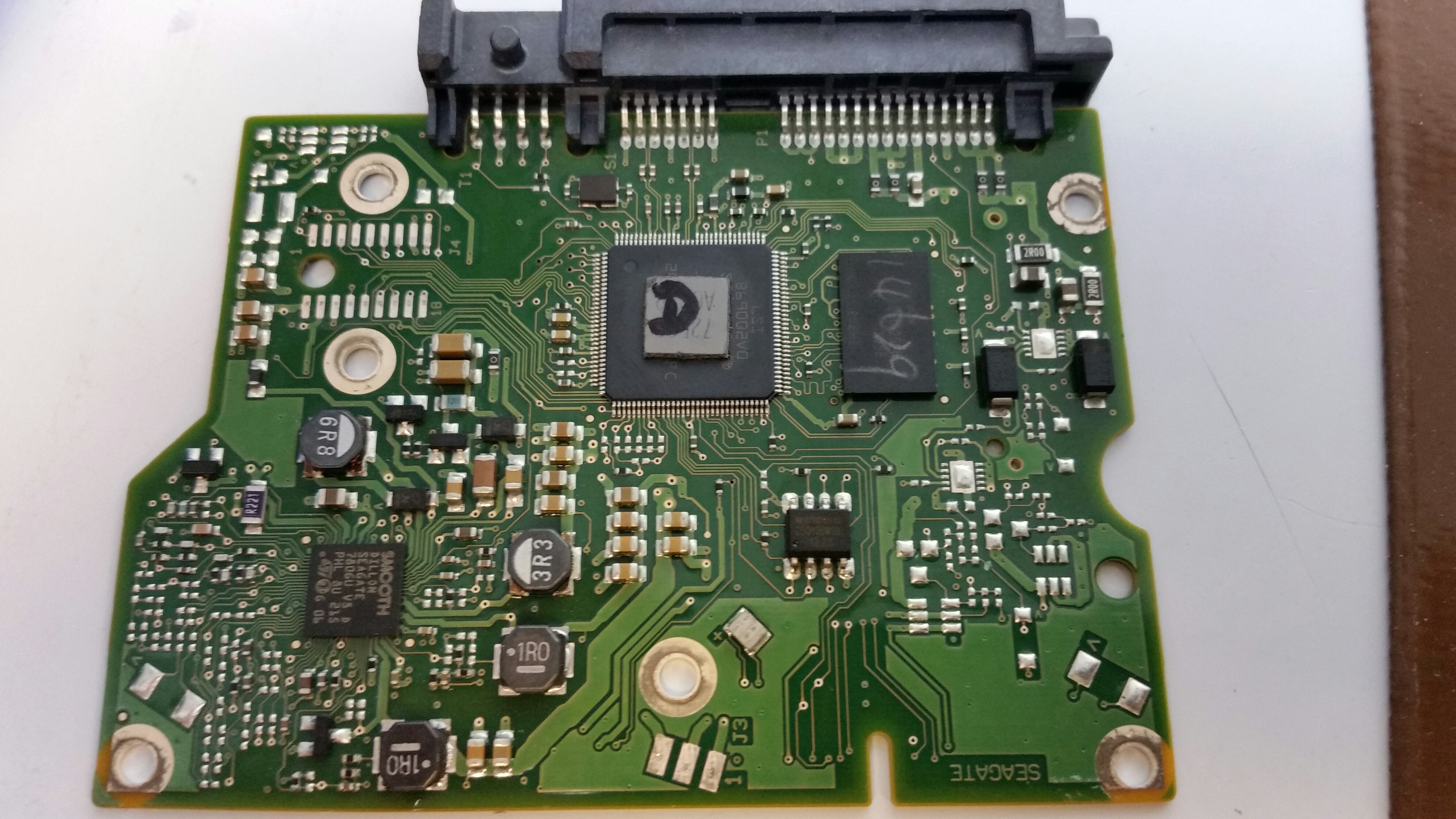

Measuring VCM and Spindle Motor Current:
http://malthus.zapto.org/viewtopic.php?f=59&t=204&p=484
Thanks for the link, very comprehensive indeed. I am trying my best to absorb it, but need a little help relating it to my board. I have tested the windings at the three points and they all show 2.9 ohms. I am having difficult locating and testing the VCM points. Can you steer me in the right direction?
 Post subject: Re: Any Good Links on How to Test Motor Windngs?
PostPosted: September 9th, 2014, 17:37
Posts: 17228
The only likely looking current sense resistor appears to be the one marked "R221". If it senses VCM current, then it will have continuity with the VCM pins (15 and 17 ?) at J4. Otherwise, if it senses spindle motor current, then one end will be grounded.
That said, I notice that some newer boards, and some not so new Hitachis, appear to sense the spindle motor current internally to the motor controller. I suspect these designs use senseFETs, in which case I don't believe there is any easy, non-invasive way to measure the motor current.
Some light reading ...
http://www.onsemi.com/pub_link/Collateral/AND8093-D.PDF
http://www.eetasia.com/STATIC/PDF/20080 ... S=DOWNLOAD
http://www.nxp.com/documents/applicatio ... N10322.pdf
BTW, I'm not suggesting that any information I've provided has any bearing on your actual problem. I'm merely answering your questions ...

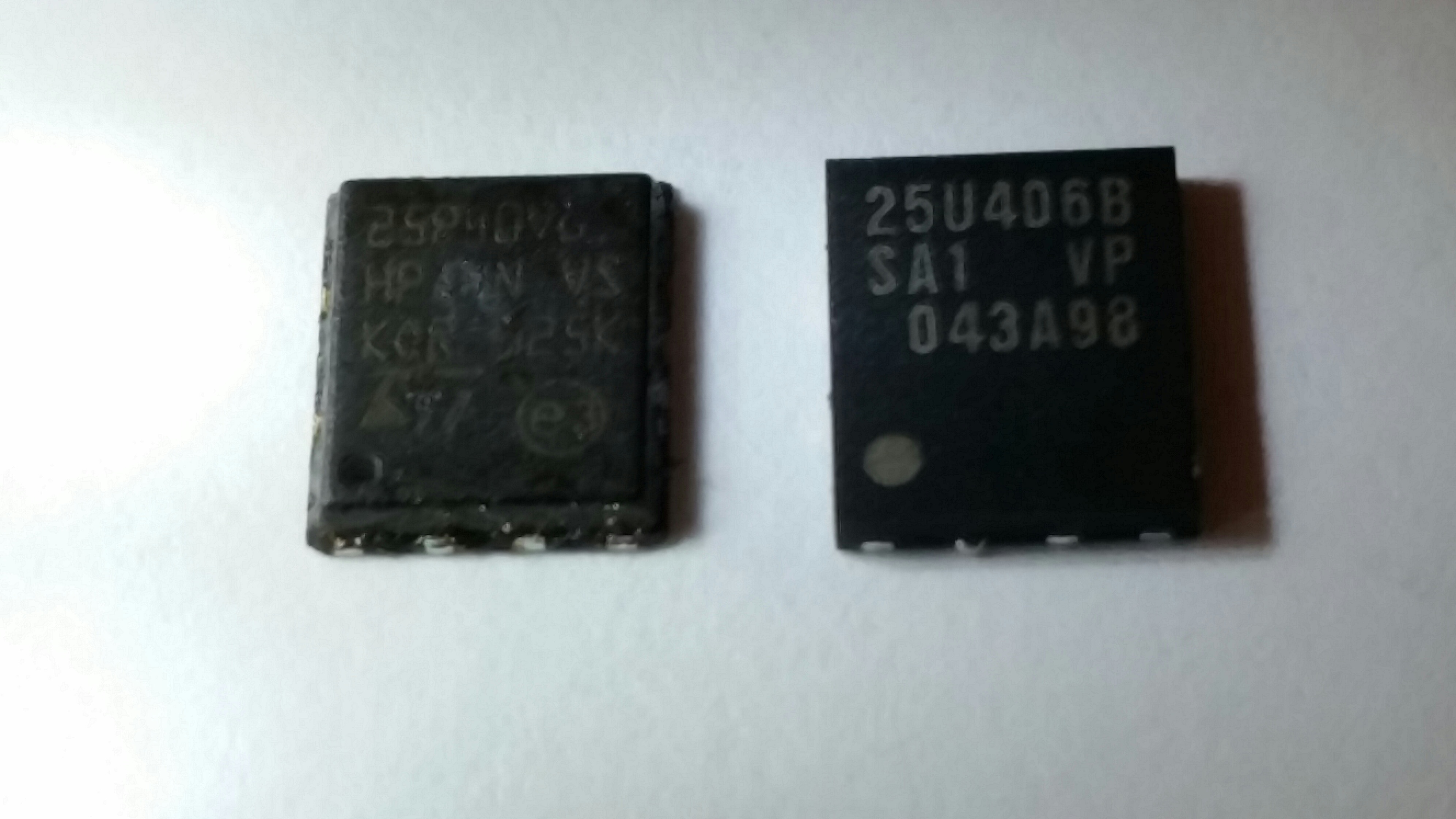

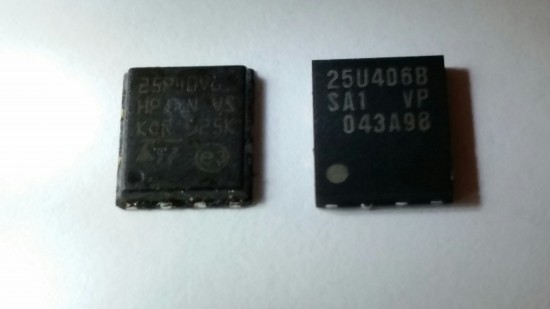

You may have seen a post from me about getting a drive in that had been to another data recovery company viewtopic.php?f=1&t=29453
Toshiba MK5065GSXF
The ROM chip on the left was on the board when it came to me. The ROM chip on the right is the ROM chip from my donor (exact match in terms of Make, SN# MD# board# etc). I know from the client that the other DR company said the ROM chip was dead and they had tried a 'similar dated ROM chip' to see if that would work!! They have told my client that the original ROM was on the board they gave back to the client. However the donor and patient ROM chips are significantly different. Is there any way of telling if this chip is supplied to this board/drive? If this is not the patient ROM, then as its a Toshiba the data is toast (maybe anyway with a dead ROM).
PostPosted: September 15th, 2014, 17:50
Posts: 17228
Could we see the contents of each chip?
The date code on the ST Microelectronics chip is obscured (xx25K ?).
I'm not sure about the Sanyo chip, but its date/batch code appears to be 043A98. Japanese manufacturers often depart from the usual YWW or YYWW encoding, but my guess would be that 043 is the YWW code.
Both chips appear to be 4M-bit (512Kx8), 2.3V - 3.6V, serial flash memories.
That said, I'm not sure that knowing the date codes would help because Japanese manufacturers often hold stock for as long as a year, whereas US manufacturers such as WD and Seagate move stock very quickly. This means that the ICs on US made PCBs tend to have closely matched date codes while the date codes on Japanese PCBs may vary greatly. I would be very concerned if the date code on any IC was more recent that the manufacture date of the HDD, though.

ddrecovery wrote:
As best as I can see there is only one additional number and it seems to be a 3 ie 325K.
"1325K" or "325K" would suggest that the chip was manufactured during the 25th week of 2013.
That said, I'm getting a little confused by the direction this thread is taking. First Seagate, now Toshiba ???
BTW, Japanese manufacturers tend to source their ICs from other Japanese manufacturers, so an ST Microelectronics part might raise an eyebrow.
