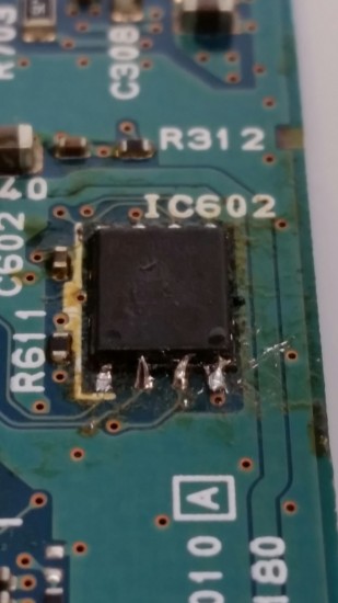

Just had this drive in after it went to another Data Recovery Company. Anyone want to admit to it.....

At least they managed to put it back on the board...

When i was at school and was learning how to soldering components in school lab, i was already able to do better soldering than this one :lol:
It's clear that they haven't even used hot air soldering station for working on this SMD device :(

looks like they might have cut it off the old PCB to solder onto the donor.

doesn't look too bad, its just covered in flux.
