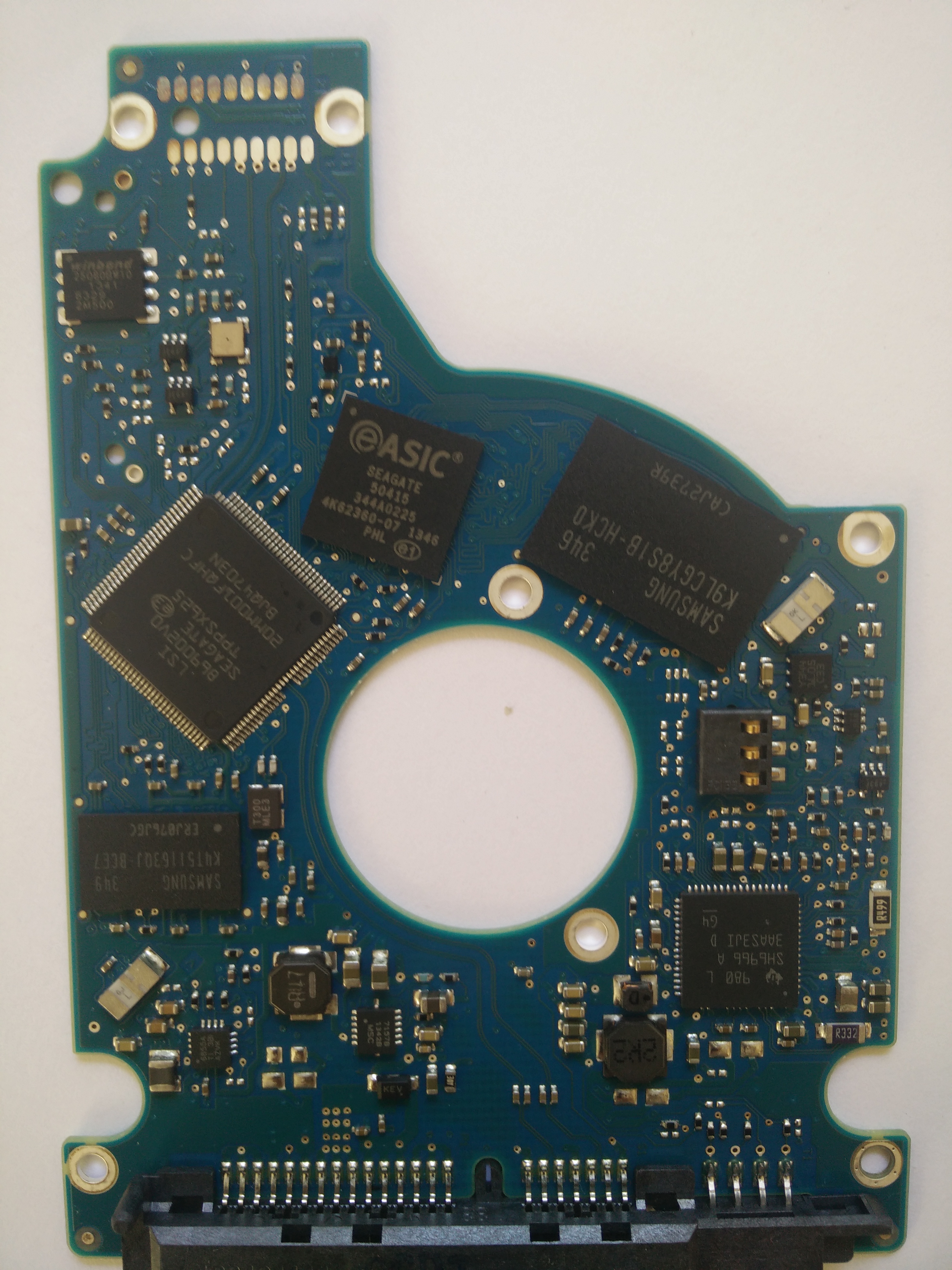

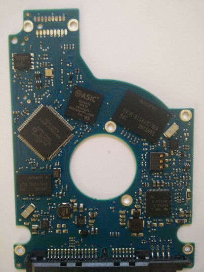

I have a Dell Precision M6800, it comes with two HDD, the 2nd is a Seagate 1TB SSHD. This laptop had some display issues and Dell eventually gave me a same replacement. Received the laptop four days ago and copied the entire 2nd HDD (partition E: and F:) to the new 2nd HDD in the replacement, using acronis. Then I deleted the partitions on the old 1TB HDD and repartitioned/quick formatted it to a single partition. At that point, I forgot to take a backup.
New 1TB SSHD
P/N: 1EJ164-038
FW: DEMA
DOM 02/2015
old 1TB SSHD
P/N: 1EJ164-036
FW: DEM7
DOM 04/2014
Everything was fine until couple hours ago when I was trying to unzip a file in E: and it just freezes. After a few attempts, I went to a different folder in E: and found nothing wrong except for not able to unzip that particular one. After a reboot, E: and F: just disappeared, BIOS could not see it there either. I then put the old 1TB HDD in the the 2nd HDD bay and BIOS & windows both recognised it, empty drive though. The last attempt was to put the faulty disk back and BIOS detected it and windows did not. Bootable acronis struggled to load due to an error loading dev1 something( sorry, I forgot to note down the exact message). Windows 8.1 was in this cycle which it detects E: then unmounts it and repeats. Each lasted a few seconds, clicking on E: in explorer when it was briefly detected would just freeze up explorer. In fact, windows could not even display the volume of E:.
It is found that the motor still spins and there is no clicking noise, HD indicator was flicking like mad. When I put it in a portable USD adapte, it was a bit intense in the first five seconds as if it was trying to fire up but couldn't.
Dell is more than happy to send me a new HD, but I want to recover the data as it contains a work-related library and other study material which hadn't been backed up since late last year. A friend of mine who specializes in electronics can swap the 8-pin FW/ROM chip (both start with 25Q80B) for me, is that going to work given these two HDD have different firmwares? PCBs have identical model number (100705349 REV D), however some modules were different brand.
What do you think the best course of action is now? I would like to get your opinions first before heading to a data recovery company as it can be really costly.
Thanks.

It doesn't sound like a PCB fault, so IMHO it would best to try to recover your data from your quick formatted drive. Partition F: would most likely be completely recoverable with freeware. Partition E: would be more difficult, but still doable.
I would use a disc editor such as DMDE (freeware). If you see your F: volume in DMDE's Partitions window, then double-click it and expand the Root. Do you see your original file/folder tree?

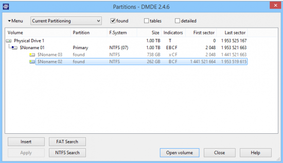

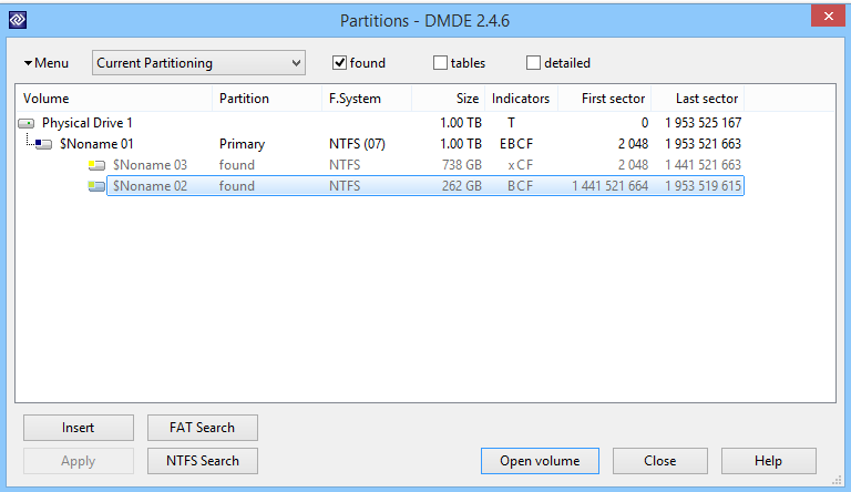

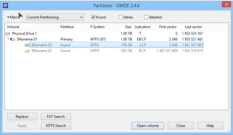

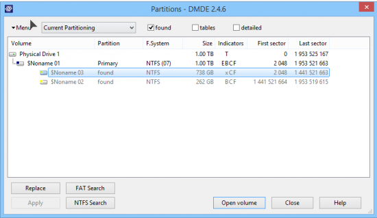

Thanks for the advice, DMDE could see both partitions on the old disk and as you suggested, I could recover most files in F: but not nothing on E: . (F: had the option to insert whereas E had replace)
Can you please elaborate on how to recover E: in this case ?
There's some data on the new disk F:(faulty one) that was important and hasn't been backed up yet, would still like to try swapping rom on the PCB after recovering the data from E: if possible.
File comment: F:

I strongly recommend that you work on a sector-by-sector clone (at least of drive E:, physical sectors 0-1441521663), but you can undo the repartitioning error by r-clicking the $Noname01 Primary partition and selecting Remove the Partition.
Then r-click each of the $Noname02 and $Noname03 partitions and select Insert the Partition (Undelete). You may need to select Drive -> Apply Changes and reboot for the OS to reexamine the file systems. Drive F: should then be accessible as before, but drive E: will probably show up as RAW.
You could also restore the original boot sector for E: by r-clicking it and selecting Restore Boot Sector from the Copy. The file system will still be corrupt (the MFT will have been initialised), but an NTFS Search Within the Partition should find the old NTFS components. You can pause the search, save the search log, and resume at a later time. This allows you to examine any file/folder trees that DMDE finds without having to wait for the entire drive to be scanned.
Alternatively, you could mount the F: drive with Partition Find and Mount in readonly mode, and then copy and paste your files to another drive, just as you would in Windows Explorer. You wouldn't need to repair your partitions in order to do this.
Exactly, F: came back but E: showed up as RAW
Just started NTFS Search Within the Partition (E:), 7% so far. Hopefully I can still recover those data

It's nothing at all to do with the PCB, don't waste your time :?

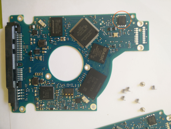

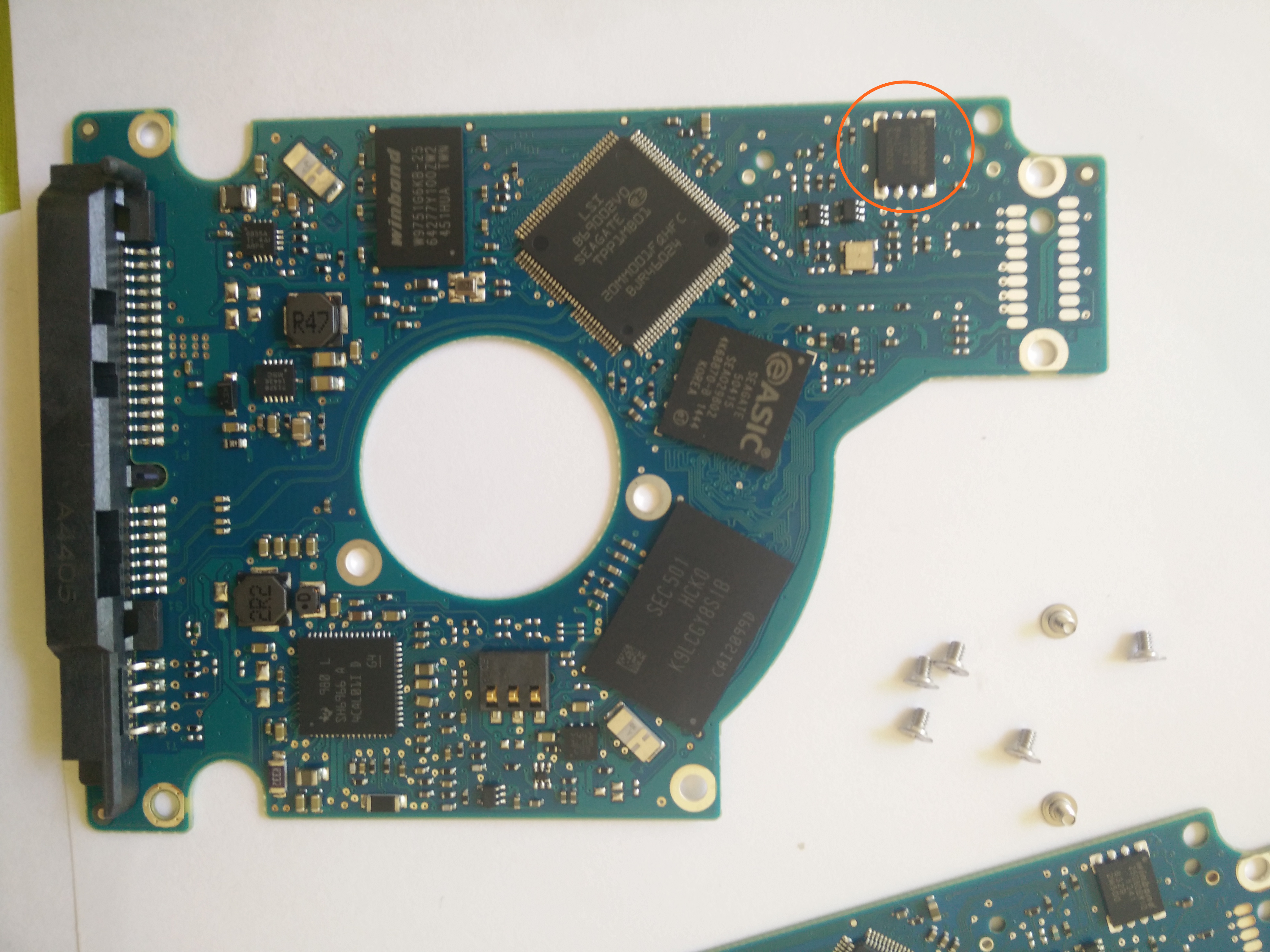

I have a similar issue with the exact same hd.
except mine, it does not spin at all so i think its the PCB.
i ordered one but it wasn't the same PCB rev code so when i replaced it i noticed that it did spin up, but my mac thought it was an uninitialized drive. I'm ordering another PCB with exact same PCB#, REV CODE , SN, PN and Manufactured location. I'm hoping with the right PCB the hd will actually not only spin up but it will also read correctly.
although i did read you sometimes have to move over a "bios" on the hd? is this true? if so is there a chip hat i need to move over for this hard drive? even though its the same PCB number , rev, sn,pn etc?
thanks in advance!

There's a LOT more to these Seagate SSHD drives than swapping the boards.
Yes, there is a ROM chip which contains unique info including adaptive data and even the drives serial number.
But that's only part of the issue with these, with the SSD of the part of the drive to contend with.
Don't waste your money on buying more PCB's, they won't work.
If you need the data then you DO need to professional assistance. And the right company too, a lot don't know how to handle these beasts.
