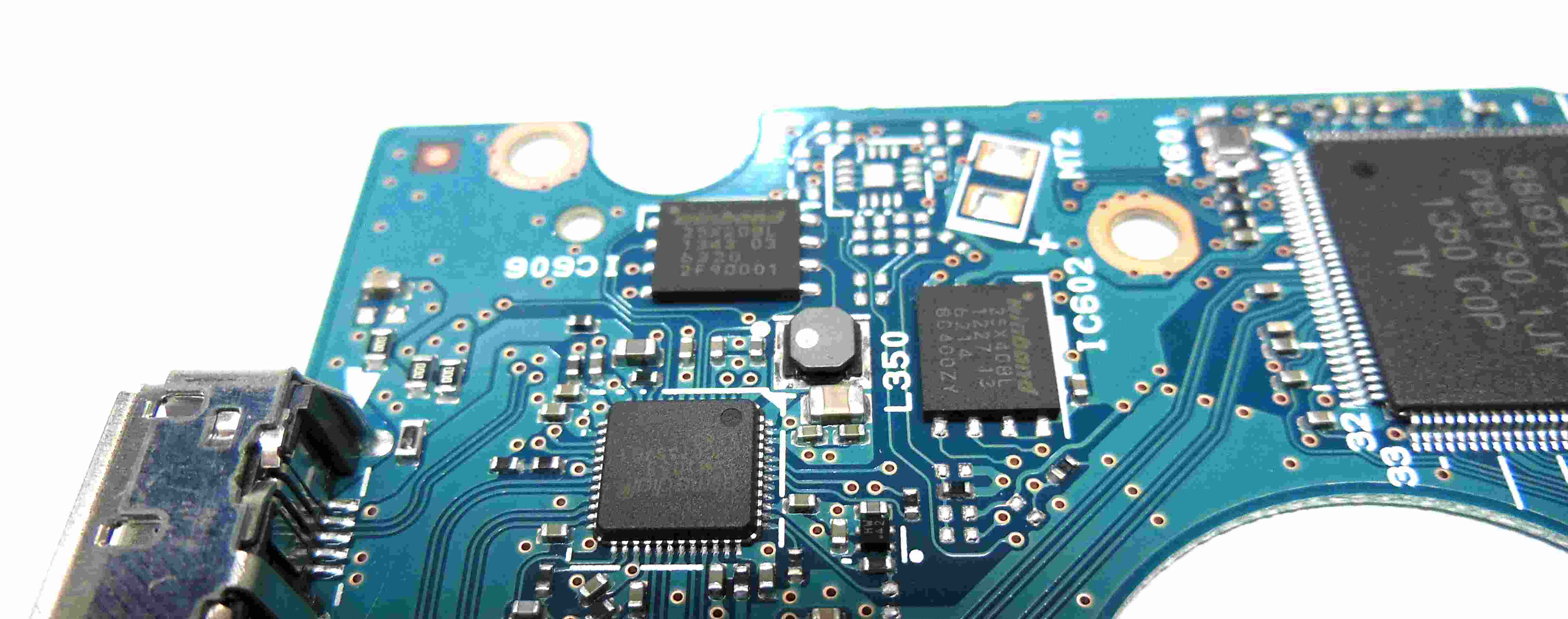

Hi All, anybody know which one is the actual rom chip on the pcb I`m uploading?
it is running 1,5 Tb drive MQ01ubb150
File comment: usb 3

IC602 is the usual circuit reference for the "ROM".
The way to distinguish between IC602 and IC606 it follow their pins back to their respective controllers. IC602's signal pins trace back to the Marvell MCU, whereas IC606's pins go to the bridge IC. This means that IC602 contains HDD firmware while IC606 contains bridge firmware.

It is IC602 as fzabkar says.

Be careful with IC602, they are heat sensitive.

As northwind said, head sensitive, and hard to exchange.

I think is very easy to unsolder it, expecially if you use gel flux.
If you use gel flux you can unsolder chips with lower heat (and have better result)
