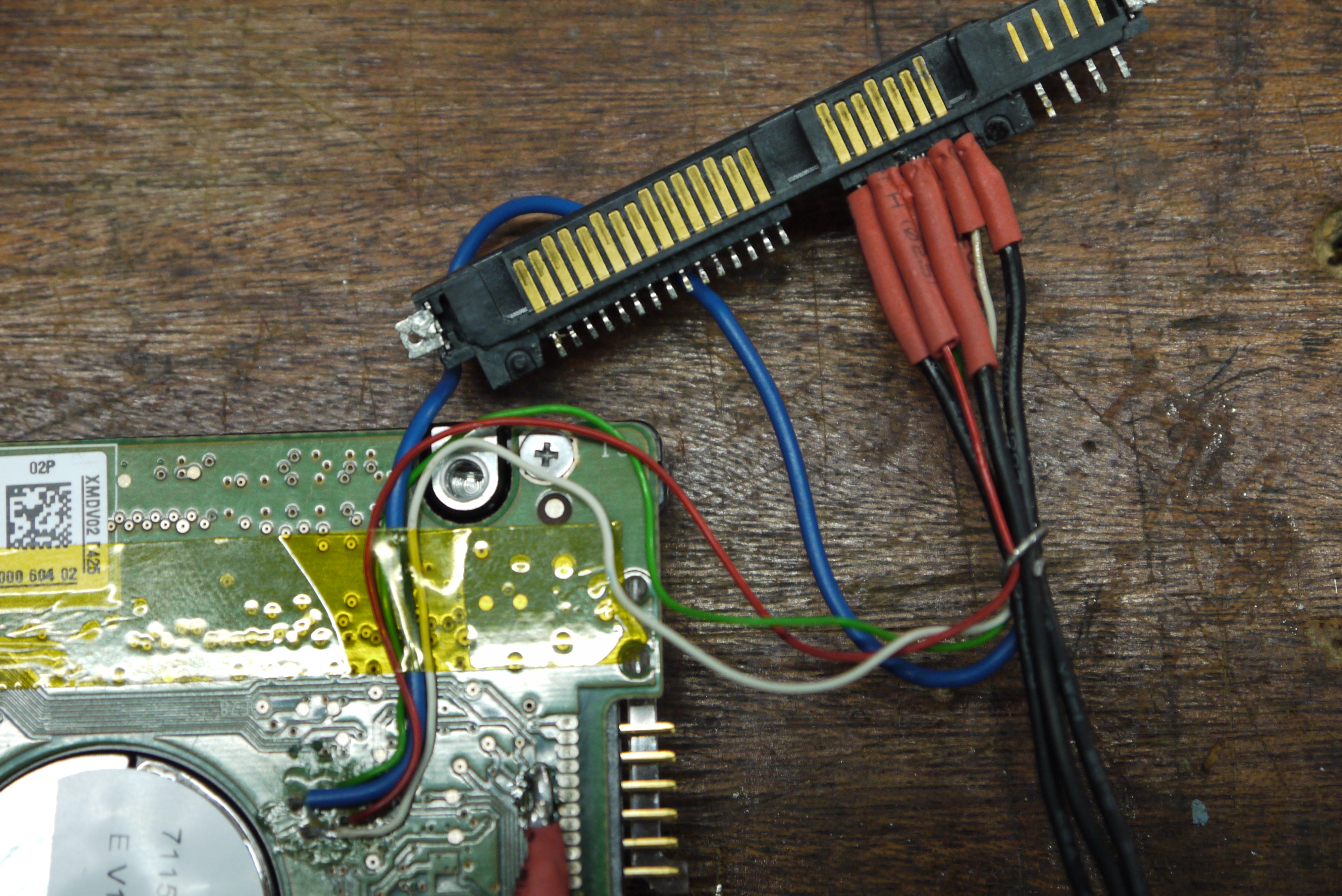

PostPosted: October 9th, 2014, 10:20
Joined: October 9th, 2014, 9:58
Location: Dorset, UK
Please can someone tell me where this guide is located?
I am trying to recover from a WD10TMVW via pictures I found on Google to convert it to SATA.
Using the USB for power and removing the 4 caps I can get it to show a 931GB hard disk that needs to be formatted according to Windows.
I have tried to recover data with 'ReclaiMe' but it only gets to 3% and finds nothing. If I use 'R-Studio' I get 4 MP3 songs in the first sector but then it just has data redundancy cyclic errors over and over again.
The disk doesn't click or grind so I assume the heads and platters are OK. The USB connector was fine and nothing is burned out, it just seemed to die overnight for some reason.
Any help from you guys much appreciated.
Phill.
 Post subject: Re: Make USB WD passport Essential drive a functioning Sata
PostPosted: October 9th, 2014, 10:59
It's encrypted via the USB board, if you convert to SATA all you'll get is garbage (encrypted data)

Phil,
I've got to give you an A for effort. But you probably should have researched it better before starting to solder on the PCB. You need pro tools to recover data from passports. Unless you're willing to invest $7000 plus a lot of time learning, I'd suggest you find a pro. :D

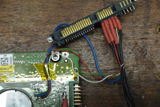

PostPosted: October 9th, 2014, 17:25
Posts: 17323
@sparky_dcr, congratulations on your excellent work. ISTM that you may now be facing the well known "slow responding" issue. If so, then see the following thread:
http://www.alexsoft.org/viewtopic.php?t=998&p=4345
Once you have applied the patch, you will need to return the PCB to USB mode, or you could transfer the contents of U12 to a replacement USB PCB. Some PCB suppliers include such a service for free.
That said, could you obtain a SMART report using CrystalDiskInfo?
Can you retrieve the drive's ROM and SA firmware?
http://sediv2008.narod.ru/Easy3.9Passwo ... 567890.rar
http://sediv2008.narod.ru/Settings.rar
