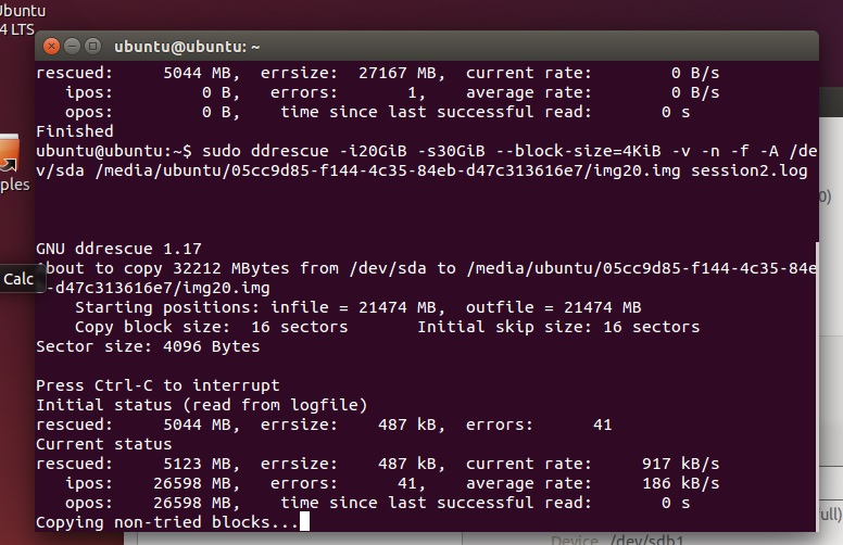

i have same Disk St2000DM001 - same problem, i can entert f3 t .
Then i enter
/T
i4,1,22
F009A,C1
F00E2,91
F00EC,B0
/1
N1
Disk is visable by Bios and Ubuntu.
I run ddrescue -n -f /dev/sda /dev/sdb (another 2TB disk) but ddrescue is works wery slow, about 200kB/s
How to speedup?
Sorry my english is bad:D

try it in reverse mode with -R switch.

Head swapped a ST2000DM001 yesterday myself too. Only had around 1500 bad sectors in the end which were isolated to a few areas and only affected a few files. I'm actually starting to like these DM drive cases now that I fully understand most of their quirks.

1 .how to swap heads?
2. When i run ddrescue is running abount 260kb/s - restore 5000MB and hang
i start from 0GB , 20GB and is the same - when i connect console to f3 T and /1 > N1 - hdd works again.

Try :
F"RWRecoveryFlags",00,22
F"BGMSFlags",00,22
F"PerformanceFlags",043C,22
Try to clone.

Instead of :
F009A,C1
F00E2,91
F00EC,B0
use :
F"BGMSFlags",00,22
on F3 T>

ok, i use
F"BGMSFlags",00,22
and next
/1
/N1
now im testing.

ok, ddrescue works again, but speed is very bad, about 190-200kb/s :/
There is any option to speed up this by comamnds in /T ?
This is screen from ubuntu and ddrescue
