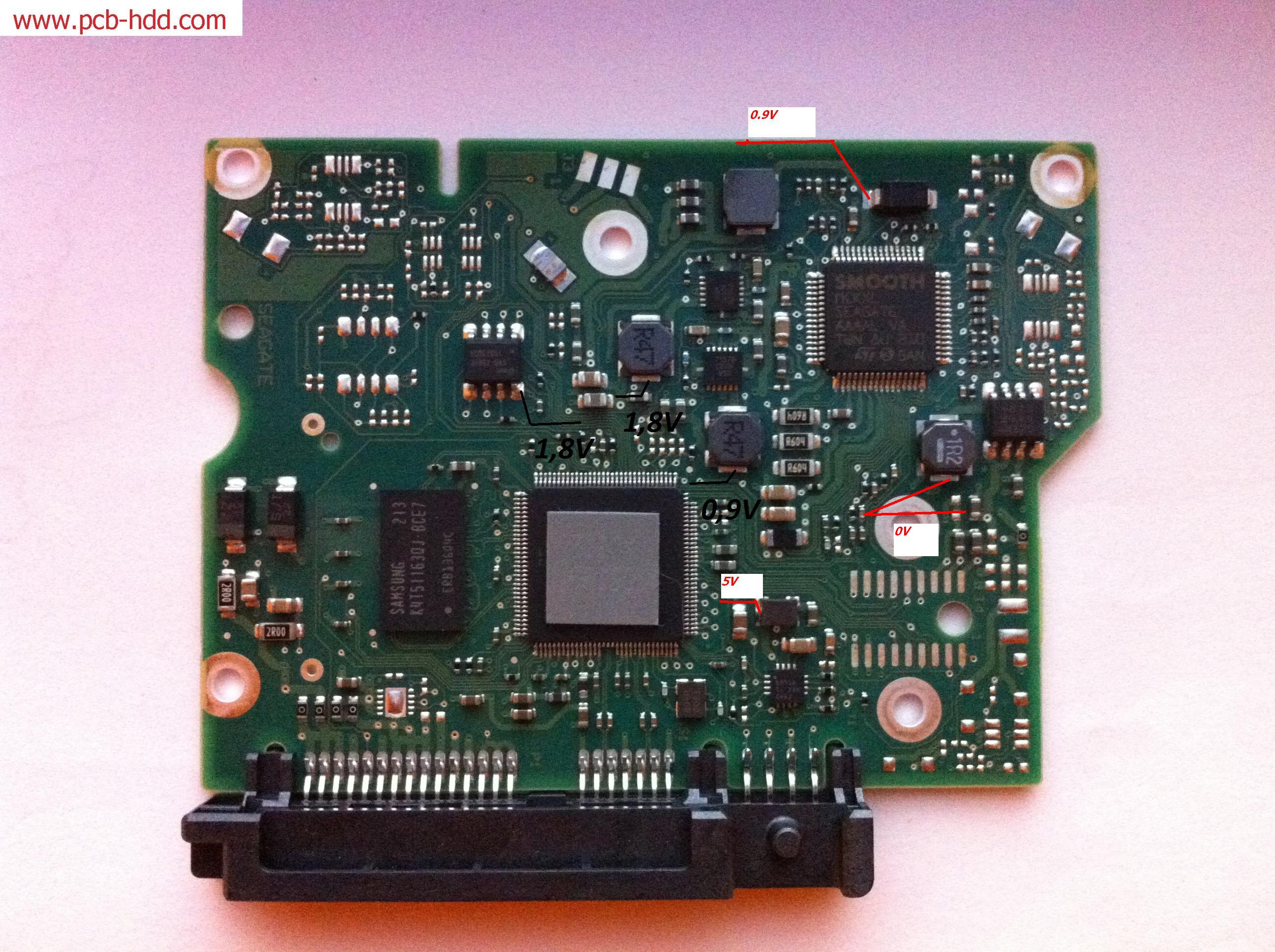

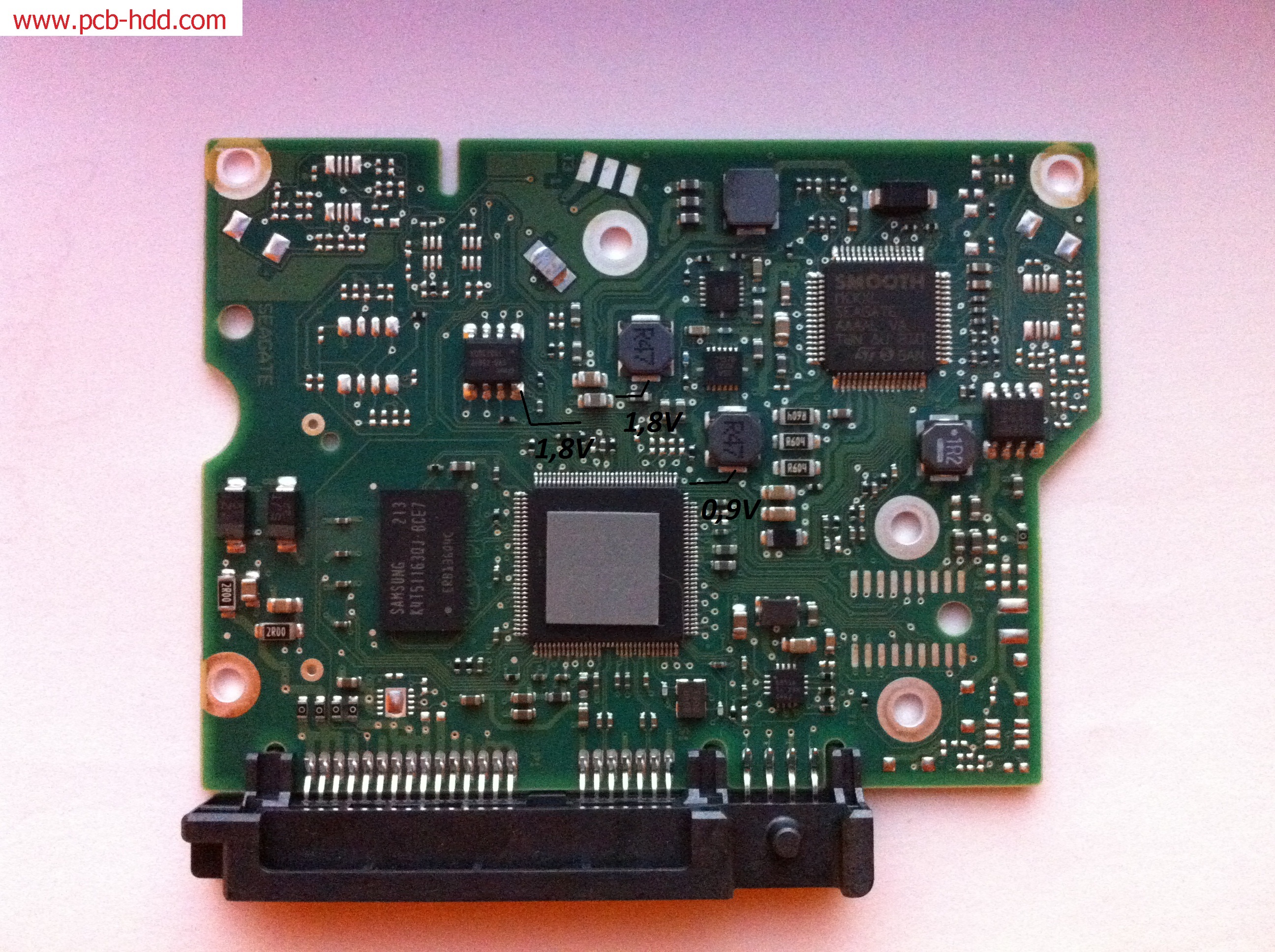

voltages:
(PCB is borrowed from the Internet, but it is the same as the ones in the attached picture.)
ps. ROM dump add on Thursday because tomorrow I'm out of range.
 Post subject: Re: ST3000DM001 - 9YN166 Drive not detect, Spin Up, 11Click'
PostPosted: September 16th, 2014, 17:58
Posts: 17215
Those voltages are OK.
Vcore = 0.9V
Vio = 1.8V
I believe there is a second Vcore supply at the uppermost coil immediately to the right of the motor terminals. It should be around 1V.
There is an additional 12-pin chip to the left of the preamp contacts, but I don't know what it does. It might be worth measuring the voltages on its adjacent capacitors.
PostPosted: September 18th, 2014, 14:13
Posts: 428
Hey Franc,
I attach measured all the voltages on the PCB disk:
any ideas?

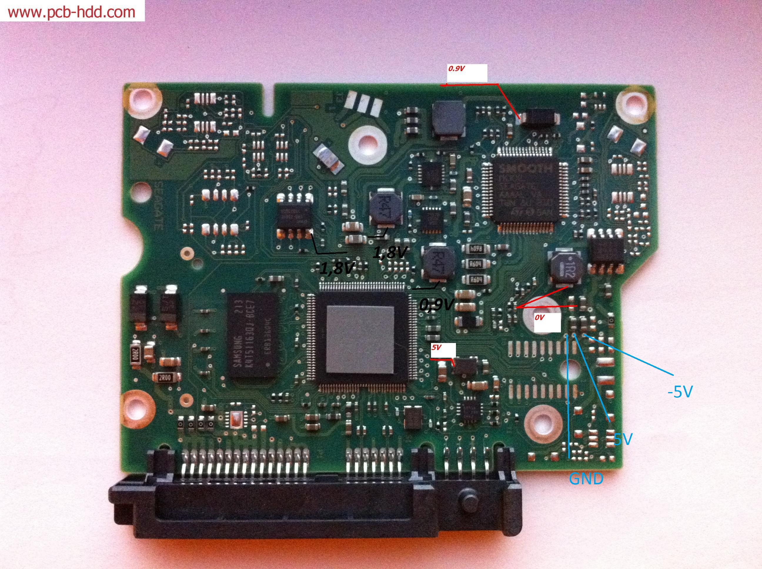

Check 5 and -5 V going to preamp. PCB probably needs to be placed on HDD.
PostPosted: September 18th, 2014, 17:03
Posts: 428
Ok, well I checked if there is 5V and -5V, and so is 5V however it can not -5V, what is more in line -5V have a short to ground, which leads to Smooth. Bad Smooth!?
PostPosted: September 18th, 2014, 17:38
Posts: 17215
The -5V supply uses an Inverting Buck-Boost topology. This means that one end of the coil is connected to ground.
Tutorial - Linear and Switchmode Regulators used in HDDs:
http://www.alexsoft.org/viewtopic.php?f=59&t=231&p=596
The PWM control for the -5V supply comes from the motor controller. However, the MCU enables or disables this supply by way of a command to the motor controller, at least in some designs. It could be that this supply is turned off after the MCU fails to detect the preamp, in which case it would need to be measured when the PCB is attached to the HDA.
That said, if the -5V output at the HDA contacts is shorted to ground, then this would indicate a PCB fault, or a bad preamp if the board is attached to the HDA.
The Vio and two Vcore voltages are OK. I don't know what to make of the other IC, though.
I can't suggest any reason for the high temperature of the MCU, but it might be worth trying another board and transferring the serial flash memory. If it weren't for this observation, I would have bet on an internal fault. That may still be the case.
