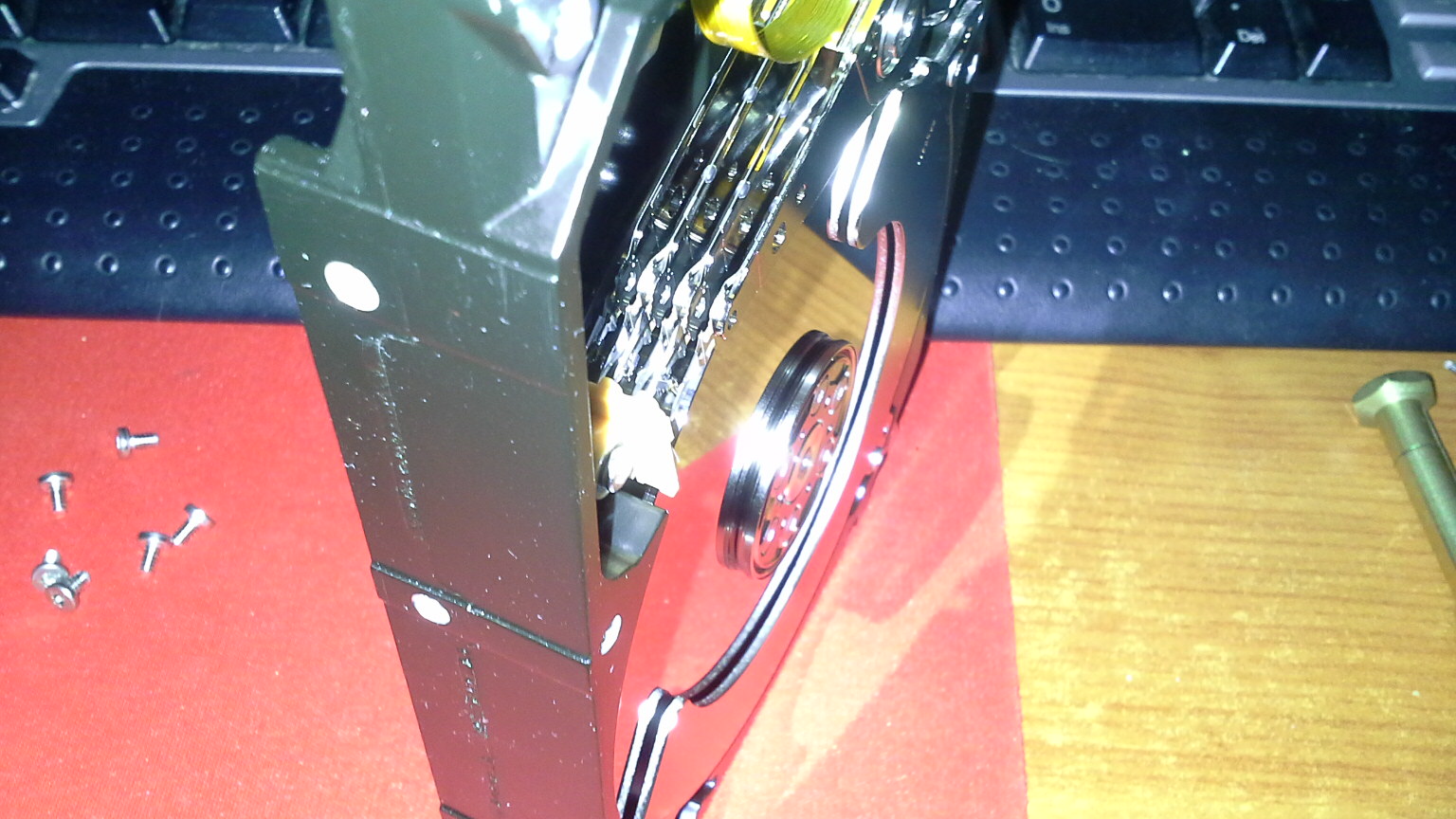

Hello i'm live same problem
Before this error hdd power down and power up possibly 20 times and stopped last time
I can try this post suggestions but everything is normal/fine
I have another bad hdd same p/n etc.
Try board change but same status for clicks
This is showing problem has mechanical possibly plates/motor jam
And last chance open drive and see problem
Upper head break and jamming between head arm and upper plate
This case need for me a head change operation following days
hdd is died with suicide
picture is attached

Wow, usually google translate can at least make out one or two intelligible sentences on a post that long. But I can't understand anything he's saying. :cry:
 Post subject: Re: ST3000DM001 - 9YN166 Drive not detect, Spin Up, 11Click'
PostPosted: January 18th, 2015, 15:56
Posts: 2020
ioz wrote:
picture is attached
OK, I understood that part.
