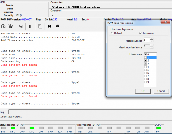

Hello
WD500BPVT makes the click noise.
I have a hard drive of my client.
WD500BPVT makes the click noise. It detects as PC-3000 but does not show the model or size () but I can save ROM but can not see the sector.
in my opinion, the drive Head blocks.
WD5000BPVT
MDL: WD5000BPVT-60HXZT1
DCM: EHOTJHN
What is your advice?
thank you
Best regards

Try to do a ROM Headmap to disable heads and check wich one is bad.
You can also try to use a loader to check if it's really heads or FW problem.

Heads are bad, requires cleanroom work and parts. We can almost certainly help.

Yes, that's bad heads, probably some surface damage.
But what this will give for the clicking hard drive?
If a drive clicks, it can't read servolabels, so heads are to be replaced.
Headmap and loaders are the instruments for non-clicking hard drives. A reasonable check here would be to test the PCB by replacing it with a surely working one (after a ROM transfer).
If nothing has changed after that, then do a head swap, which in its turn will allow to judge the surface condition.

Hello
I try to launch the Utility Start with Karnel
I try to - RAM head Map edition
Here log in Pc3000
Techno mode key
Techno mode key......................... : Ok
RAM:
HDD Info reading........................ : Ok
Heads number............................ : 3
Cyl Count............................... : 256
ROM:
ROM reading............................. : Ok
ROM Data size........................... : 256 Kb
ROM version............................. : 10.0TA
ROM generation.......................... : 10.0TA
Link table version...................... : 02.13.
Consolidated ROM version................ : 0010000T
ROM Modules:
Flash ROM dir reading................... : Ok
SA regions address...................... : by default
SA Translator loading................... : Ok
Heads number in use..................... : 3
Switched off heads...................... : No
Heads map............................... : 0,2,3
ROM Firmware version.................... : 0010000T
Code type to check...................... : TypeN
Code addr............................... : FFE00000
Code size............................... : 327681
Code reading............................ : Ok
Code pattern not found
Code type to check...................... : Type1
Code type to check...................... : Type2
Code type to check...................... : Type3
Code type to check...................... : Type4
LDR Byte................................ : 20
LDR Reg................................. : R4
Code offset............................. : 485A0
Map address............................. : 20017028
Data checking........................... : Ok
I agree with you photo of ROM head map editing
Thank
