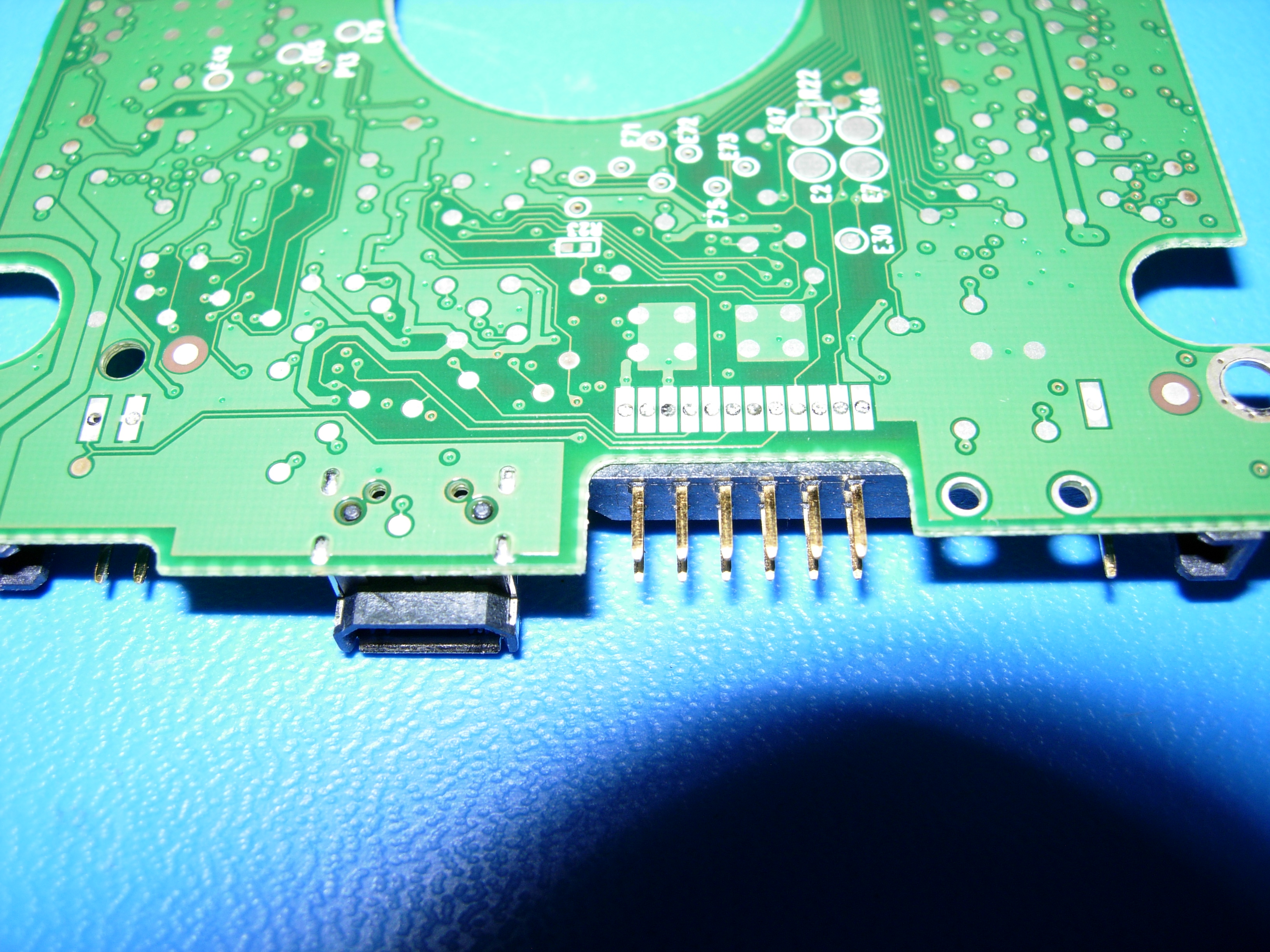

Hello again,
Has anyone worked on one of these drives before? It has 1 pin out to the left, to the right of that is 12 more pins (6 on each row), there is the USB port to the right and another 2 pins on the same row to the right of the USB port and has no SATA nor IDE adapters. I have tried a number of ways and wirings to connect it as an internal drive but nothing works so far.
http://img251.imageshack.us/i/dsc00642b ... Bu8YZ4SejA
Appreciate any reply.

Upload a detailed photo of both sides of the PCB.
There should be two, capacitively coupled, SATA Tx/Rx signal pairs running between the bridge chip and the MCU (assuming the bridge is a separate IC). You can remove the capacitors and then tap into the Tx/Rx pairs with a SATA cable.
However, even after doing the above, you may encounter encryption.
BTW, what were the "number of ways and wirings" that you tried?

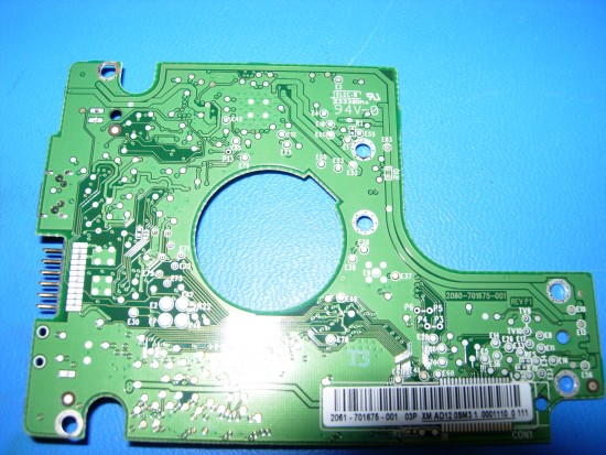

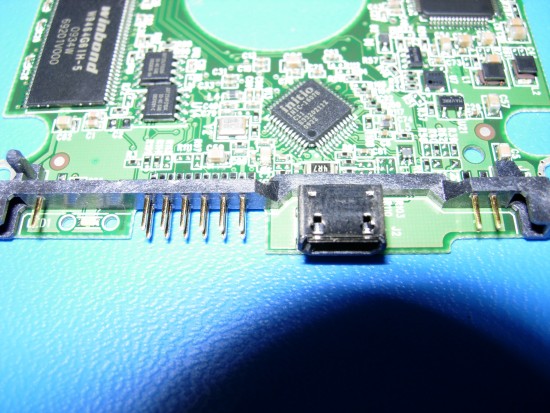

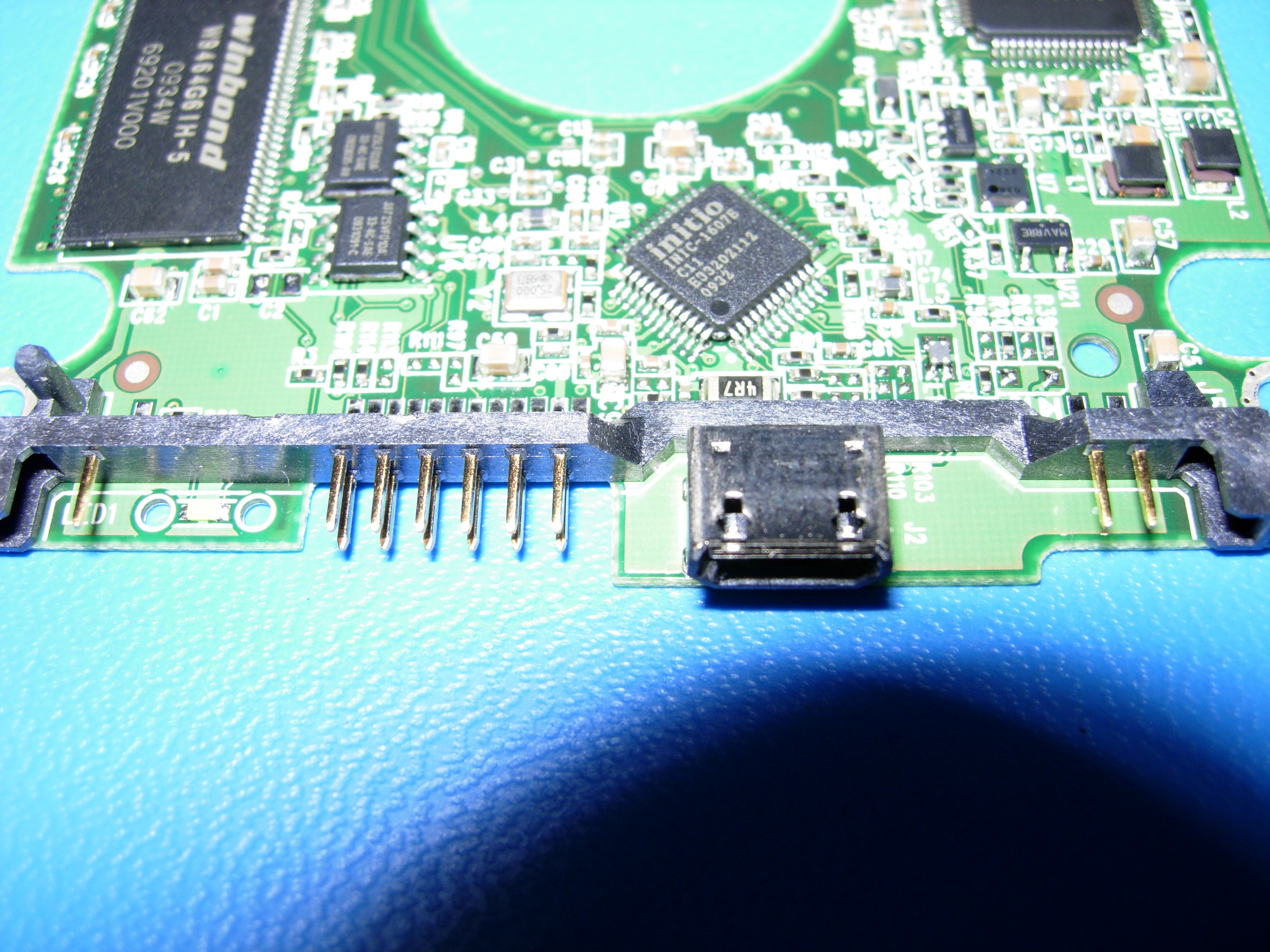

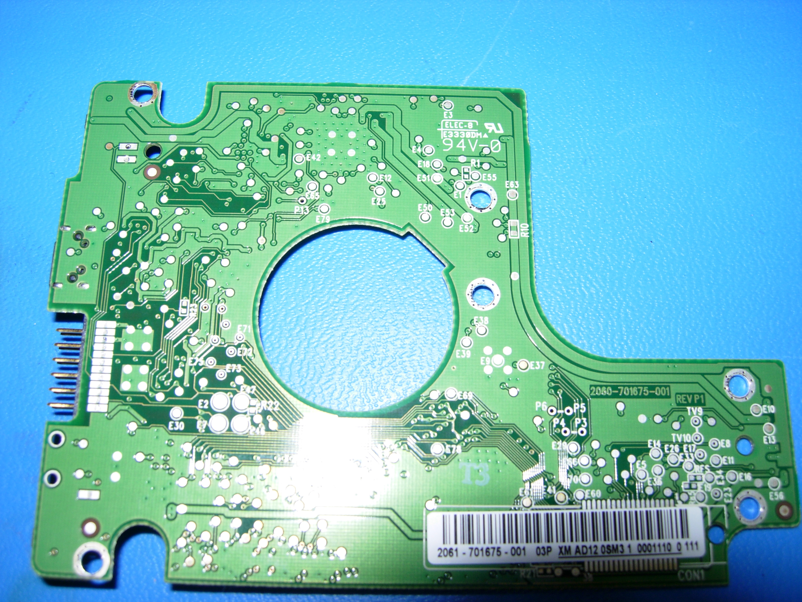

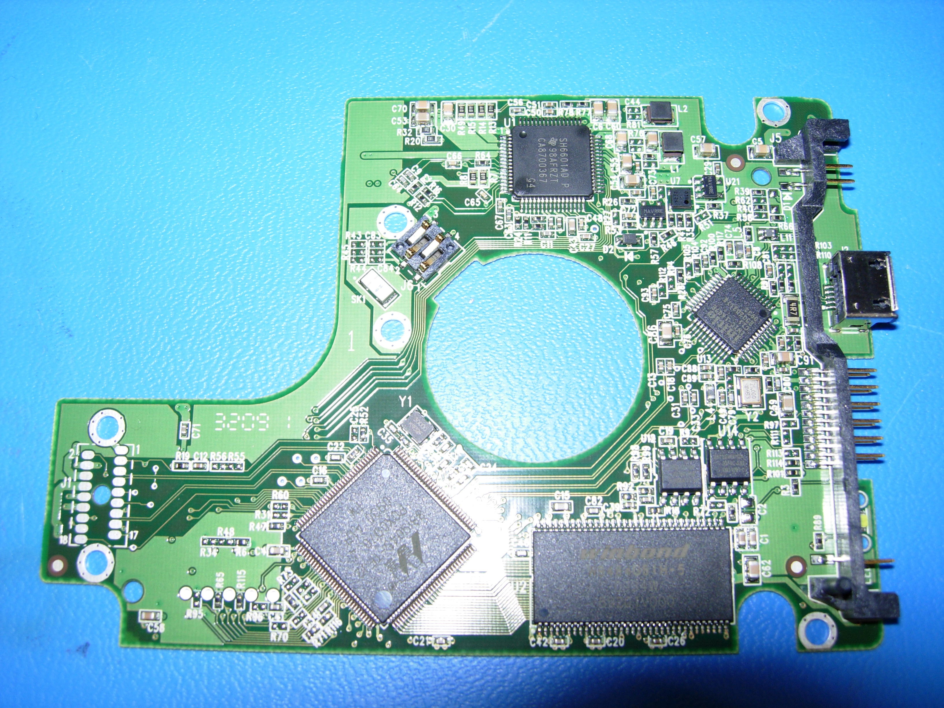

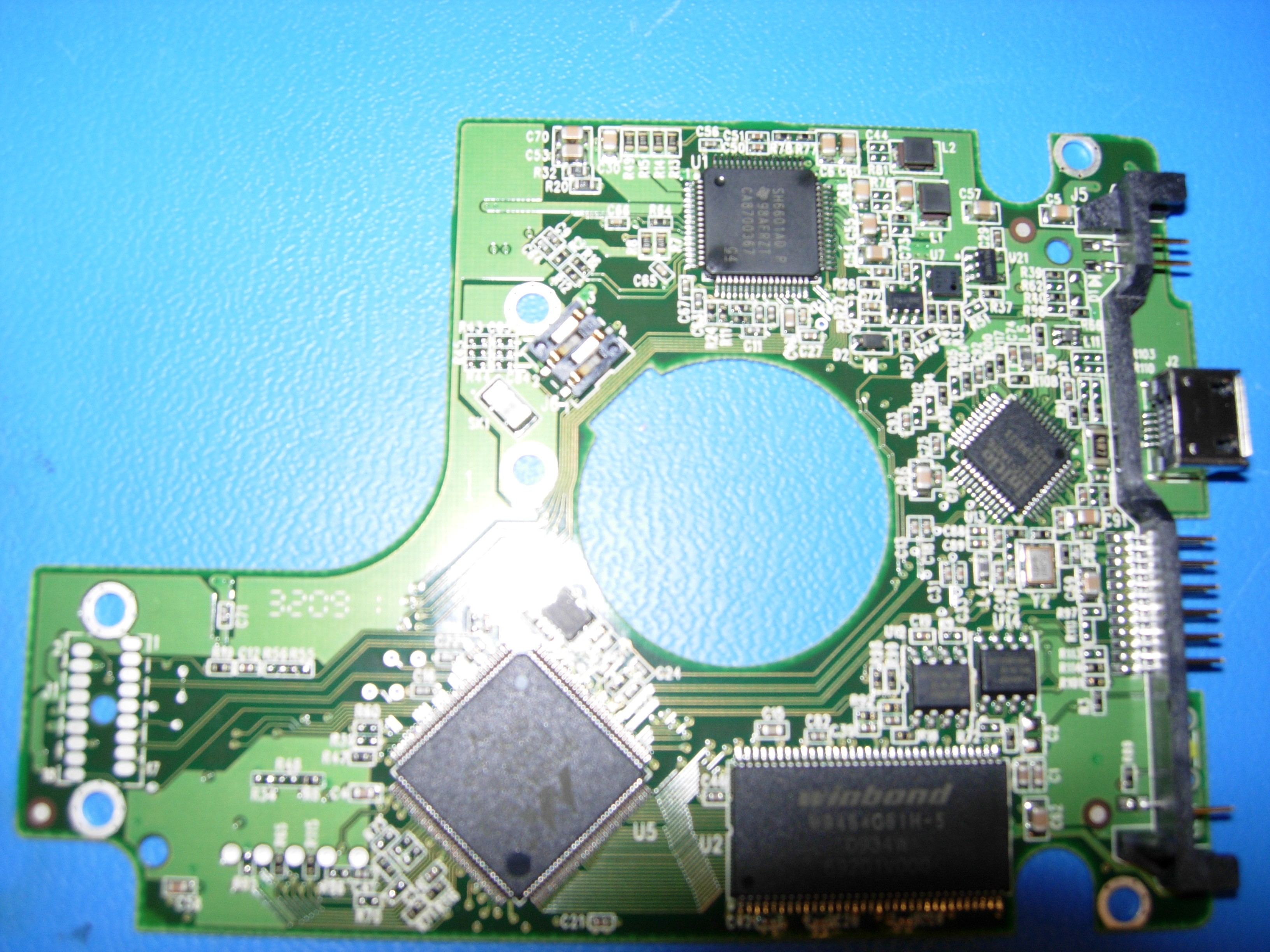

I have attached some pictures. I am in the same situation and need to retrieve the data, encrypted or not. Any information would be helpful.

Does your drive spin up?
If using Windows, can you see the Initio INIC-1607E USB-SATA bridge chip with Microsoft's UVCView?
http://www.users.on.net/~fzabkar/USB_ID ... ew.x86.exe
I believe these photo clips identify the SATA Tx/Rx signal pairs, coupling capacitors, and test points.
http://www.users.on.net/~fzabkar/HDD/WD ... V_TxRx.jpg
http://www.users.on.net/~fzabkar/HDD/WD ... V_caps.jpg
