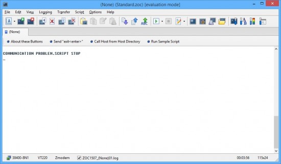

hey guys, I hadn't posted in here before now, mainly because the issue I'm working on I thought was like 1990's technology. I've been searching the web and trying to learn from scratch about this for like a month now. I've come a LONG way to where I feel like I'm right on the brink of success, but I've gotta be missing something simple.
Okay, so I have a USB to TLL adapter. I've got two breadboard jumper wires (female to female, connected to TX and RX of HDD and USB adapter) and I'm running Putty.
I placed the piece of cardstock between the primary circuit board and the hdd and tightened and loosened the certain screws (that part definitely confused me, but I realize now it's because you need to temporarily disconnect a certain piece of the PCB from connecting to the HDD for a brief bit.
My only problem is, when I connect the SATA power to the HDD, you can hear it silently start to spin up but thats where I'm stuck. in terminal (putty), when I type, there is nothing. Upon connecting the power, I see nothing. sometimes when I hit "ctrl +z" or any other combination of keys I'll get a single character that looks like its static-ed out. IU've tried switching around the cables and am currently waiting on two more jumper wires to see if 4 connected to 3.3v, tx, rx, and ground will have more affect than just the TX and RX with the data power giving it 5v.
Anyways I know I'm missing something and if anyone can help that would be amazing!
The computer it came out of was an Asus 1005HAB little mini netbook and the HDD is a Seagate Momentus 5400.6.
p.s. if anyone just happens to know the Master Password for this HDD, that would probably save me a whole lot of time, although this has definitely been a great project for learning and I would rather finish it even if I could get the master password to unlock it.

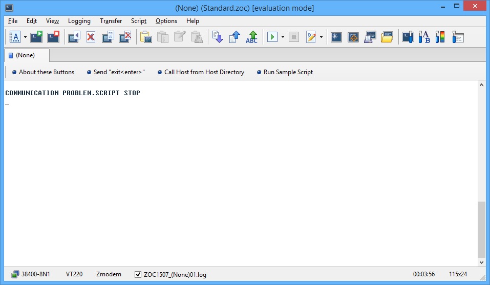

Okay, so I tried following the article. I hooked up my usb to tll adapter with two pins, one on the RX pin that went the the TX, and one for the others. When I booted up the ZOC I was able to successfully conect to the drive, but when I go to run the sUnlock script, this is what I get..
File comment: screenshot of ZOC after I try running the sUnlock script on the Seagate hdd
