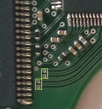

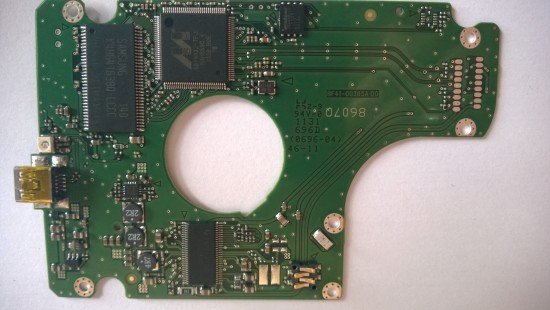

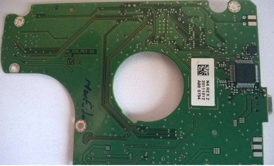

Does anyone know here are the SATA Tx/Rx situated in the Samsung HN-M500XBB? Is there a way to solder a SATA cable to access bypass the USB Bridge?

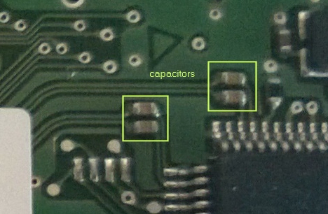

Otherwise, here are the SATA Tx/Rx pairs and my guess as to the RS232 terminal connection points.

The customer told me that he plugged the drive and left it for hours, then drive was recognized and could copy 1% from the drive!!!!
Now, when I connect it, it try to rotate but with difficulty. I want to bypass the USB bridge to connect it to PC3K and try to see what it shows me.
