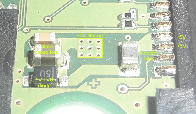

So there I was, happily chugging along on my trusty T42p with a Samsung HM160HC (a single-platter 2.5" 160GB PATA drive from 2007). When I had to reach for my daughter who was doing something unhealthy on the other side of the table I happened to rest my hand on the right wrist rest on that T42p, above the drive. I put a bit of pressure on it, not much, but enough for the screen to change into a rainbow of vertical lines. Aha, I thought, another T42p bites the dust due to the GPU getting unstuck from the board, time to bring out the Aoyue 968A+ again. Well, no, it turned out to be the drive which had stopped working. Not due to physical pressure, mind you, the amount of pressure I put on the wrist rest was hardly enough to flex it a little. When I restarted the machine the drive was no longer detected. After removing the drive, I noticed that the plastic layer between the aluminium cage and the drive PCB was damaged (torn, pieces missing). In the T42p the drive is mounted upside-down, with the PCB facing upward. The most likely thing to have happened is that the cage (which is grounded) made contact with some part of the PCB, causing the drive to fail. As stated, the drive is not recognized. It does not try to spin up, nor does it show any sign of life.
The PCB does not show any sign of damage. I measured the fuse at the incoming 5V line, it is undamaged. There seem to be 2 TVS diodes on the board, one close to the motor controller (a TLS2502B), one next to the incoming 5V line. Neither of these has shorted, but I measure only 18 ohm over the one next to the TLS2502. This is not due to the TVS diode, I unsoldered it to check. Not having any experience with these drives I'd like to hear from y'all what to look for next. I can post some board pictures if that is deemed helpful. The blue 1 ohm resistor next to the TLS2502 measures 1 ohm so that is cleared as well.

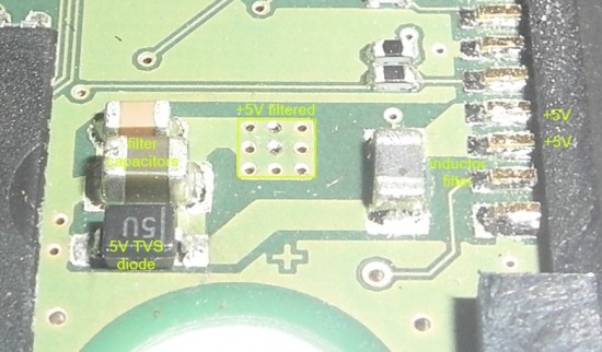

For good measure I took some pictures of the PCB:

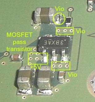

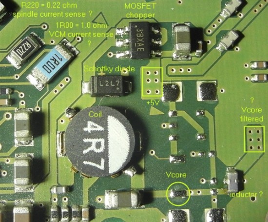

Could you measure the +5V, Vcore, and Vio voltages?

They seem quite normal:
+5 filtered: 5.02V
Vcore: 1.34V
Vio: 3.32V
Judging from what I read in the M40S service manual (a different drive, sure, but some things are bound to be similar due to component constraints) I expect Vcore to be around 1.2V, Vio 3.3V and 5V just what it says.
Any fuses on this board that I could have missed? Do 2.5" drives typically provide the pre-amp with a negative voltage? I don't see any circuitry capable of generating such here so I guess not?

Well, I fixed it, at first... The component you identied with 'inductor?' in the picture you marked as Vcore_current_sense.jpg seems to be some type of fuse/overcurrent-protection device. It was faulty. I replaced it with an smd fuse from another drive board and suddenly the console started responding:

I'm reasonably certain that the device is actually an inductor. Its function would be to filter the supply. In fact yours is about the 5th time I have seen problems with Samsung's inductors, and in several different models. In those cases the problem was not with the inductor itself, but in the solder joints. The problem was resolved by simply reflowing the solder at the inductor.
Congratulations on locating the fault. Hopefully your experience will help others.

The part I swapped for the fuse was definitely faulty in some way. It has three connections, two on each end and one in the middle. The middle connection on all these devices is connected to the ground plane. In a device which has not failed the resistance between the end and middle connections is high ('infinite' as in 'does not show on DMM'). On the one I removed it was only 18 ohms.
In my first post I mentioned that '...I measure only 18 ohm over the one next to the TLS2502...'. This device was the cause of that low resistance. It pulled down Vcore to close to 0V on its cold side. This is what makes me think it is an overcurrent protection device for the processor. There are two more of these on the board, one for 5V and one for 3.3V

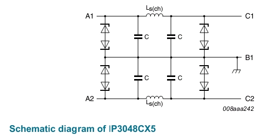

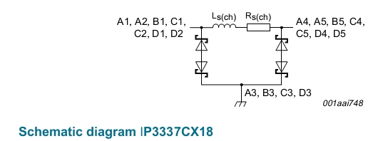

Many thanks for the feedback. Could the component be a low pass LC filter, perhaps with ESD protection diodes?
The following are multi-channel examples:
http://www.nxp.com/documents/data_sheet/IP3337CX18.pdf
http://www.nxp.com/documents/data_sheet/IP3048CX5.pdf
