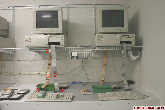

The test bed is made from Compaq DeskPro PIII, Adaptec 2940U #1 is a 68 Pin SCSI cable and #2 is an IDE cable. #3 is 68 Pin to 80 Pin converter and #4 is IDE to Laptop IDE converter #5 is extended power plug. This will let you test 68/80 Pin SCSI's and desktop and laptop IDE drives. Make sure you use MHDD seems to be the best for all. No internal HDD or CD. Install SCSI controller and loop 68 Pin cable out the back. Install IDE cable and loop out threw front bay. Install extended power threw same bay. Attach converter when needed. Boot from MHDD floppy and your in business. Total cost less than $100.00 US. Have tested 100+ from each test bed and have only replaced a few cables and converters. There are 16 test beds.

Cool setup i have the same setup with dell gx1 ..
Good very good

Didn't you run into issues with that IDE cable length (surely >44cm) and Modes higher than UDMA33?

So if you're fooling around with, say, a double-the-rated-length 900mm IDE lead, there's an end-to-end signal delay in it of about a tenth of a clock pulse. The signals you want your drives and your motherboard to be able to hear will be significantly blurred by delayed reflections from each end of the cable.
Transfer your data at twice or three times the UDMA/33 speed - as UDMA/66 and 100 do - and reflected signals get more and more out of step with the real signal, and do it more and more harm.
The faster the transfer mode your drives use, the more susceptible they'll be to cable problems, all other things being equal. That's why the 80 wire cable standard for UDMA/66 and UDMAA/100 exists at all; it makes the cables less error-prone. Each end of an 80 wire IDE cable has only 40 terminals. The extra interleaved wires are all earths, electrically tied together at each end.
These are only for testing. They are not used for data recovery. But I will say this that we are looking into reducing the cable by 1/2 to reduce noise and improve on quality assurance.
Thanks for the heads up. :D

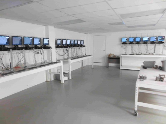

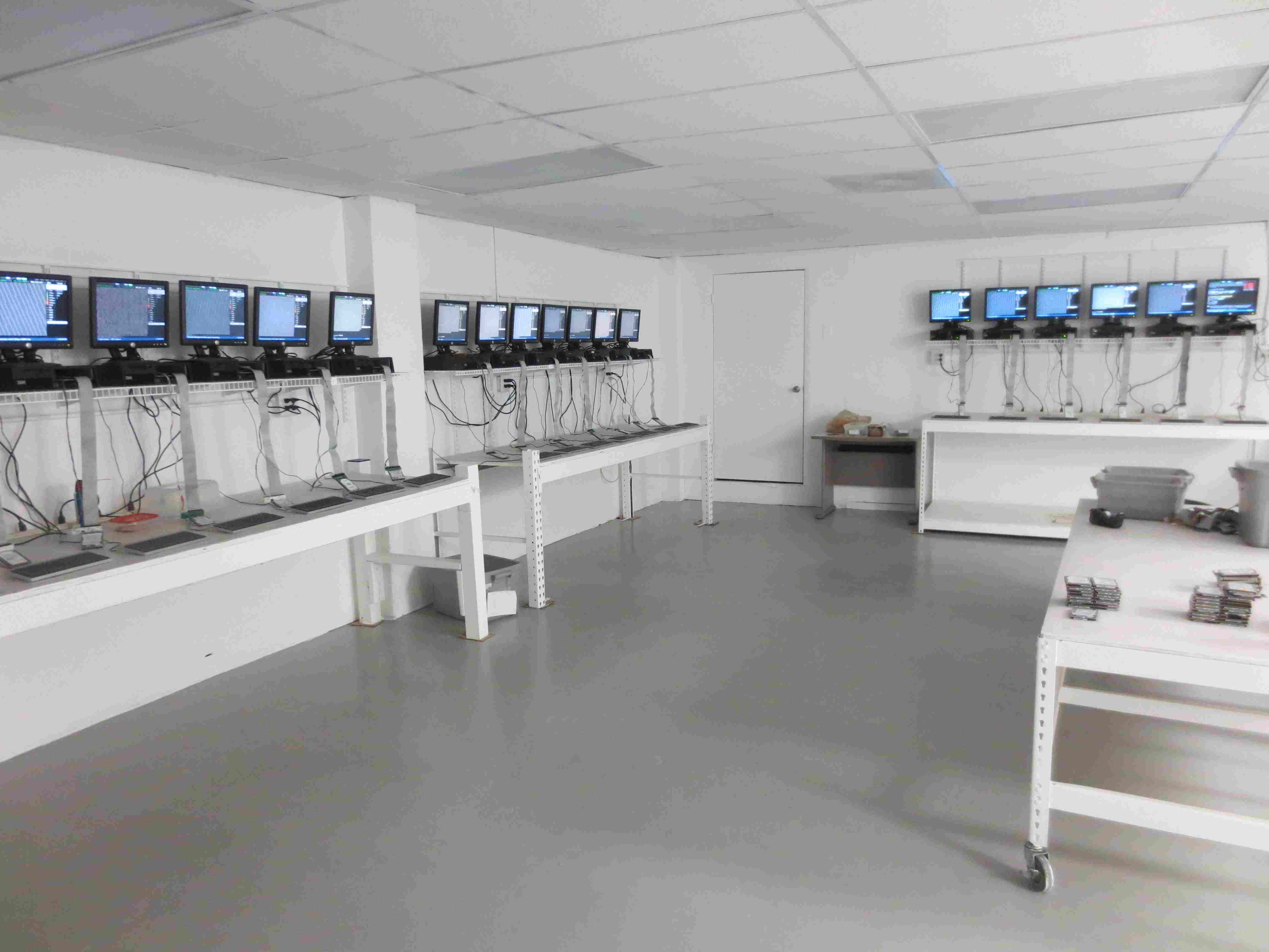

Hi everyone.
Its been 8 years.
Just moved the test room and upgraded the test beds.
Now using IBM P4's.
But still using MHDD.
Low flying aircraft the sound of freedom.

MHDD has been great. Hands down.
Is that the same room though?
Edit: never mind, seems like not. Thought you said "moved the stuff in the test room.."

Labtech
Its a new room to expand the amount of test beds. "30 or more"
We used that other room for 8 years.
Just shows how good MHDD is.
New room new test beds good old MHDD.

20+ Stations and not even a Single chair?
heheh

In the picture you can see a white table.
There will be a chair there for the tester to remove the caddies from the drives.
With 30+ test beds there won’t be much time to sit.
Just a little side note.
