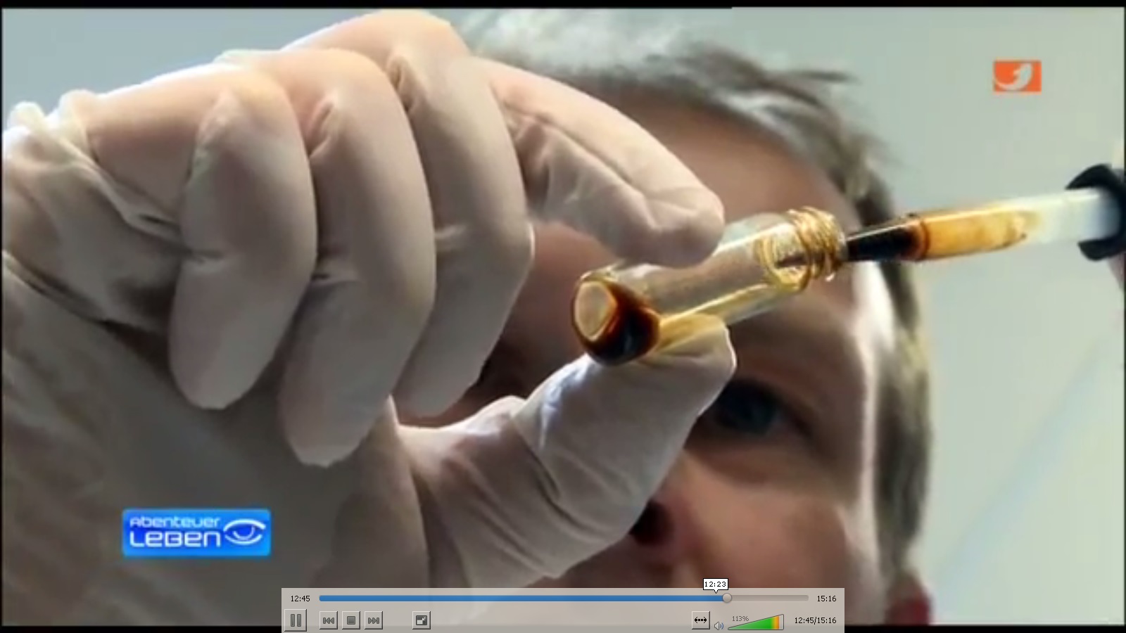

This is youtube video which shows ontrack technician applying 2 different chemicals on platters & all degraded media was cleaned.
Unfortunately youtube has blocked this video
https://www.youtube.com/watch?v=fGyzD7v ... Iw&index=4
If someone could find elsewhere. I am bit reluctant to upload because of possible infringement.
 Post subject: Re: DriveSavers Unrecoverable?
PostPosted: August 29th, 2014, 12:34
No amount of ANY chemical will fix a physically engraved surface. If it was. it was just dirt (contamination) i.e. from disk immersed in water after flood. DON'T confuse things.

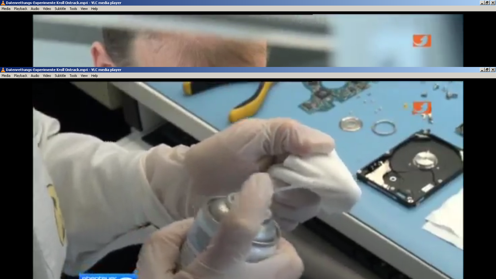

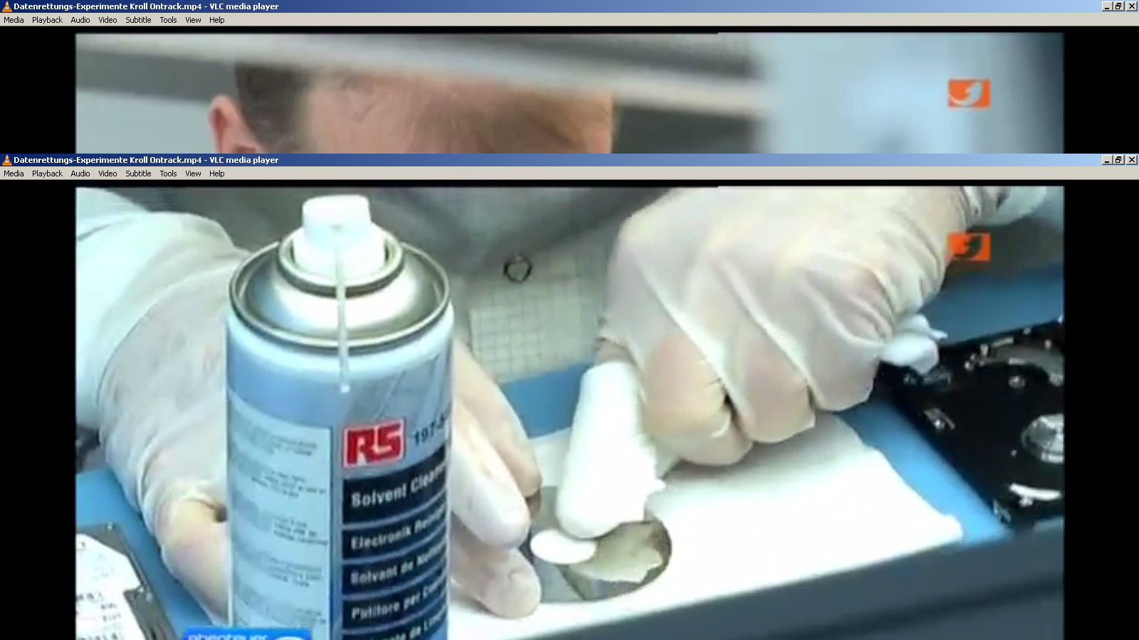

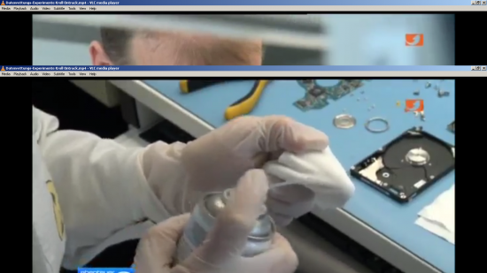

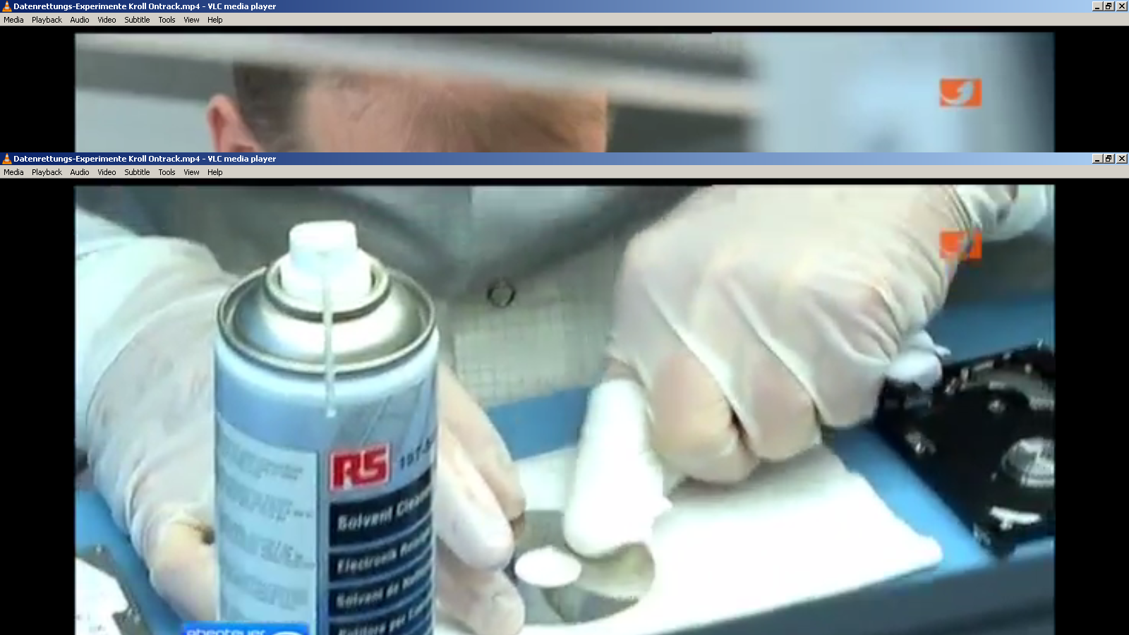

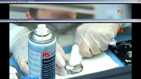

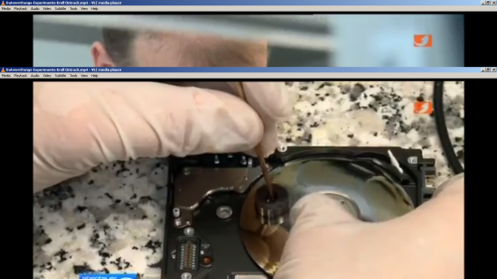

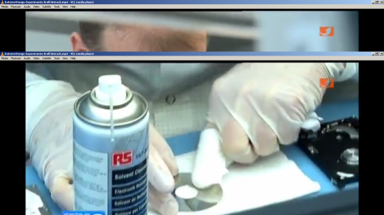

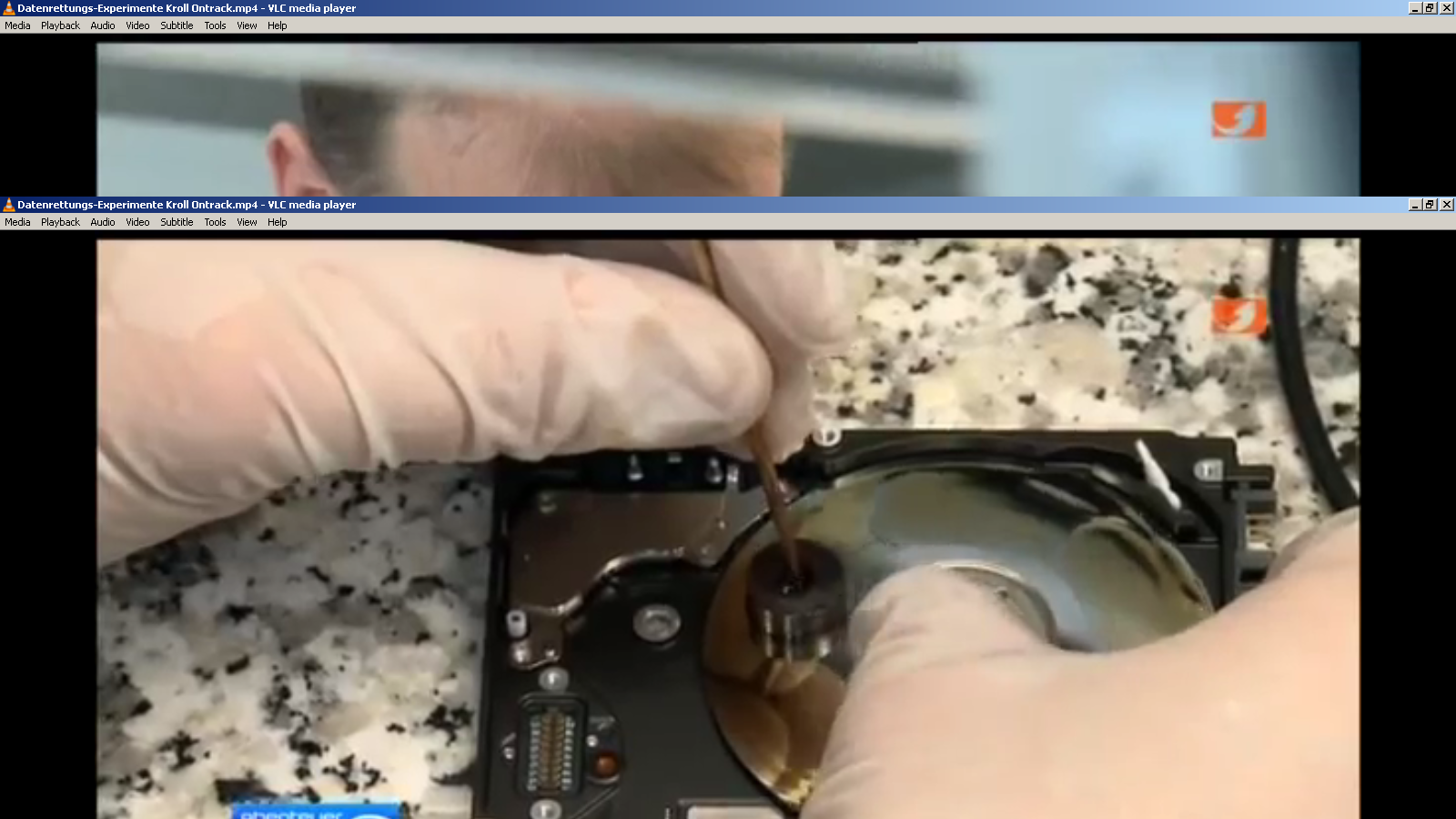

BlakST Here are some pics for you. ----------------
PostPosted: September 3rd, 2014, 11:01
Posts: 511
Location: Austin, TX
That fluid is used to see media corruption lines. It is a ferra fluid mixture. The room they work is designated as the "clean room" but the entire room is not clean. They do have Clean benches they work under.
In the pics I only see a can of simple RS solvent cleaner, what's the "extraordinary" ?
About the FERROFLUID (not "ferra fluid") it is of no use for REPAIRING a damaged surface. It COULD be used (years ago) for analysis (and you need "something else" also) when you had 1 bit every km. of track length, not today (except for educational purpose or rough analysis that will be quite useless for recovery purpose, if so).
Those days are gone, unless you get some 240 MB disk for recovery or you want to see how servo marks are :mrgreen:

oops ! something left from BlackST's clever eyes too . :o
Here is ontrack enginner is applying there proprietory magic solution.

BlackST wrote:
Sorry for the typo.. It was not used in repair of the drive, just to determine media corruption. It was a final check after all repairs have failed to work. You could see if data lines were written through the servo lines. under a microscope of course.
That is what they thaught me when i was working for them, and i have used that stuff before there. But yes it was for drives that were old, but this was also over 13 years that i worked there.
