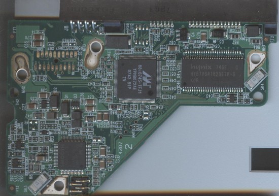

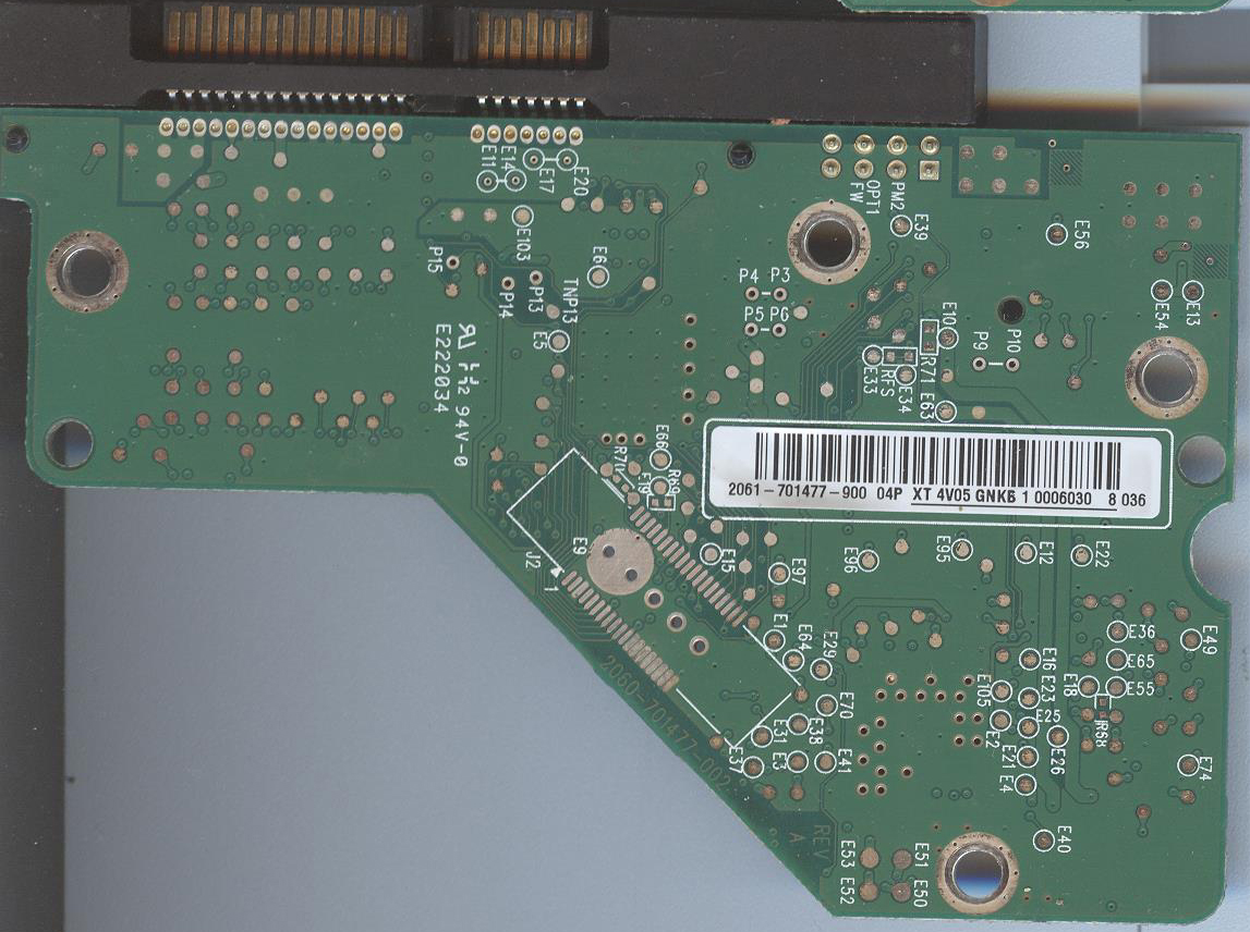

Drive (WD5000AAKS-00TYA0) behavior is the same, connecting for 5 sec, then disconnects and reconnects again for another 5 sec, a reboot loop. I saw all the data inside but i havent time(5 sec) to do anything with them..
I think PCB has a defect, looking for a overheating component but i dont see any..
Under a microscope, all seems ok, except a little oxidization at preamp and VCM contacts and on other side at JTAG contacts. I use eraser to clean them up and now are brand new..but nothing changed..
PCB etched number is 2060-701477-002 REV. A
PCB sticker number is 2061-701477-900 04P

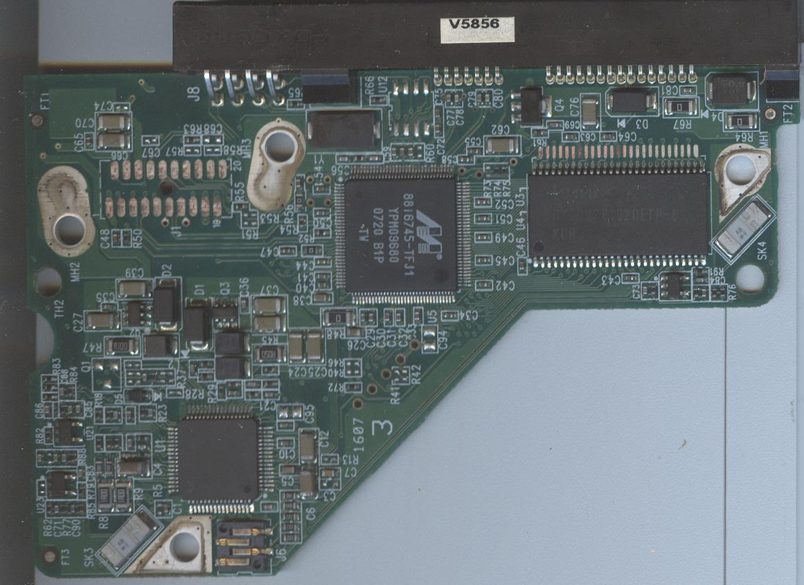

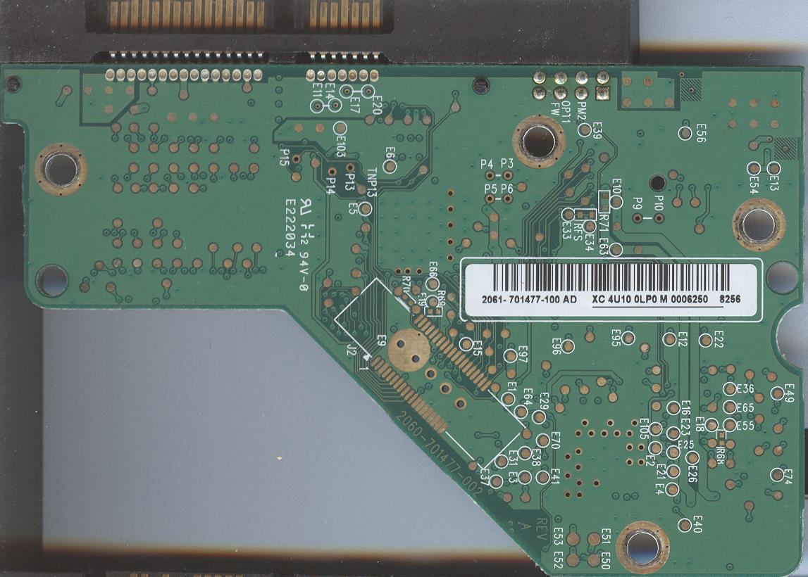

I have another PCB from a WD3200AAJS with numbers:
PCB etched number is 2060-701477-002 REV. A (SAME)
PCB sticker number is 2061-701477-100 AD (NOT EXACTLY THE SAME)
Side by side is EXACTLY the same PCB, can i use it for a MCU transfer from original PCB to DONOR?
I have experience in micro soldering, hot air station and a WD Doctor from SD.
Any ideas?

Hello DataPlanet
Can the DRAM memory chip be the cause?
Drive is:
WD5000AAKS-00TMA0
25 JUL 2007
HHNCNV2AHB
Thailand
I'm thinking:
A)Replace the HY57V281620ETP on the patient PCB
B)Use as donor the second PCB from 3200AAJS, tranfer MCU and a new DRAM chip(this PCB have a HY57V641620ETP, a 64Mbit chip, not 128Mbit as the patient)
Is that right/safe?

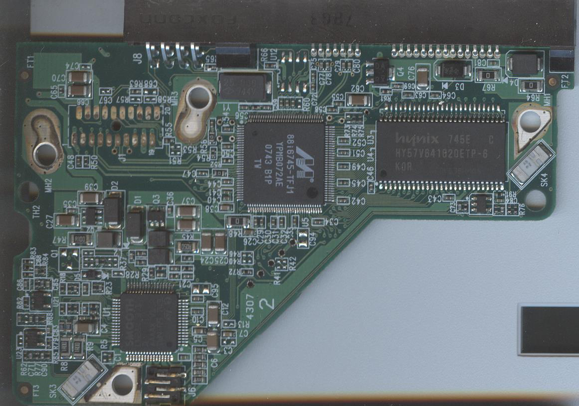

 Post subject: Re: WD5000AAKS disconnects and reconnects constantly in Wind
PostPosted: October 6th, 2014, 12:52
Joined: October 7th, 2008, 11:26
Posts: 37
5000AAKS(patient) PCB and 3200AAJS(donor?) PCB:
U12 not present, ROM is inside Marvell.
Transfer MCU or reprogram it?
Do you know if DRAM must be changed too?
PostPosted: October 6th, 2014, 13:57
Should be a suitable donor. Just read the ROM from the patient and write it to the donor. Remember to backup the donor ROM first.
PostPosted: October 6th, 2014, 14:05
Posts: 37
Thanks for quick response!
So steps are:
1)Read patient ROM(backup)
2)Read donor ROM(backup)
3)Write patience ROM to DONOR
4)Transfer pcb from donor to patient
5)power up patient
Firmware modules? ONLY ROM must be written?
Patient has 16MB CACHE, donor 8MB, leave DRAM ic as is?
PostPosted: October 6th, 2014, 18:58
Only ROM resides on the PCB. Modules are in the service area on the platters.
Just out of curiosity, have you ruled out the really easy stupid things like a bad power connector or SATA cable? I've had drives act that way from something as simple as that. Could even be underpowering it, I've had a few docks that weren't providing enough power to spin up certain models.
