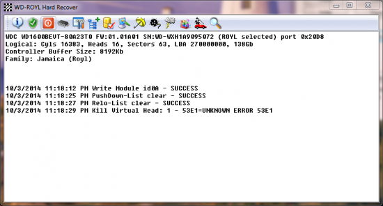

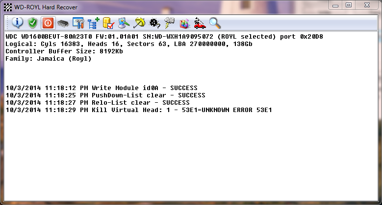

hello freinds can any one please tell me what is the actual problem i am add screen shot

Jamaica hard disk has 2 Heads and capacity is 320 GB, this is original settings.
In your case
Your hdd is 160GB, it means it was working only on single heads.
And there is no way to cut head if the drive is working only on one head.
Try see head map to get details of working heads

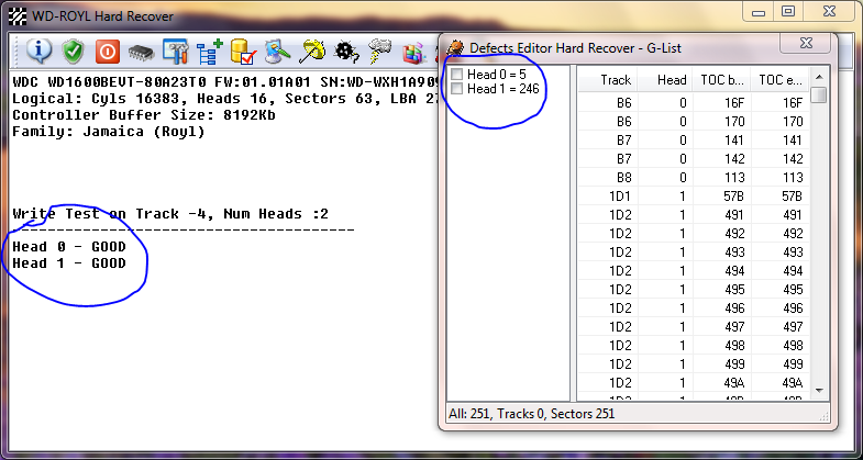

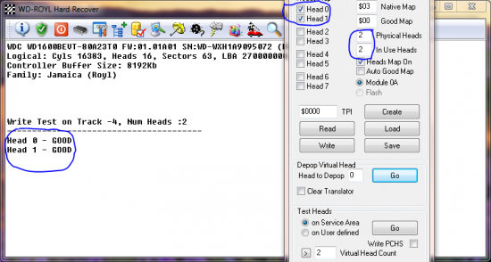

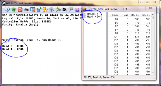

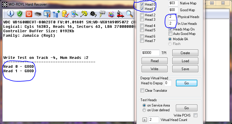

Thank you mr waqas ali for your reply in my case see more pic the drive have 2 heads and capacity is 160 gb see this screenshots

 Post subject: Re: heelo experts can any know what is the problem ?
PostPosted: October 8th, 2014, 22:21
Posts: 3598
Location: Chicago
53E1 is a servo error associated with a wedge, which does not make much sense in this case. I suspect that software you use simple does not work correctly.
You may want to ask tech support of this software.

this hdd capacity was reduced after ARCO. Refurbish hard disk.
Mr.Doomer was correct. error in software.
